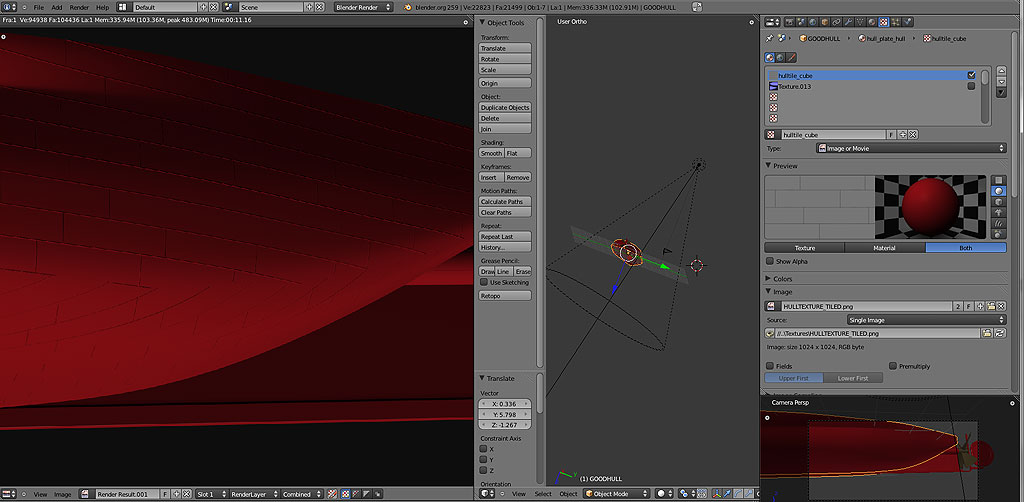

Dosen't look like much progress, but the textures are done, the hull plating is done and I've up-graded the lifeboats.
All I've got to do is properly rig the boats and the anchors and ready to render!

What did you end up using for the hull plating textures? Did you make your own or did you use something else?

The hull plating took a few turns and winds on the way. I started out using a tiled texture originally, and it very nearly worked out, but when it went around the curves of the hull, it had some strange artifacts. At this point, I could have baked it off to a UV Map and done some adjusting in Photoshop, but I thought that getting all the curves right by hand would be a mess. I could take it all into Inkscape and re-trace it, but mehhh...
Then I actually put my 'real-3d' head on and tried to 'really' plate it. I got a rectangular plate, made it to scale for the hull plates, then applied an array modifier to 'extend' it across the length of the hull. Then I put the shrink-wrap modifier onto it so it stuck down to the hull. This nearly worked again, but when it went over the curve of the hull, it got very distorted as the shrinkwrap tried to bend the plates to fit over the multiple curves and angles of the hull-deck fillet. I could have re-plated the distorted bits and adjusted and fixed, but I had a sinking feeling that I would be still doing that till Christmas at least. The plan was, to the hit the competed shell with the solidify modifier, which would have given you actual hull plates. I really like the idea of this, and I might re-visit this method and try to refine it later (running a separate line of plates vertically along the sides of the hull to avoid distortion), but right now, I need to press on. I imagine that doing this sort of thing in an actual CAD app would be much easier :(
Eventually I UV Mapped it (which I kind of knew I'd wind up doing eventually). I separated the sides of the hull and the bottom and did a 'project from view' on each to get my UV map. Then it was off to Photoshop and create some hull panels. I created one line, and to make the others match, I just duplicated the layer with the line on it and moved it down a bit.

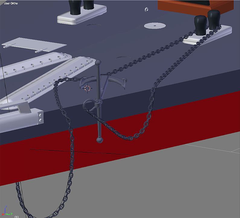

I followed this tut by Jonathan Williamson on how to create chains and the Tecumseh can now be secured at anchor!

Very cool!!!
I should also thank you for the explanations on your work, really helpful info. Even though my sponge of a brain doesn't suck up as much as it used too :smallsmile: , I either copy or bookmark these for future reference.
Dean
PS. Oh yeah, the chains look great...
