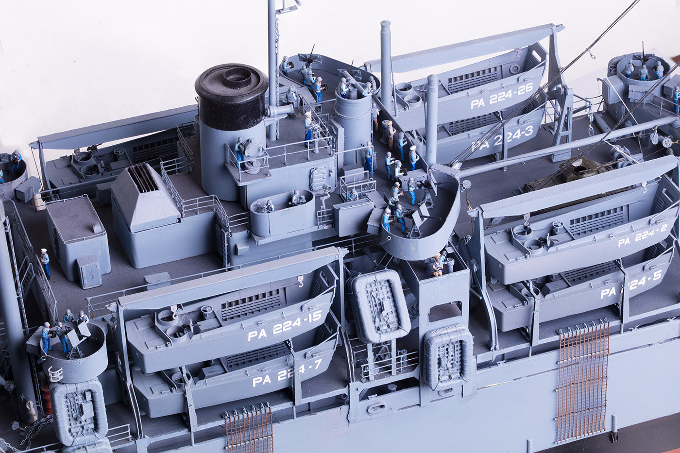

Midships bridge crew. The Carley floats are resin castings made from a hand made master. I actually prefer them a little to 3D made ones which seem a little too perfect. If I might rework something it might be the "Whelan" gravity davits which are made from Strathmore paper. However this would be a serious surgery so maybe more damage than improvement. If I was to do the upper decks again, I would detail the interior of the pilot house.

Tom!
It is very good motion of crew and ship detail.
I am happy to see your model.
Cheers Song
Cheers Song

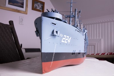

Bow of the Randall, APA 224. For those of you who haven't followed this project the hull is a traditional balsa strips over plywood framing except for center section from thin plywood over frames. Boat and superstructure decks from 1/16" plexiglass, Masts from Brass tube and uppers from turned aluminum, booms from wooden bowls, Gravity Davits, Strathmore paper wood beams and styrene, LCVP's 3D printed, LCM's and command boats carved basswood, all cargo vehicles, 3D printed, crew 3D printed, all deck weapons 3 D Printed, tubs and bulwarks, strathmore paper, all inclined ladders 3D printed.
This all reflects some changes in modeling technology, initially all the weapons and LCVP's were hand made.

Tom,
Looking quite excellent, as usual!! The crew is 1st class!!

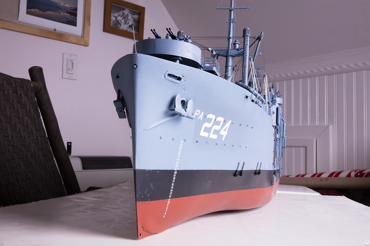

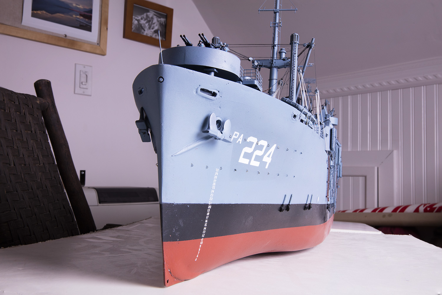

Randall from bow on. Maybe about the view one would have coming alongside in an LCVP. All lettering and number done using my stencil cutter (much like a Cricut). Hull is balsa strips over thin plywood ribs except for a plug amidships skinned with thin plywood.

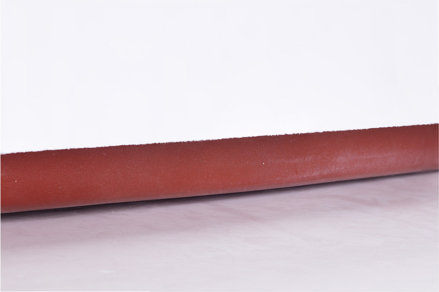

Didn't have bilge keels. Yes, floats, was actually powered model circa 1964.

It would be more useful for Mr P to present some evidence rather than make some comment out of his nether regions. In fact many large vessels do not have bilge keels, There have been many models made of Haskell transports and none I have seen have bilge keels (not a primary source) The profile in the BOGP show none, the hull lines show none and the dry dock photo of APA 227 do not indicate any though the turn of the bilge is in some shadow.
I did see one photo of an APA beached with mine damage that had a bilge keel, unlike one I had ever seen, looked very home made, perhaps instigated at the Captain's request during a yard period.
So notwithstanding conclusive evidence to the contrary It is MY INTERPRETATION that USS Randall, APA 224, did not have bilge keels.
Tom

I'm sorry you took David's question as an insult. I didn't. His first comment clearly assumed the ship has a bilge keel and you were waiting until the model was about finished to add it. And he clearly was surprised to learn that you thought the APA didn't have a bilge keel. I took his question "are you sure" as a request for more information. And I think he has clearly demonstrated proof to support his doubt about your model.
You can't tell if a vessel had a bilge keel or not from the station lines cross sections drawings because bilge keels and other things external to the hull (prop struts, boat booms, etc) sometimes aren't shown on these drawings (sometimes bilge keels are). The best bet is either to have a photo or blueprint for the ship showing the location or construction of a bilge keel (proof it had a bilge keel) or drydock photos showing the absence of a bilge keel (proof it didn't have a bilge keel). Otherwise you can't be sure.
Personally, I found the discussion enlightening. I have assumed large ships would have a bilge keel because of the stabilization they provided to dampen rolling. But assumptions are always subject to question and doubt. And perhaps because I am susceptible to motion sickness, and was nauseous a large part of my time in the Navy, I always hope that a ship has some feature for roll stabilization!
I can see that they might be absent for two reasons:
1. They generally do not protrude beyond the side of the ship at the waterline. But if the vessel is flat bottomed and flat sided, like the APA, there really isn't room to fit much of a bilge keel.
2. A flat bottomed vessel with a very sharp turn of the bilge will have a natural resistance to rolling. Because of the amount of water that must be displaced as the flat sides, bottom and turn of the bilge rotate around the longitudinal axis there will be a lot more resistance to rolling than in more round bottomed ships - where you usually see a bilge keel. So flat bottomed vessels probably don't need a bilge keel - barges typically don't have them.
However, the Iowa class battleship had flat bottoms, vertical sides and sharp radius turns of the bilge, and I have seen drawings showing bilge keels on these ships, and photo NY1-5237 7-27-51 of the Iowa in drydock clearly shows the bilge keel. And roll dampening is important for aiming and firing big guns, which transports don't have. So flat bottomed vessels may have bilge keels.
And, as David's photos show, flat bottomed transports may have bilge keels.
As for the Revell model I suspect they used their existing liberty ship hull for the APA (according to Wikipedia, the ultimate source of knowledge (right and wrong) the APAs were built on liberty ship hulls. However, the plastic models of the mid 20th century were often far from accurate! So did liberty ships have bilge keels?
One misconception about bilge keels is that they ran fore and aft parallel to the ship centerline. This is not necessarily true. They ran parallel to the flow of water around the hull, and this was not a straight line on most ships but was a complex curve.
