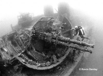

Rick E Davis wrote:Some of the Repeat BENSON-GLEAVES units with a quad 1.1-in mount (on the starboard side) and a single 20-mm in the other "tub" (portside)
How late in the war did ships keep the quad 1.1's before being replaced by Bofors? Did any 1.1's see out the war?
If I am not mistaken DD483 USS Aaron Ward had the same / similar setup as photo in above post, and then after her punch up on night 13th Nov. 1942 went back stateside and was fitted with two twin Bofors which of course she carried when sunk on April 7th 1943, as can be seen in attached photos. Photo #1 was taken in mid/late 90's - several years before #2 and #3 (2001 if I recall) - and shows them still upright. I believe they are now both either laying on her deck, or laying on the seabed. Time takes its toll!

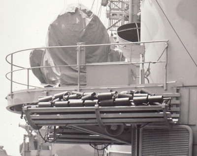

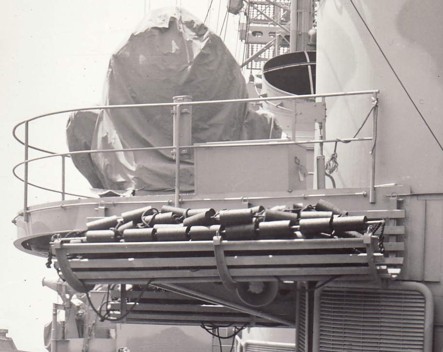

No, as I said there was a back and forth about the use of the baskets in mid-late 1942 into early 1943. The first Federal-built FLETCHERS (DD-445, 446, 447, and 448) were fitted with floater net baskets made with wood slats by the NYNY installed at least fore and aft on the searchlight platform. The next Federal-built unit (DD-465) now with the lower 40-mm installation between 53 and 54 mounts also had them installed, but subsequent units didn't until the dispute was resolved. Meanwhile, the initial BIW-built unit (DD-449) was fitted out WITHOUT floater net baskets on the searchlight platform, but had them along the 01 deck level in a few places. The next few BIW-built units appear to not have them. But, close-up photos in the South Pacific show they used floater net "bundles" along the main and 01 deck railings. In many photos it is real hard to spot floater net bundles.
By sometime in early 1943, the use of metal floater net baskets was common. Prior to that photos show almost twice as many raft floats being used than would be common later. (I have not tried to determine when the switch over happened and for some units it seems the ship's CO continued to use extra life rafts rather than install baskets)
For specific destroyers during specific periods of the war, study of photos is required.
