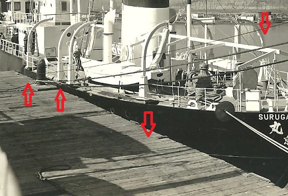

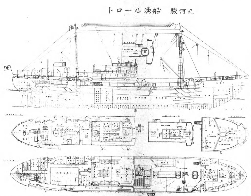

with the help of Ron Wolford's great photos of the Suruga Maru I have started to seriously work on the Niko Model. I want to depict it as prewar (Nippon Suisan K.K.) ship.
I have also seen now - also by comparing it to the drawing I found:
- that the spoon bow is far from being the only thing to correct on the Niko Model kit, for example there are a couple of gooseneck ventilators missing, the positions and types of many of the stairs and ladders is different, as well as many small other details which remain to add. At least the two-bar railings are correct for this ship.

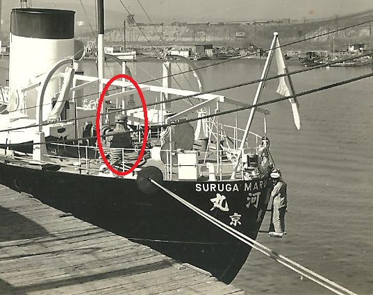

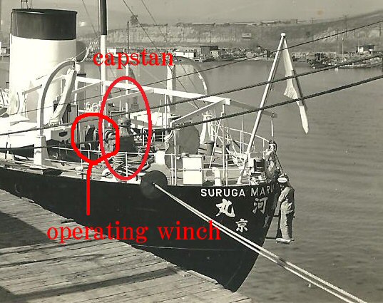

Three more questions for my Suruga Maru project:
1. Is this (? sorry, I do not know how it is called) available in 1/700?
2. Is this type of boat davits available in 1/700?

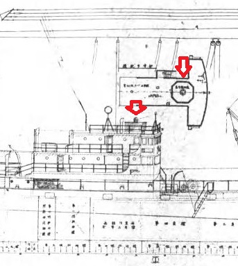

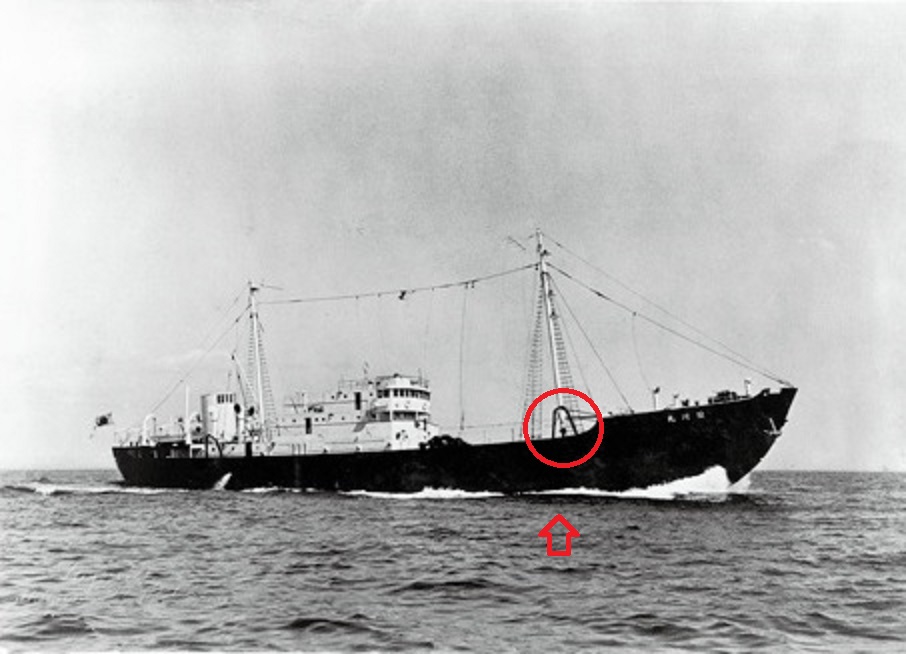

3. Can anybody tell me what this is?

Pic1 might be a compass binnacle, possible at an auxiliary steering position.
Ditto Pic 3, though this is a navigating position.
I think Tom's Merchant Set 796 has a few upon the fret. Also, one of the Waterline Consortium Ordinance sets has davits that are a very good match for the shape and cross-section.

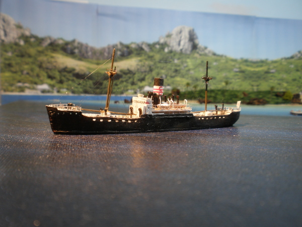

Shinkyo Maru had many sister ships (ONI-208J page 105) . I used the Fairy Kikaku kit of the Syotan Maru for the class. It took a bit of work but I made her the Nikkai Maru of Nissan Kisen.
Here's a picture
Nikkai Maru - Nissan Kisen

Thanks, Jim - a very nice model! And I can imagine the amount of work it took...

Still working (or planning) on my Suruga Maru.
In the meantime, I have exchanged a couple of e-mails with Motoyuki-san, who has been extremely helpful.
According to his opinion (and who am I to doubt it? :smallsmile: ) all decks would have been wood planking.

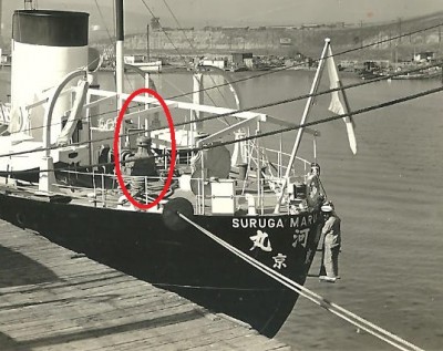

He wrote me that in Pic 3 you see, indeed, a compass in the navigating position, but that the "thingy" in Pic 1 is a capstan, with a winch behind:
Suruga Maru, 1938-40 in Long Beach CA (US), MW Ron Wolford detail 1 Motoyuki.jpg
For the boat davits, I think I can convert a couple of Fine Molds davits by remodeling the bases.
Does anybody know where I can find a 1/700 capstan like the one in the picture?

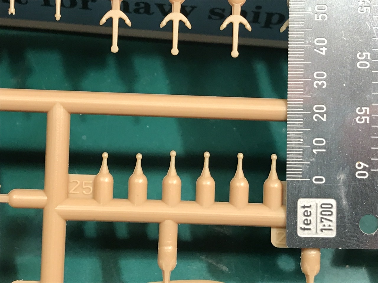

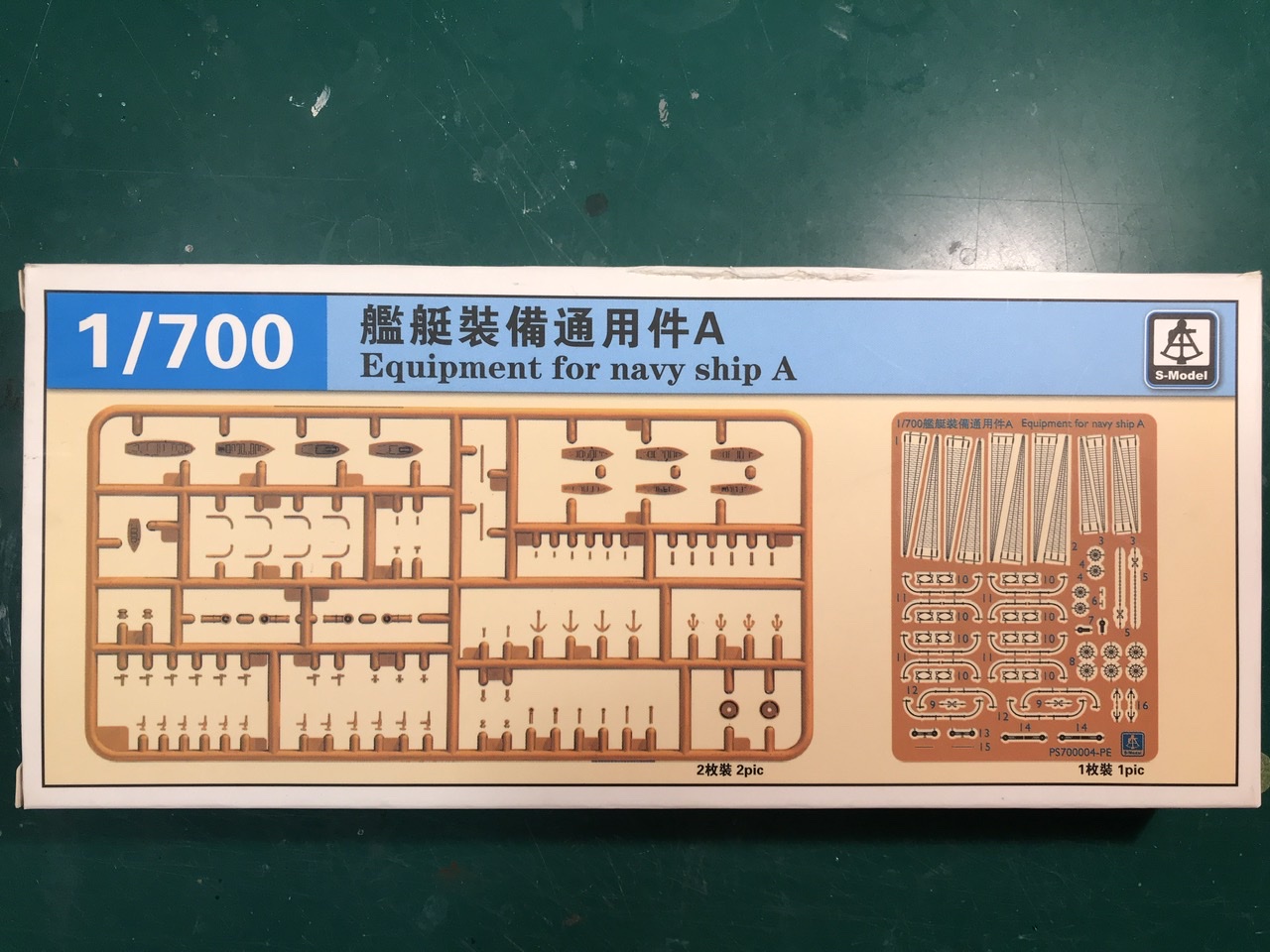

The capstan should be pretty easy to scratch build with a tapered rod and a blob of white glue. Just turn a straight piece of sprue in a drill or Dremel to get the shape you want.

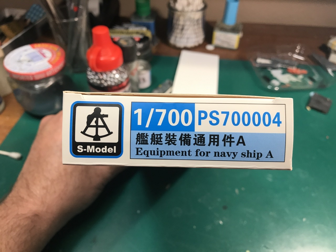

If you want something commercially available, S-models equipment set A has bits which may help. Not sure if they are actually capstans or DF finders, but they look pretty suitable.

You might even get by using the very tip of a toothpick which is pre-tappered, and easy to shape. Make 5 or 10 and use the one that turns out best.

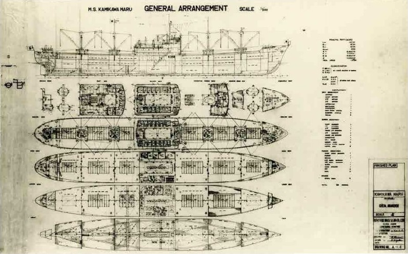

In a book on Kawasaki Kisen 100 years history which I have found online as a .pdf, there was the following general arrangement drawing of Kamikawa Maru:
Any idea where I can find this drawing in higher resolution?
Thanks and cheers,
Peter
PS: Motoyuki-san just informed me that this drawing is of the Kamikawa Maru II built after the war (in 1951).

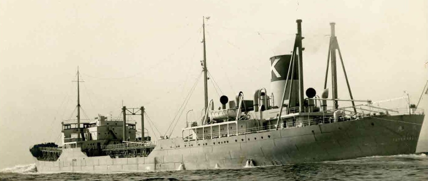

In both books I have also found this clearer version of a well known photo of Tatekawa Maru:
From this pic, it seems that the hull planking of the Fujimi kit is not all that exagerated, what do you think?

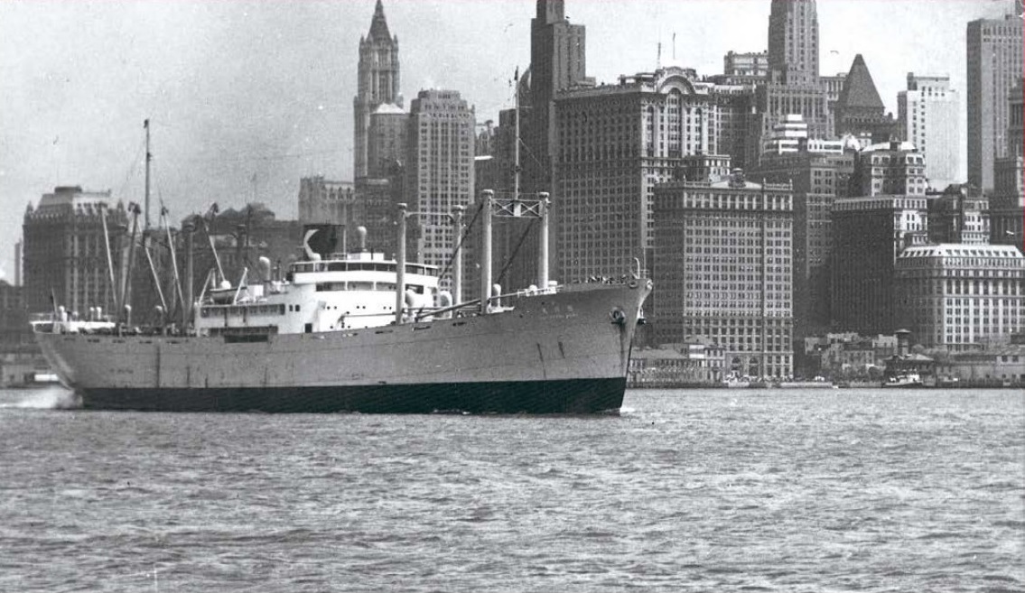

Also this photo of Kiyokawa Maru prewar:
Is this in San Francisco?

Great version of Tatekawa Maru. And thank you for the link.

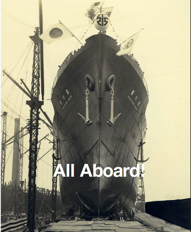

From the English version, Kunikawa awaiting her launch.
Kunikawa at launch, June 1937 - Voyaging thru Time, a Brief History of the K Line.jpg

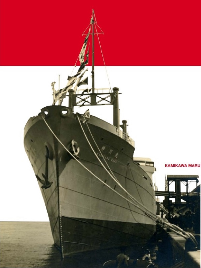

... and also the Kamikawa Maru.
