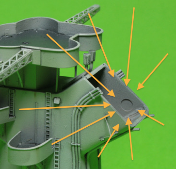

Bildschirmfoto 2015-09-06 um 12.49.44.png (191.2 KiB) Viewed 946 times
Deeply disappointed, infid�lement Daniel

marijn van gils
Posts: 2750
Re: 1/350 RICHELIEU Dakar 1940-41
Post by marijn van gils »
dafi wrote:It could be wonderful as always ...
... if you would have not missed an ejection mark!
Yes! And that awful overspray on the inside top of the bridge! :)
But I'm sure both will be covered from view by other pieces, no?
Good to see things slowly coming together now. It already looks beautiful now, and the result will be spectacular!

:sorry: no error is forgiven when one is surrounded by perfectionists full of talent :-D
I still have a lot to learn for to be on your levels :smallsmile:
Dan, I found something for to hide my unforgivable error .....a funnel top
hope this to be discreet :wink_1:
Marjin ,for the awful overspray on the inside top of the bridge.. my Richelieu goes entirely to the pickling ,and I redone my paint :smallsmile:
