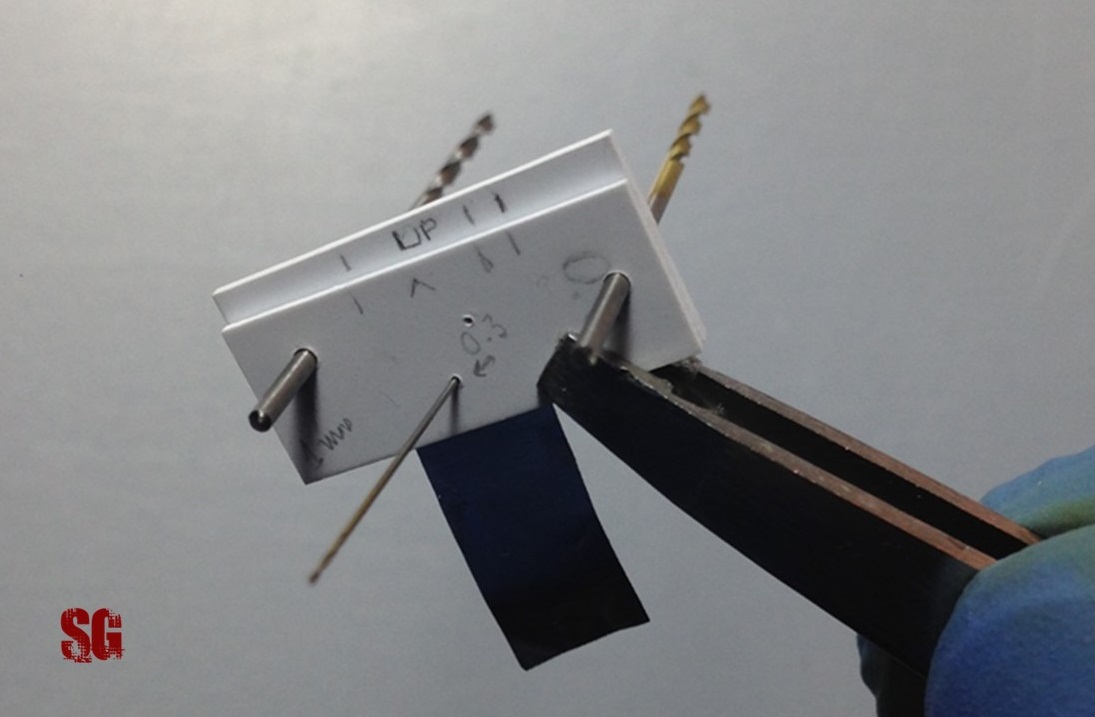

Incidentally, what punch & die set do you use? You mention 0.3mm; I have an RP-tools set that goes to only 0.5mm...

I don't know the brand name, and I don't think it is made or can be found anymore. I bought it in 1998 at Folkestone, I think from Historex Agents. I have never seen it again since. It has served me well over the years: pretty good quality, and that 0,3mm is super useful. That is probably the size I have used most.
I also have the RP-Tools. I think the quality is much better than the old one, so I use it for every other size. But I wish he would include a 0,3mm size. I saw him last weekend at SMC; I should have pushed for it! :big_grin:

marijn van gils wrote:I don't know the brand name, and I don't think it is made or can be found anymore. I bought it in 1998 at Folkestone, I think from Historex Agents. I have never seen it again since. It has served me well over the years: pretty good quality, and that 0,3mm is super useful. That is probably the size I have used most.
Possible the Historex set; I used to have it but I think it succumbed to rust... (or it is hidden somewhere?). I also used the Waldron set that has the worst method of storing the punches and a number of the punches were damaged/bent etc.. The RP Toolz version build quality is much better and the punches handle far better (though I have destroyed a few). A microset would indeed be useful! Not sure if they make the tools or import them? Their cutter is the same as the Sujiborido version, or... is that their Japanese name (They say designed and manufactured in the EU)? Did not try that cutter yet as it misses one key feature that the NorthWest variant has; clamps to hold your own cutting stops. Plus, you can rotate a few parts on their chopper that seems like a source of inaccuracy ... On the other hand, I'm trying to cut 0.1m wide strips and the NorthWest chopper is not up to the task; perhaps the slack in the hinger of the RP Toolz cutter is better... Could order one but if it doesn't work out: I already have an expensive paperweight (a DSPIAE circle cutter). Speaking of which, perhaps we can petition RPtoolz to also design and build the worlds first good circle cutter? :heh: Right, back to timbering the whaler...

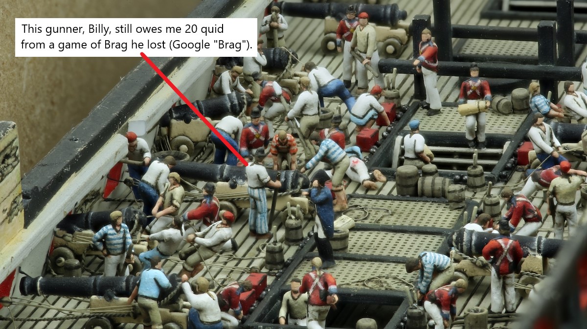

Upon closer inspection, I now know why. The crew are not models. They are real people, reduced in size through some dark magic known only to Marijn.
I want my 20 quid, Billy.

EJ i had built a field 0.3 punch & die out of thick plasticard and drillbits, for the alu pintles of my 1/400 88 mm gun mount. It worked well. Pretty cheap and basic, easily reproducible. It is only suitable for very thin aluminium and the thinnest brass shim which i guess is 0.02 mm: I wouldn't recommend it for thicker materials.

That's a great solution SG!
Evert-Jan, with your Proxxon mill, you could also make one from plexi and steel for more durability.
