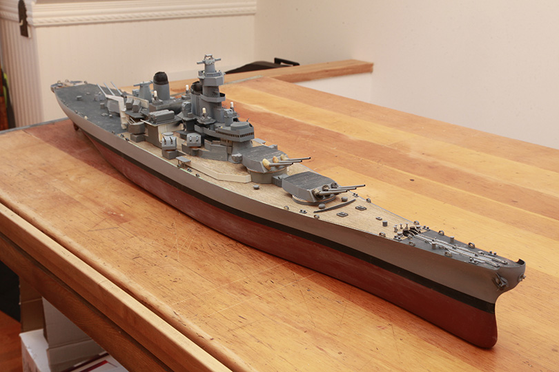

Very much a work in progress. I built this originally 50 years ago from the old Sterling kit. Some twenty years ago I started converting it to a modern Missouri but time being a short commodity I didnt get too far. I did remake the hull, adding skegs and inboard shafts, dual working rudders, reformed the bow and forefoot to it's proper bulbous configuration, hand planked the deck and essentially rebuilt the foundations for the whole superstructure. Turrets, both 16 and 5 inch are scratch as are the directors.
Much to do, add the bilge keels, outboard shafts, doors, hatches and portholes, railings and a lot of small detail from my photos. And Masts, and...and...and...

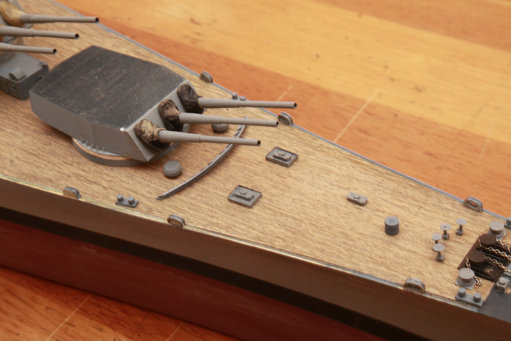

Turrets etc still a big WIP, but you get an idea of the hand planked deckin in 1:19

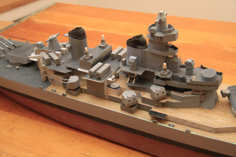

A couple of more photos of the model. From my photos on the ship a few more mods to make to the tower and midships structure.

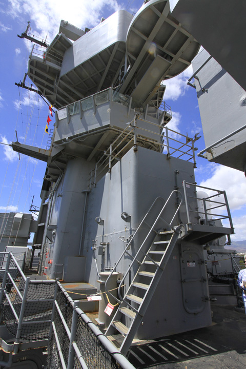

One small difference that you can see from the above photo of the ships port bidge wing is the position of the ladder to the top conning tower level. The ear that protrudes, which is where the plans showed the ladder, is not there anymore. The lower ladder to the admirals bridge has it's opening covered and is not there anymore. Wonder when that happened?

The converted Iowa's have a plethora of bracing to the various levels expanded on the "pagoda".
