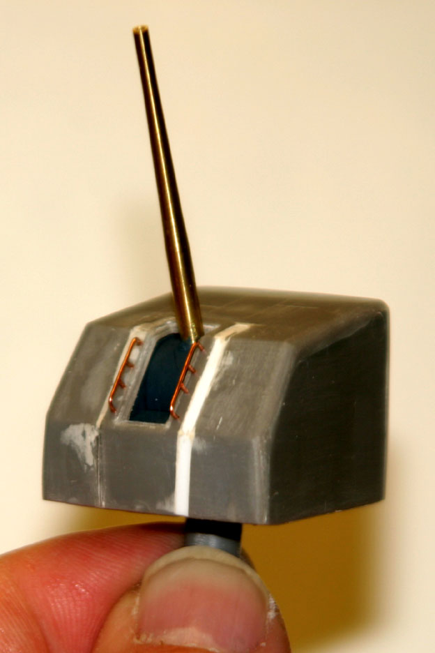

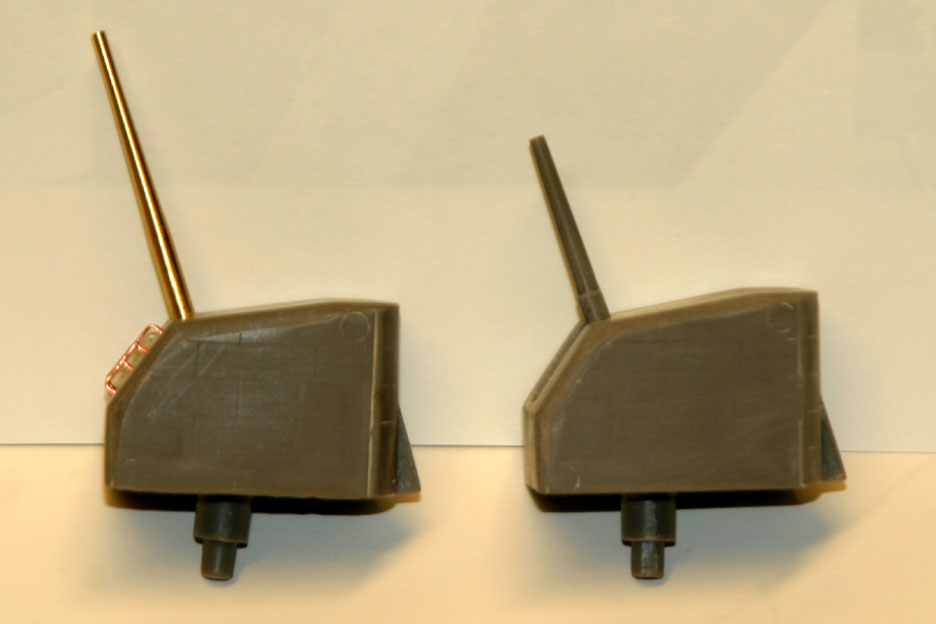

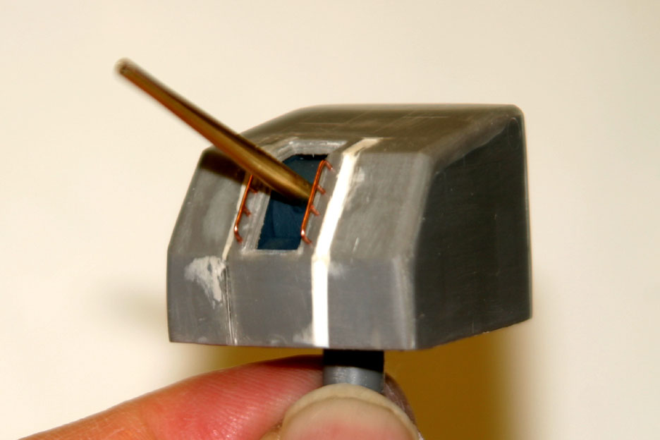

I am detailing my 5 inch gun housings for the Haggard. The hand rails I made on each side of the gun barrel are not exactly correct but they are finished and super glued on and I don�t want to fix them. Which turret looks the best? I don�t want to make any more mistakes. I have been looking at pictures of the first four Fletchers built at Sea Tac the Franks, Haggard, Hailey, and the Johnston. I do not see the blast shields on the 51 and 55 turrets on any of them. Also I can not see any ladders on the turrets.
The Haggard has its own web site that was created by the daughter of one of the crew and another crewman helped out as well. I found a great picture of the Haggard�s port side as a Chaplain was brought aboard on a bos'n's chair while underway. The picture shows the back of 51 turret and it has a ladder on the back port side. The question is, would it be safe to assume that all of the Haggards 5 inch gun turrets had the ladders on the back?
Thanks DD-555

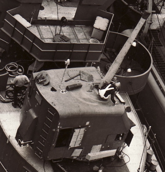

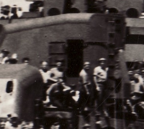

- Posts: 3880
Re: Calling all USS Fletcher class (DD) fans
DD-555,

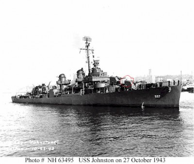

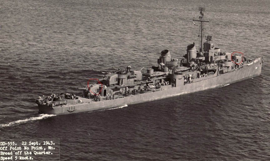

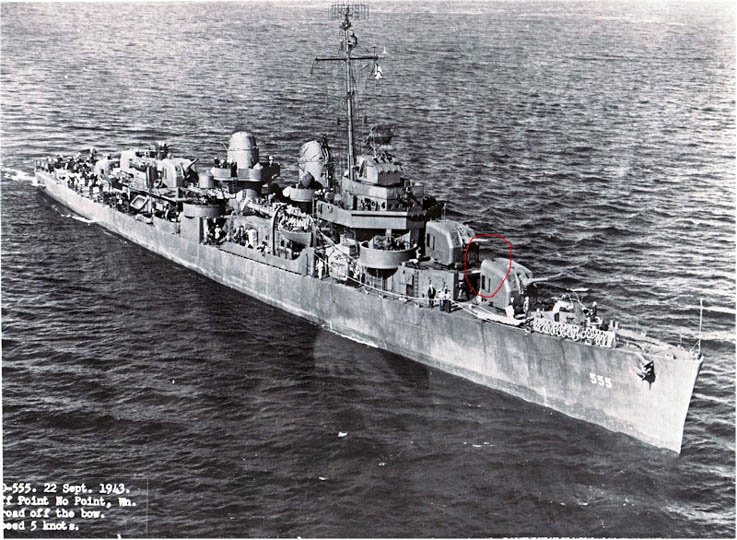

Yes I think it is safe to say that the ladders were on the backside of the 5-in gun mounts on SeaTac-built units.
In all the "completed" views of SeaTac FLETCHERS there are painted canvas "bloomers" on all of the mounts. However, I have seen photos of FLETCHERS where they didn't bother adding bloomers on the 53 mount since little water hit this mount. The canvas covers were difficult to keep "whole" on destroyers (they wore off or were burned off in firing, so you will find photos where one or more are gone or they were replaced onboard with plain canvas) and they tried several different styles and even sliding metal covers during the war. The rails weren't really hand rails, they were for attaching the canvas ... and if there was a standard for "how" they installed those I will be amazed.
Each Navy Yard did their best in coming up with the "perfect" bloomer and everyone "tried" their own design for doing so. Post-war they came up with a design that used air inflated bladders to fill the voids that could be inflated and deflated with movement of the gun to keep out the water that entered the space between the gun and the mount shield ... the whole reason for covers.
Below are images showing various views of the 5-in gun mounts on DD-554 during fitting out prior to bloomers added (first image), DD-555 as completed at PSNY (second and third image), and DD-556 in January 1945 (fourth image).
- Geno the Viking
- Posts: 79
- Joined: Sat Dec 10, 2011 6:36 pm
- Location: Everett, Washington
Fantastic photos, keep them coming.

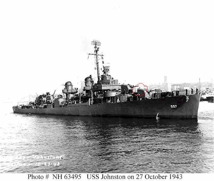

It�s good to know that there was no standard method for attaching the bloomers. I don�t know what type of cloth to use for them, but that will be one of the last thing I make for my Haggard.
What about the blast shield for the gun captains hatch? I don�t see them on the first four out of Sea Tac. Although, in the early 50's I have a picture of DD-556 possibly still in her late WWII configuration note the quad 40mm's and the blast shields were in place on 51 and 55 turret.

- Posts: 3880
The covers on the lower mounts (51 and 55 mounts) was a retrofit mod for many FLETCHERS. The only way to know when they were installed is to check photos. It is even hard to spot in Departure Reports because they many times listed it as an "OrdAlt" # and unless you can find/know which # was associated with it, it is a mystery. Anyway, I don't have many photos of these early SeaTac destroyers other than as completed in mid-1943 and as you say DD-554 through DD-557 don't have the 51 and 55 mounts mount commander cover. I have post-war photos showing the covers. DD-558 on appear to have the covers from completion. So "exactly" when the earlier units had the covers installed is unknown to me.

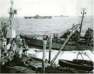

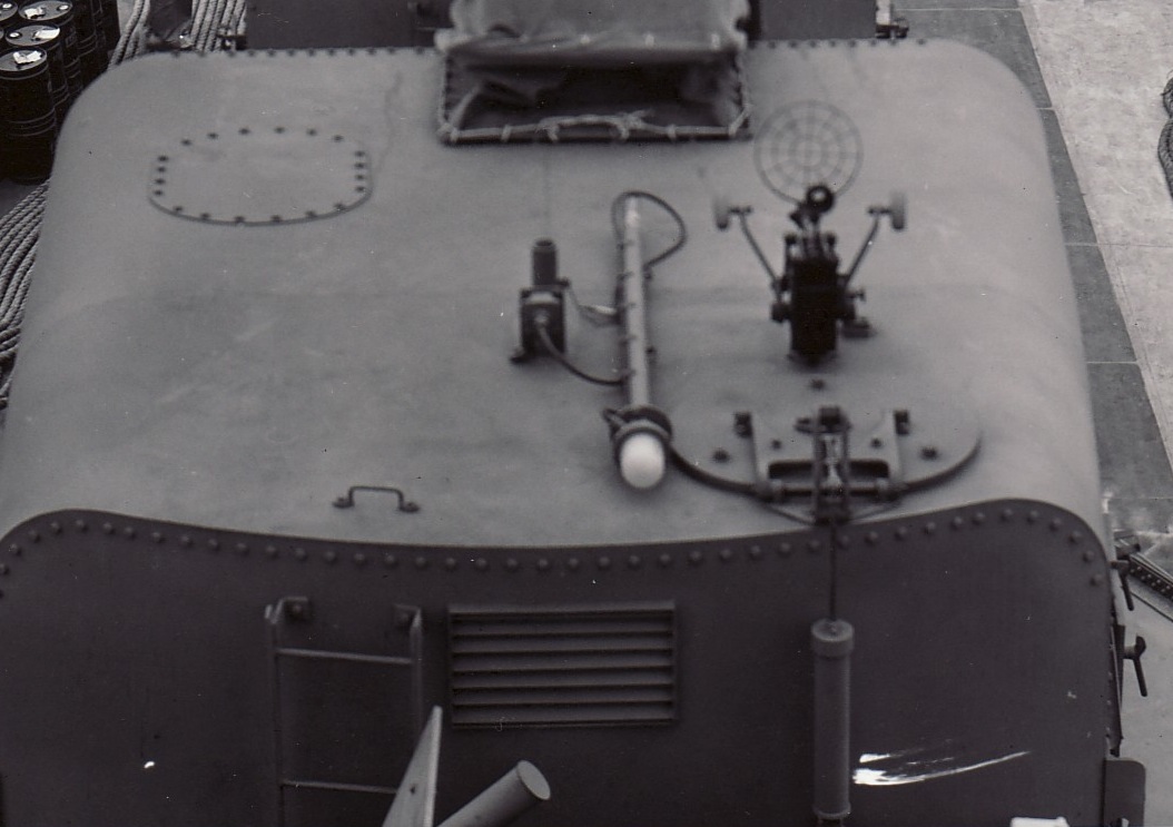

That's the Mount captain's open sight Mk 39
Rick may have something but what I've seen is usually a couple of lines on drawings of the mount. But HNSA comes through again:
http://www.hnsa.org/doc/fiveinchtwin/five512.htm
http://www.hnsa.org/doc/fiveinchtwin/five511.htm

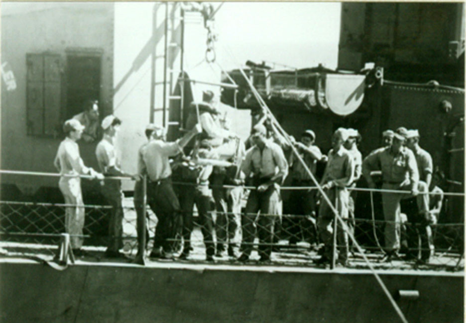

- Posts: 3880
Russ provided drawings of the sights. Finding good photos of these sights is difficult because of their size and because these could be and often were folded down for stowage.
Here is as good of an image I have ... on DD-546 BROWN, I don't have anything this close on the early SeaTac units ... also provides some close-up details of mount 52.
As for more close-up photos of HAGGARD, you either need to be more specific of what areas or you ned to PM/E-mail me for full size images.
- snaphappy321
- Posts: 371
- Joined: Sat Jan 21, 2012 5:43 pm
Hi Rick,
Very nice photo Thanks!!! I will PM you later to ask for a couple full size photos.
Thank You Very Much
Roger DD-555
