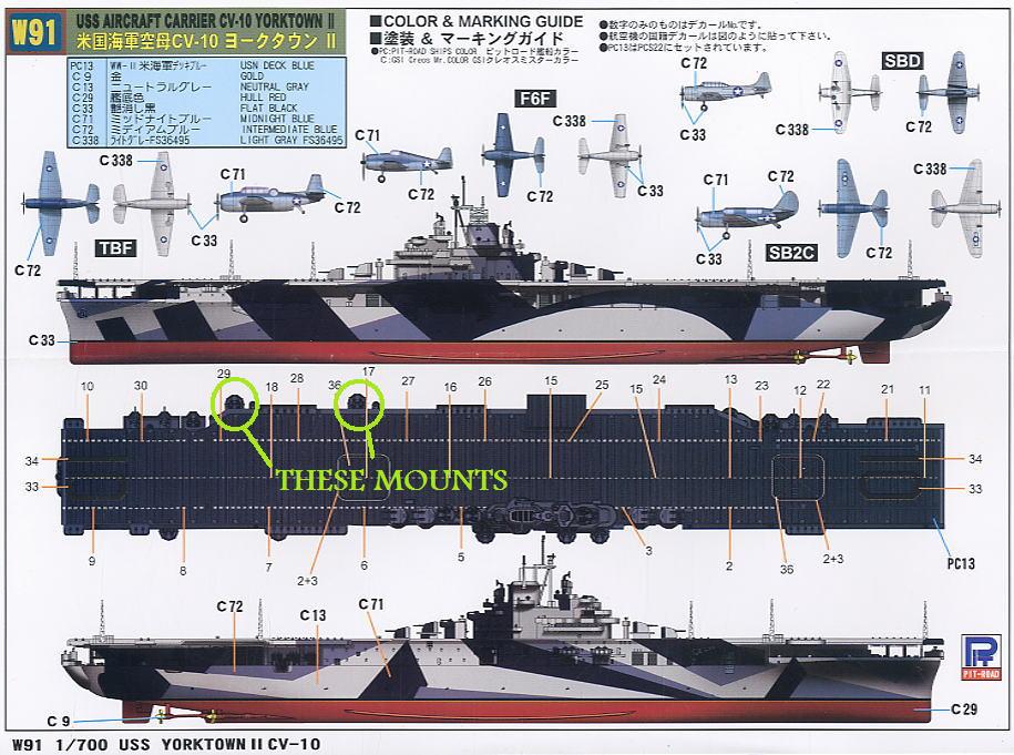

Can someone vouch this photo is time correct?
Yorktown Sept. 1944 location unknown
http://www.navsource.org/archives/02/021038.jpg
So were the tail port side flight deck quad 40 mounts installed before the 1944/1945 refit? Were these on the Yorktown when her planes took out the Yamato?
Tell me how screwed up I am on my kit... I'm doing the dazzle camoflauge and now I read Steve Larsen's work on the Yorktown.
I have the round bridge, the 2 port side tail guns, no hanger deck catapult, and no 2nd forward quad 40 on the Island. If I read everything right my ship is incorrect for any time period.
Please help so I can move onto another ship

That photo is dated September 30th, at the conclusion of her overhaul at Puget Sound.
I'm not sure what you mean by "tail guns"
She did have the dual quad 40mms on the stern during her April action. No hangar cat, two flight deck cats, quad 40mm forward of the bridge removed so the flag bridge could be enlarged.

Thanks for the reply... I feel like a pestTracy White wrote:That photo is dated September 30th, at the conclusion of her overhaul at Puget Sound.
Here's the mounts I mean:
So many models... So little time...
Adaks
- Posts: 142
- Joined: Thu Dec 08, 2005 8:37 am
Re: Calling all Essex Class Carrier Fans!
These two 40mm quads were on Yorktown from September 1944 refit to 1947 ((?) All the same, to the end of WW2 for sure ).Jeffcsr wrote:
CV-10 was 'in dazzle' in two different configurations:
1\May 1944-August 1944 - hangar cat, one flight deck cat, early island, 10 40mm quads.
2\September 1944-May 1945 (?) - no hangar cat, two flight deck cats, late island, 17 40mm quads total.
Radar fit was also different in these two periods.
If you built Yorktown in configuration from picture (2) you should also use only two first radio masts.

Thanks! I'll scratch build the late bridge and make sure I have the Aerials & radar right...
You guys have been a big help!
Tracy White
- Posts: 10632
- Location: EG48
That's what this section is for... if you have the question, odds are someone else will, and we'd rather only answer it ONCE!Jeffcsr wrote:Thanks for the reply... I feel like a pest
Those quad mounts were added in the fall '44 overhaul and are good to go for a 1945 Yorktown.
