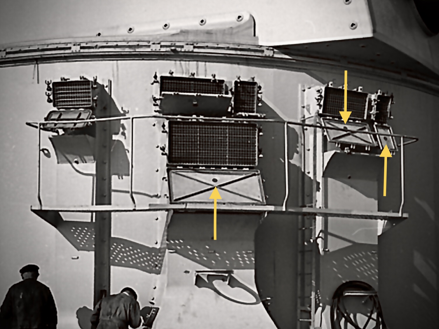

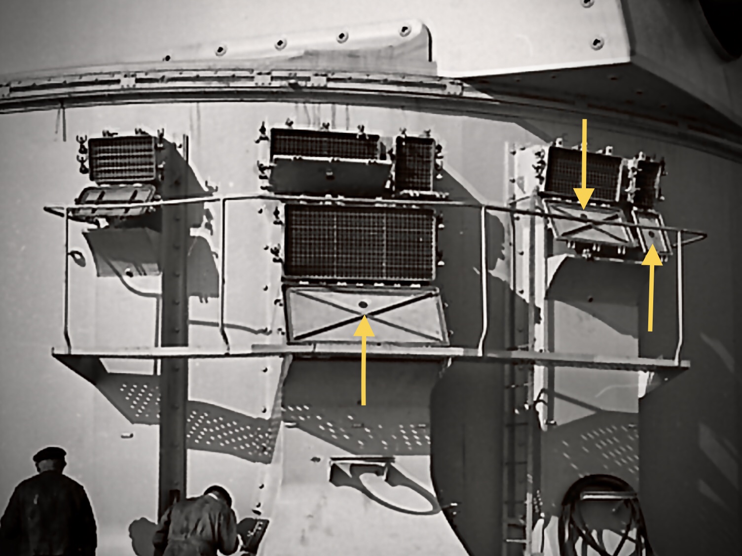

I�m working on the Takom 1/72 Bismarck Turm �Bruno� model (which is much nicer than their Hood equivalent), and have a detailing question. Hopefully someone out there may have some info regarding the vents which surrounded the barbette, specifically, the insides of the vent flaps/covers that were opened to allow fresh air below decks.
In the famous onboard photos from 1940 (I think) there are circular markings/spots on just about all of the covers. Does anyone have any idea as to what these were and what colour they are believed to have been?
Here�s a pic with the features indicated by arrows:

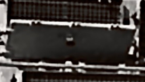

Are they not just holes, judging by the flap on the one above the centre? You can see the sunlit surface through it. That said, that dark spot under the bright might be a circular flap.

Timmy C wrote:Are they not just holes, judging by the flap on the one above the centre? You can see the sunlit surface through it. That said, that dark spot under the bright might be a circular flap.
I hadn�t noticed that before! Many thanks!

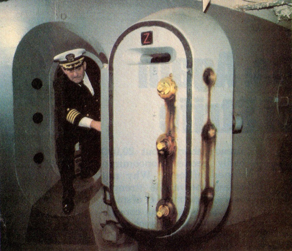

chuck wrote:On Bismarck�s wreck, the starboard armored door for the conning tower is open, while the port side door has been blown away from its hinges and disappeared. When the British performed ballistic tests against the Baden, Bismarck�s design predecessor, after WWI, they also observed that a shock from a hit elsewhere on the conning tower broke the door hinge and unseated the door, and thus the conning tower door hinge design was unsound.
My question is, sound or not, the conning tower door seems to be attached by simple hinges on the Bismarck. There is no evidence of any mechanism to assist in opening or closing the door, which was 15 inches thick and must weigh several tons. Is the crew expected to use muscle power to hold the door against the rolling motion of the ship or against any list the ship developed while operating the door?
On the Iowa, the conning down door hinge is actually attached to a beefy shaft that runs below deck, which implies there is some sort of geared or powered assist for operating the door.
There is definitely a power assist for opening the conning tower doors on the Iowa. It is on the O3 level for NJ, MO, and WI. The doors also can be opened with a hand crank. It takes a fair amount of cranking to manually drive the motor but it does not take a lot of torque to move the crank. The resistance in the system is such that the door would not fly around. The hinges do not hold the doors in place when they are closed. Three thick, steel bolts extend on one side and the doors have an extension on the hinge side that fits into a recess in the conning tower.
It sounds like that simple protection was not implemented on Baden and possibly Bismarck.

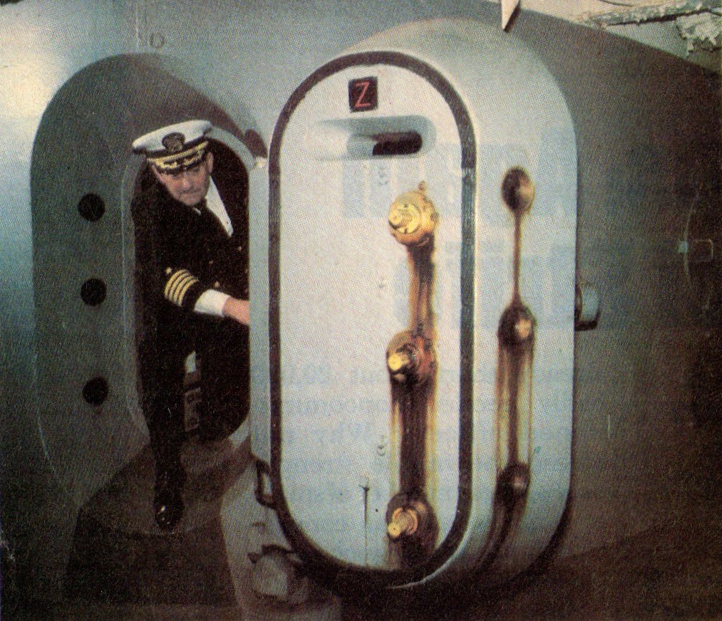

To illustrate Big Jim's description of the IOWA class armored doors, here is a photo of one of IOWA's 17" thick armored citadel doors in 1981 prior to her refit -
from U.S. News & World Report, 4 May 1981
When I did have watches on the bridge, I sometimes ventured into the conning tower (within the barbette) and made a mental note as to whether the doors were open...I certainly had no desire to get "locked" inside!!!

They are red dots
1 The black dot on the fan cover that appears here is a "red ball" and means that the lids marked in this way (also for bulleys) must be closed at "clear ship lock state" and "Schotten dicht".
Translated from Bismarck book by Josef Kaiser isbn 3938494018 page 32
The black dot refers to the b&w photo in the book.
