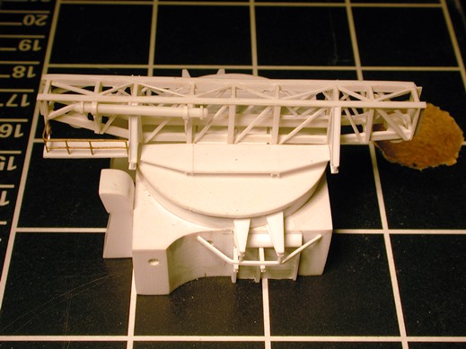

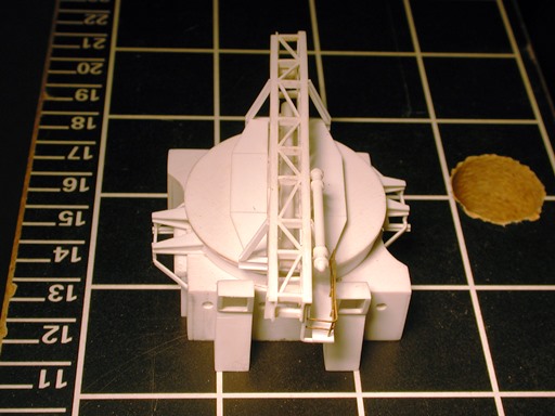

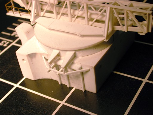

Things have slowed down a bit on the build for a variety of reasons, not the least of which is the pesky day job, but also because I�m starting to add detailing to some of the previously constructed superstructure blocks and that is presenting some difficulties. While the as-fitted drawings are very useful and have shown me many details and fittings I was previously unaware of, at times they pose more questions than they answer. The problems are exacerbated by the relative lack of close-up photographic coverage of the ship, at least that I have been able to find. A case in point is the torpedo parting space which I have been working on for the last few weeks.
The torpedo parting space is in a stand-alone piece of superstructure, located amidships between the two banks of torpedo tubes, that also serves as the base for the airplane catapult. With the torpedo tubes trained 90 degrees outwards, the torpedoes can be withdrawn from the breeches of the tubes and transported through roll-up shutters into the parting space with the aid of hoists, which are mounted on a system of overhead rails. At each side above the shutters is a frame work which supports the rails as they exit the parting space through the shutters. Both the Ough plans and the as-fitteds gave only the vaguest idea of how all this worked and Ough�s plan and elevation drawings were in conflict with each other.
As it happened however, in my quest for anything that could provide me information on Dorsetshire, I had discovered a book published during the war with the purpose of providing funds for a Dorsetshire replacement. The internet ad for the book stated that there were many photos and much information on the pre-war history of the ship. When the book finally arrived it turned out to be a very thin pamphlet indeed, with exactly one useful photo in it and most of the information being from a 1935-37 cruise book that I already owned. But the photo (shown below) did provide some much needed clues as to the torpedo hoist system, seen at the right behind the crew. It was possibly taken at the same time that this one was: Both photos were probably taken immediately after the Bismarck action and were meant to commemorate the men and weapons that were thought to have delivered the death blow to the German ship. I had also found this photo of the ship�s Walrus flying boat and catapult. The results of these photos, as applied to the model can be seen below:

I've pretty much run out of superlatives at this point...what you guys can do with some plastic card boggles the mind.
- JIM BAUMANN
- Posts: 5703
It all looks very very catapulty!!

Good I'm glad that catapult photo was put to outstanding use! tremendous scratchbuilding!

stunning, your catapult!!!
