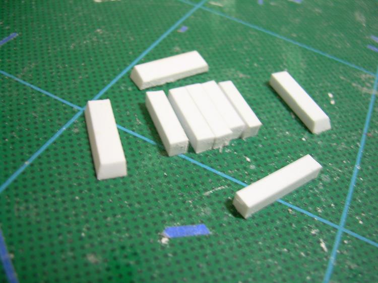

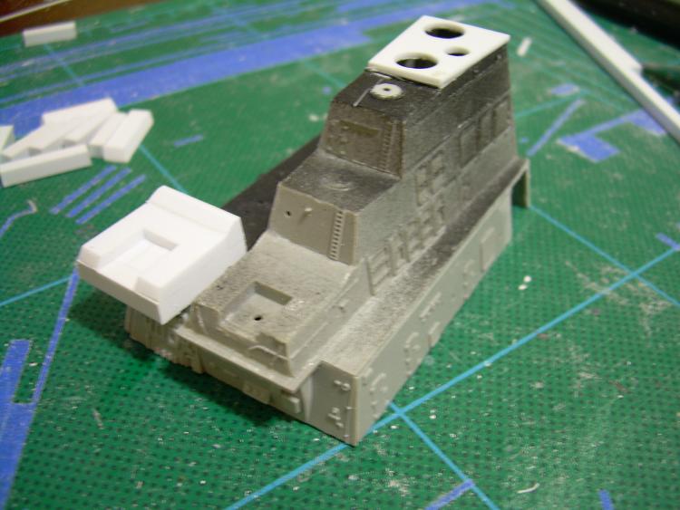

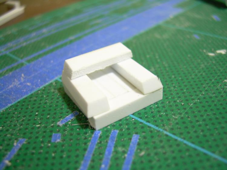

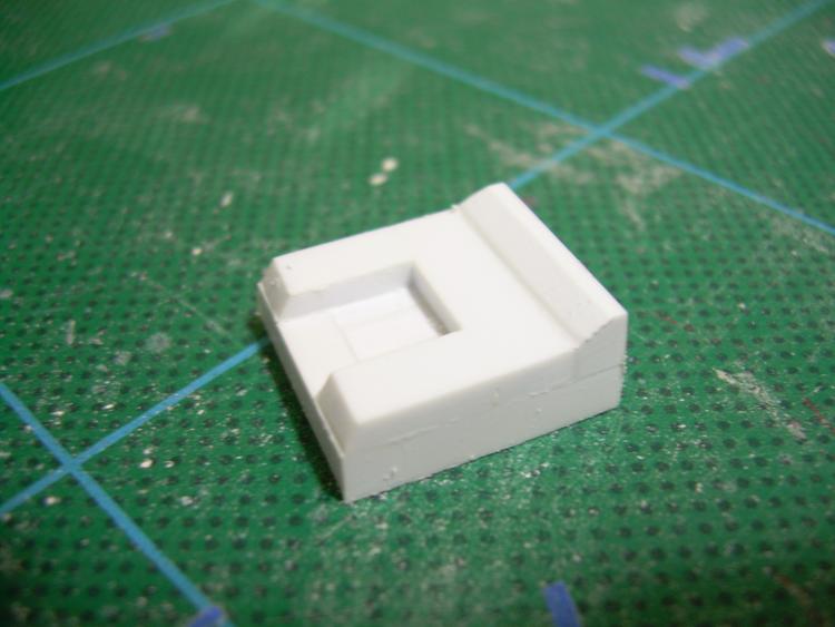

Bigdaddy Mark wrote:I haven't been able to find it in the kit, so I think I'm going to try my hand at scratch building.
If anyone has one I would appreciate if you could shoot me the dimensions.
Hey, Bigdaddy, first off, super mega awesome on dominating those badguys. Sucks about the fire, but you took it pretty well, man. I give you HUGE props on that one. Great job training Hit Girl! She really seems like she can handle herself. So, since you are such a total and serious bad@$$ the very, very least I can do for you is show you how I built up the Phalanx chairs. Like Timmy said, there are different versions of the Phalanx chairs. The ones I have on my Iowa and Spruance models are US Navy standard, kind of blocky, but the ones on the Burkes are set up to reduce radar cross section.
So, here's how I did it:
I first started off with square stock for the base and cut it to appropriate length and stacked them side-by-side. I cut to length thinner but wider rectangle stock for the arms and back of the chair. I individually sanded the sides of the arms at an angle.
I roughly placed them all (all but one piece here) together to make sure they are good.
Next I glued them all together with Testors liquid cement. I wound up using that because the blobby stuff is wonderful for gluing big parts, but gluing little stuff where glue between fingers and plastic makes molded-on fingerprints is not so hot.
I let the glue cure over night and did some uniform sanding to make the tiny corrections necessary to bring the angles together. I do it like this, because if you just wait until you're done to sand everything for the first time, one error and you have to do the whole thing over again. This way, you produce a far more reliable product.
As you can see here, the chair is very close to the kit piece.
I hope that helps out. I am going to be putting these "chairs" on my USS Momsen and USS Forrest Sherman.
