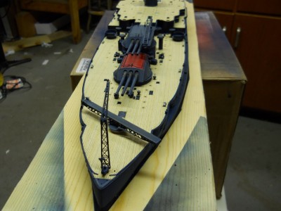

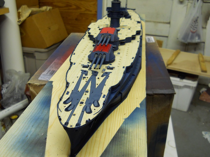

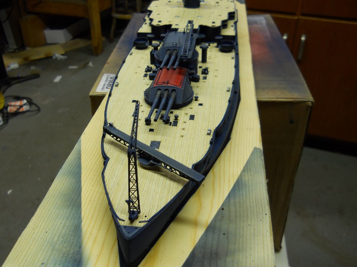

As promised, here's some update photos pertaining to the hull and the joining of the deck. Unfortunately, either due to a flaw in the kit's engineering or my own incompetence, the join between the deck and the hull is not flush all around; at the bow forward of and to just aft of the foremost breakwater, the deck goes in deeper than at other parts of the ship while at other points it seems to stand a bit proud of the intended installation point.
The following photos are of a mock-up of the hull with deck glued, the main, secondary and five of six QF AAA plus a couple of bits here and there as well as the unpainted mainmast and nearly-finished mast star and radar lantern, as well as the funnel which has been given a light wash:

Anyway, this is gonna be a strictly OOB build, and if I do any rigging at all, it'll be for the two cranes, the one on the mainmast and the one mounted to the deck forward and to port of the bridge structure. Frankly, I'm surprised Trumpeter didn't provide any sort of photo-etch for the mast crane, nor any rigging diagrams at all for that matter. Fortunately at this scale, such add-ons can be done with plain, fine-gauge wire from the hardware store, which I have in abundant supply. My kingdom for some high-build primer.

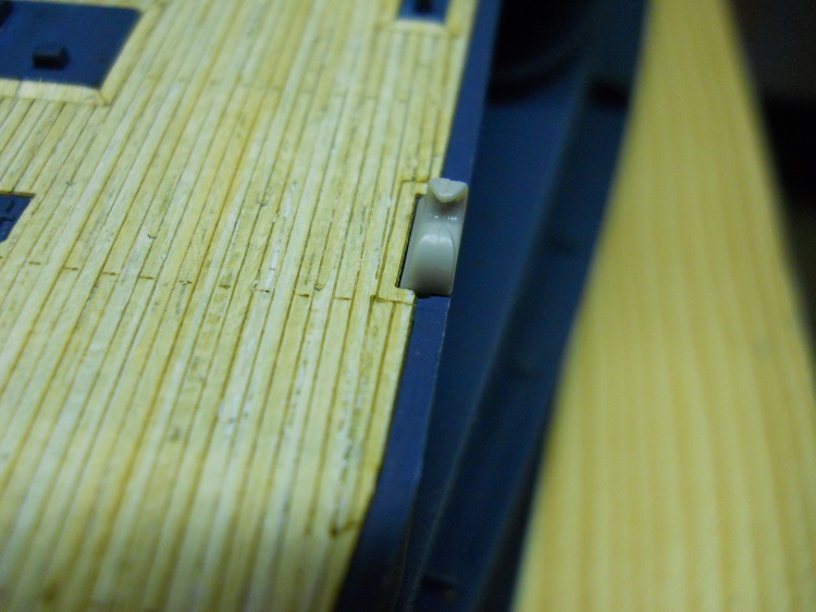

Okay everyone time for an update! At this point with the AZ, I'm doing a heap of subassemblies that really don't jump out at first. You know, the kind that when you ask your wife "how does it look"?? and she replies "It looks the same as it did 2 weeks ago when you asked me".. Then I proceed to show her the hose reels I spent a week on and the degaussing cables, etc..
So I'll start with the degaussing cables which are double plastic rod glued together (drying time implied). These run along inside the waterway--oh yeah, gotta add that too before the cables. They run under the fairleads which are raised to allow water to flow over the deck in heavy seas. On the Arizona, the fairleads are stylized; having a sloping side toward the keel line. The Texas/New York have a square channel which the fairlead is on top of. At 1/200 scale I didn't bother wither the sloping fairlead, but in 1/96th scale it should be there.

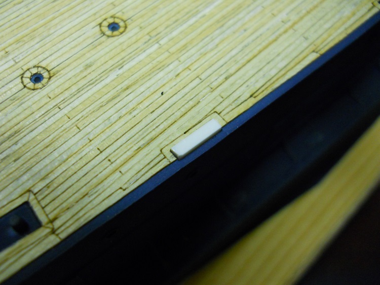

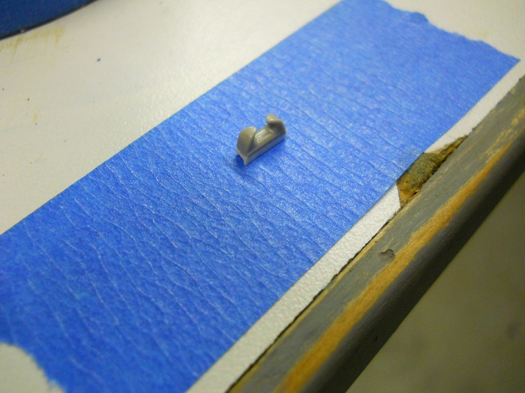

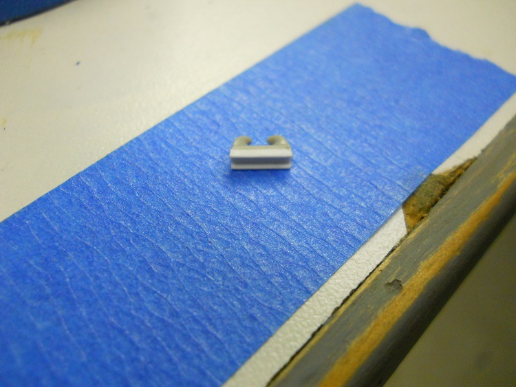

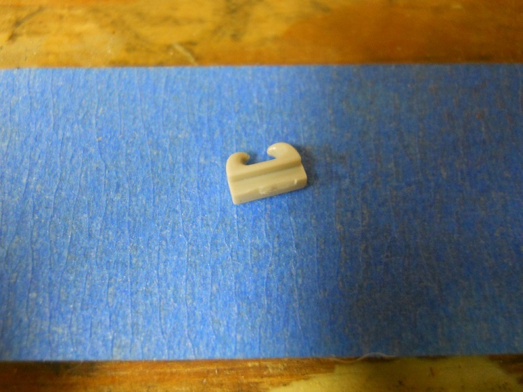

Trumpeter's fairleads have a tab which goes in the deck without being raised. I cut the tab off and used them as filler, then used Evergreen plastic (channel) which is the correct height and glued the on the bottom of the fairleads. These were then glued down and painted once the degaussing cable was installed.

How it looks without mods..
Future Project: TBD
tegunn
Posts: 338
Joined: Tue Jul 28, 2009 1:47 pm
Location: Texas
Re: 1/200 Scale Group Build 2015
Post by tegunn »
..Tab cut off for filler
Future Project: TBD
tegunn
Posts: 338
Location: Texas
Post by tegunn »
The finished fairlead
Future Project: TBD

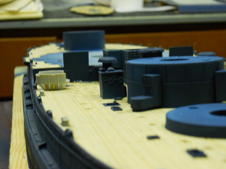

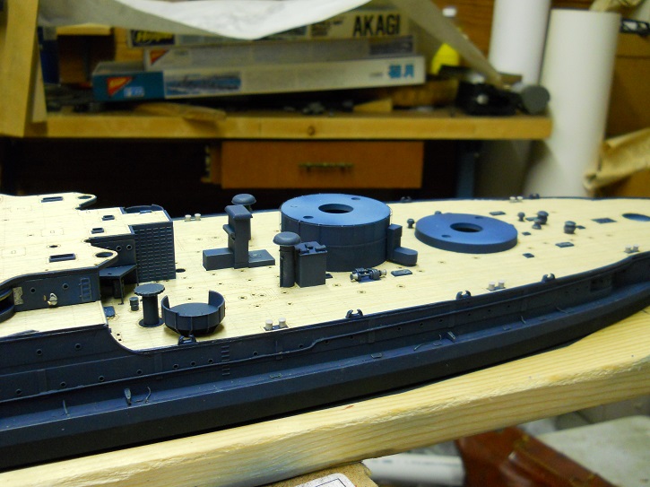

I've been focusing on the aft/quarterdeck of the ship moving forward to the midship O1 level(where I'm at now) then the bow. In the mean time while something dries, I work on another upcoming assembly. Things that can be installed (like hatches) and won't be modified I put on at one time.
The quarter deck involved all the mods that Jeff installed which I won't rehash. I can't thank Jeff enough for his research..

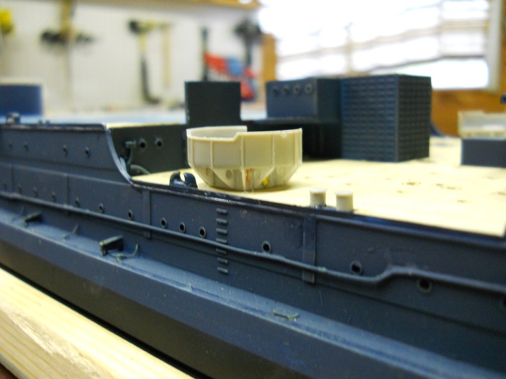

The aft 1.1" gun tubs had square bases which I modified:
Future Project: TBD

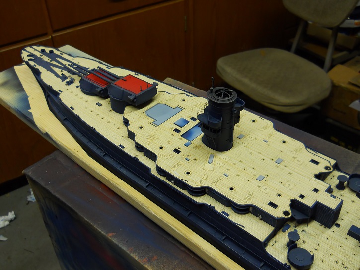

Shots of the q-deck area

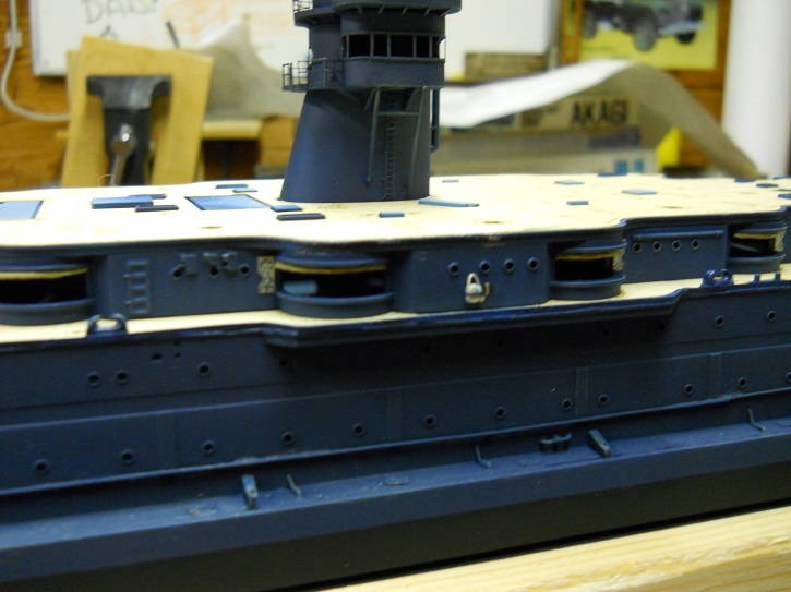

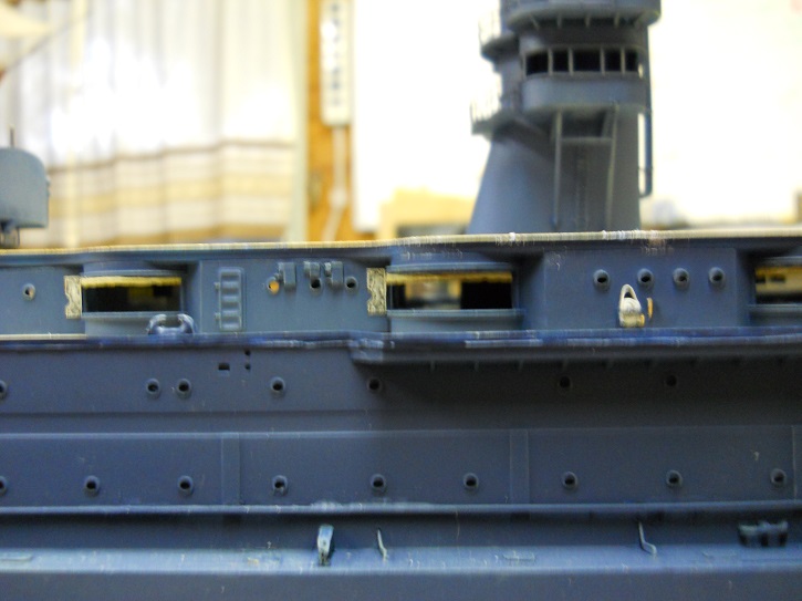

As I've been moving toward the casemates, I modded the sides as per Jeff and added the PE casemate doors..

As a note, Jeff implied he was somewhat a fanatic about installing walls/rooms inside the casemates/O1. I really can't see any alternative since one can see all the way through it like it's one big high school gym. Walls must go up! Out of focus but you get the point..
