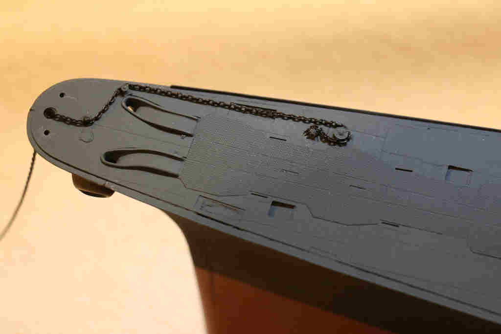

So, before anything gets done I have to locate some chain that I can use for the paravane chain. I'm using the 11 link per inch 3D printed stud chain from TFD for the main anchor chain, so the paravane chain had to be considerably smaller than that. Let me tell ya, folks, jewelers don't sell anything like what I wanted - at least not the ones around here. I was almost ready to throw in the towel and leave it off when my wife suggested Micro Mark, as she knew I'd bought small things from them before. Lo and behold, they had some. It's not studded chain, but beggers can't be choosers. This is 25 links per inch and when you lay it alongside of TFD's anchor chain, the scale looks just about right. And best of all, it's already flat black!

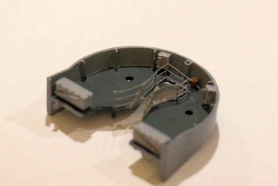

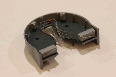

So, my lengthy search for chain is finally over. Now it's time to detail the bow gun tub. According to the plan book from TFD, there's a multitude of stuff that needs to be added; phone boxes, a fire plug, loudspeaker, 2-3" support columns, and spare barrel canisters as well as cooling tubes for the 20mm guns.
Here's my final result. As I was taking these pictures, I noticed that one portion of the railing is a bit off, and it really shows up in the pictures. I guess that's why it's a good thing to have these build logs. You can get a close look at the object and see the problems. Anyway, here it is, and yes, the railing has been corrected!
So, here's where I'm at now. The paravane chain is in place on the deck and routed correctly.
And, the test fit of the bow gun tub seems to be OK once I do a little puttying and sanding.

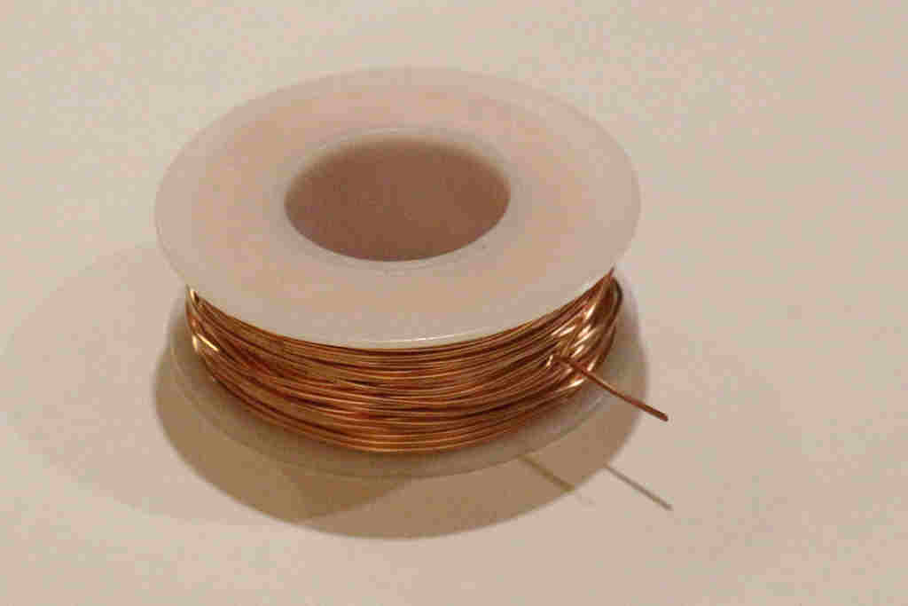

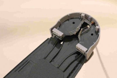

OK, on to the next issue - installing the round cap. In itself, that's not a big issue, except for one thing: How to join the ends of the brass rods together to make it look like one continuous piece. Glue? Doubtful. Solder? Maybe. But why do it at all? Why not use one continuous length? So I got on Amazon and bought a 50 ft spool of #22AWG copper wire. which will work perfectly.
So that's where I am right now, peoples. Yeah, I'm a lot slower than you are, but I'm trying to think this through and do a decent job. Plus, I'm pleased at what I've done so far and as far as I'm concerned, that's what counts - to me anyway.

Comment on the round deck edge lip... The biggest issue with coiled wire will be getting it straight enough. What I used on my 1:192 scratcher was brass on one side and steel music wire on the other as I couldn't obtain additional right size brass locally. Except at the curves at the extreme bow and stern, the music wire works quite well, making a smooth curve.
- BB62vet
- Posts: 3145
- Location: Mocksville, NC
Re: Trumpeter 1/200 USS Missouri Build Log (Sept 2015 - ????
Larry,
For the round deck edge lip - used guitar strings - get 2 of the right size (or approx.) and they should do the trick. That's my plan, anyhow.
Hope this helps.

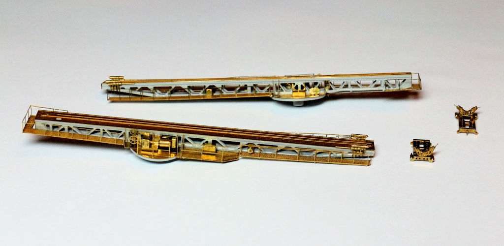

The next thing I did was to assemble the two paravanes and their supports. The first one went fine but as I was building the second one the rear support snapped out of my tweezers and went sailing off into another dimension. So, I had to get a sheet of brass and make my own. The first one was a failure, but the second one turned out OK. I doubt if you'll be able to tell the difference. Since I don't get a lot of time to work on this monster anyway, this took me forever.
Next item was the little control box for the crane. Naturally, the side adjustment wheel broke off and I never found hide nor hair of it. So, I ordered a set of various size wheels from The Floating Drydock and by using one of those, plus 1/16" of small brass rod for an axle, I made my own. Again, it looks as good as the original.(I'm getting pretty good and scratch building things I either lose or screw up!)
Now I'm building the two catapult launching cars and the two dummy car trucks. Things are going OK so far, but I'll be damned if I'm putting the handles on the dummy cars. I can't even see the stupid things!
This is where I'm at now. Nothing really interesting to report, except I'm getting a lot of practice in working with tiny pieces of PE! I'll try to take some pictures in the near future so you can see what's transpired (Yawn!). What I'm trying to do is to build a lot of the little PE details before I start in on the bigger items. It's tedious and I seriously doubted that you'd want to see all this stuff. However, that said, I realize I've been lax in keeping you guys up to date. I apologize and I'll try to do better in the future. The next thing I'll tackle are the catapults. They look like fun.

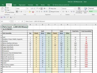

I was looking through my parts the other day and noticed something disturbing. For those of you who have the Pontos detail set, resin parts R04 and R05 are the side periscopes for the Mk37 fire directors. There are 4 of each part. However, on my pack of parts, the side protrusions (periscopes) are broken off on 4 of the 8 parts. And, I can't find the broken pieces anywhere. So, I'll probable have to scratch build my own and, to make them all look the same, I'll probably end up making all 8. Oh well, we never said this would be an easy build, did we?
Now, before I sign off, I have a question. What do I do with the two dummy catapult car trucks? I can't see what I should do with them. The only think I can think is that they are there to give me more practice in working with small PE???. Anybody got any suggestions?

While I was waiting for the primer to dry tonight, I did something that you're probably going to think is nuts. I'm sure Jason will come back with some retort after my "anal" remark!!
Anyway, I got out Excel and made a spreadsheet of all I've done to this ship so far and the exact number of pieces that went into each sub-assembly that I've built so far. Plus, I kept a running total on the far right Good Grief, I couldn't believe the results! I really have barely started on the actual assembly and already I've glued 1600 pieces in place (and probably swore at a third of them!). "Bout blew me away!
Anyway, some of you might be interested in this. And, if you're "anal" enough to want to do this yourself, let me know and I'll be glad to send you a copy of the spreadsheet. And now, it's 11:30PM and my eyes are crossed from counting all these damn little bits of brass so I'm going to bed.
