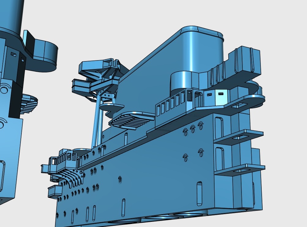

Thanks, Kelley! And thanks for all the great photos you sent.

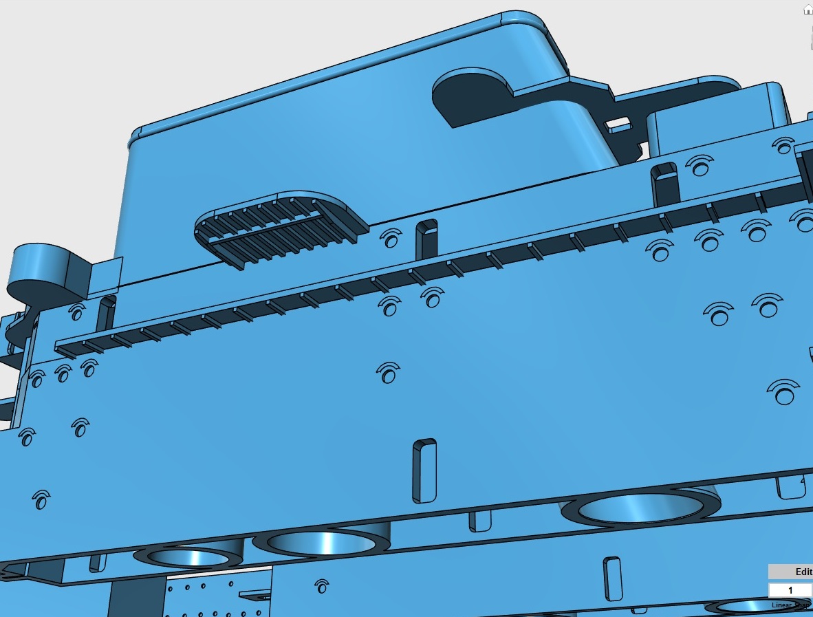

Here's the design at 85% complete. Some of the design differences between the ships have been identified.
Some adjustments are yet to be made as well as further detailing.

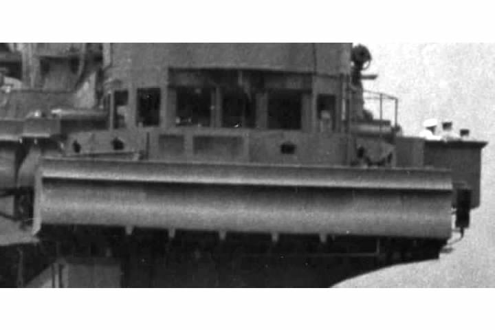

Re: Model Monkey 2016 Sneak Peeks
Looking good Steve! See below for some pictures I found of Enterprise in Mid-Late 1941. I hope it is ok for me to post them, as they are from the 'Life' collection. (http://images.google.com/hosted/life/16 ... ca6c8.html I started here and kept looking at the related images and found all of these and a ton more interesting pictures.) Maybe you've seen them before, but I know I hadn't so I thought I'd share.
These are ones I saved to my harddrive and forgot I had: (I didn't want to search through the pictures again from the link above)
Here's two of Hornet fitting out:
http://www.gstatic.com/hostedimg/db37d8de8361e841_large
http://www.gstatic.com/hostedimg/9bae99eab5100300_large
Thanks, Abe!
Excellent photos. Based on them, the height of the battle lookouts has been adjusted upwards in the design.
Awesome Steve!!!!
They are looking FANTASTIC!!!! Love the wind deflectors on the bridge platforms and the sky lookouts look great!!!
Kelley
Kelley

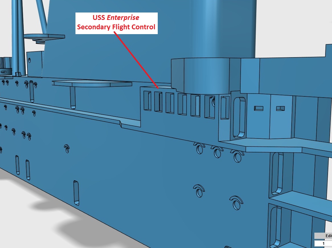

Closer....
The girls are really shaping up!!
Really amazing work here Steve!! Can't believe my own eyes!!!
I love all of the detail you have incorporated into these!!!
The second image looks like the pic Abe recently posted.
Email inbound.
Kelley
Email inbound.
Kelley

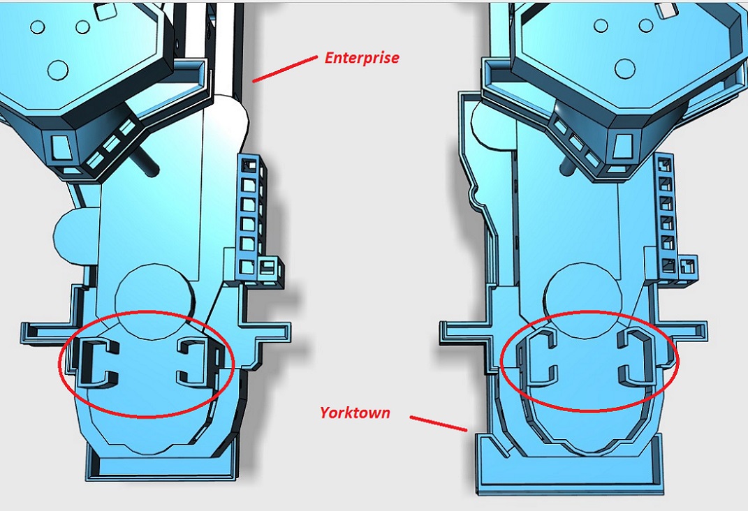

Thanks, Kelley!

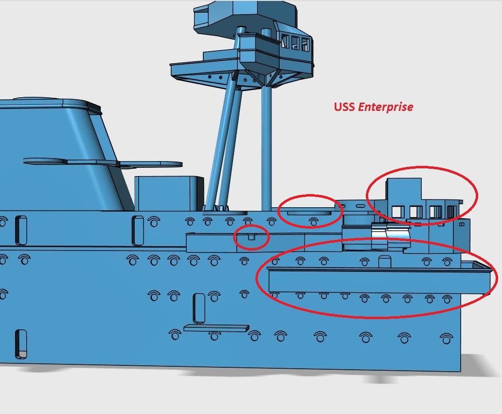

I'll tweak the radar shack, as you requested, no worries.
90% complete.
90% complete.
Thanks. Steve!!!
The platform/catwalk bracing looks fantastic!!!
Great job on these!!!
Looking forward to 100%
Kelley
Kelley

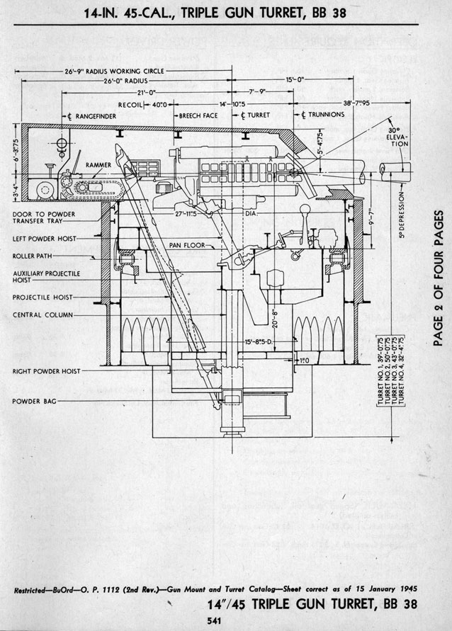

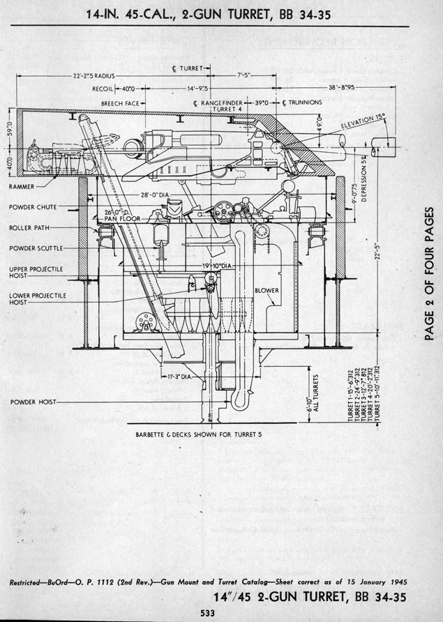

David is correct, the New York class turrets are different than Nevada class' twins (different barbette diameter, different glacis - New York/Texas glacis is curved, Nevada's is flat, different dimensionally). Although having about the same barbette diameter, the New York class turrets are comparatively smaller than Nevada's, being several feet shorter and the roof is about 16" lower.ArizonaBB39 wrote:Steve, quick question unrelated to the Yorktown islands. I can use your New York class and Pennsylvania class turrets for a Nevada class ship, right? I'm pretty sure they're the same (except maybe rangefinders), but wanted to double check before I bought some.
So, for the twins, in a nutshell, same guns, different gunhouses.
IIRC New York class guns could elevate independently within the same gunhouse. Nevada class twins may have been able to, too. At that time, a turret with two guns that could elevate independently was called a "2-gun turret". A turret with two guns that were mounted in the same sleeve was called a "twin gun turret". The Navy's turret catalog calls Nevada class turrets "2-gun" indicating that they could elevate independently. Their three gun turrets are called "triple turrets" indicating that the guns were sleeved together. (See drawings below.)
As you know, Pennsy's triples were mounted together in a sleeve and elevated together in the same gunhouse. Some models of Arizona have been built with guns at different elevations. Looks great, but the real guns couldn't do that.
Pennsy class triple turrets were the same length as Nevada's and had the same working circle and same distance from centerline trunnion to centerline turret. They are probably a bit different in detail so check your references to be sure.

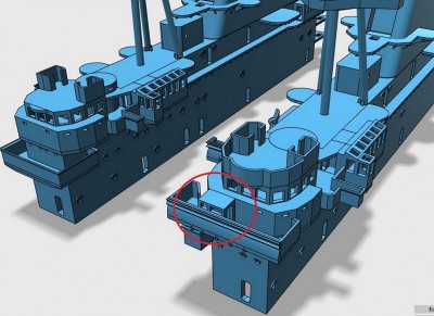

Smile, Kelley!
Weather shelter in place. Perhaps the real shelter was a temporary or semi-portable structure. In one photo, it is erected comparatively far to starboard as in the bottom photo (and the design) but in the sinking photo below it is a bit more to port.
Which position do you prefer?
95% complete.
95% complete.
ModelMonkey wrote:Smile, Kelley!
Wow!!! Those look awesome!!!
It looks good right where it is!!ModelMonkey wrote:Which position do you prefer?
As always, GREAT work Steve!!! FANTASTIC!!!
Kelley

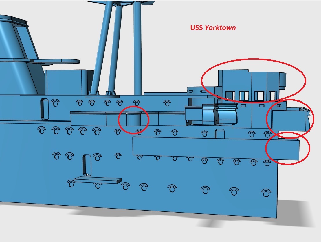

JTninja
- Posts: 709
- Joined: Sun Aug 15, 2010 6:19 pm
- Location: Seattle Area
Sweet! Any plans for a late war CV6 island?
