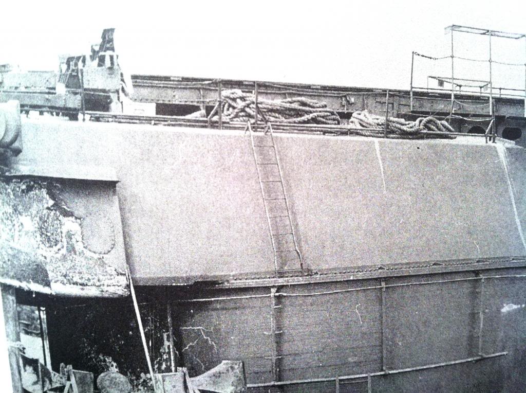

As far as the railing on top of turret #3 goes, she did have it up there on occasion.
Good stuff. Glad to see you are back at it.

DRAT!Jeff Sharp wrote:Hi Mark,
Thanks for checking in Jeff and scoping it out.
Mark

Good to see you back at it. Yes railing on number three. Here's your picture(AZ) you just posted..

Yes I believe it was removable. The aft/stern main deck railing was folded down for catapult operations as well.
