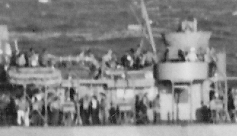

Does this help ...
USS ANDERSON (DD-411) was one of the four units modified at Charleston Navy Yard in December 1941-January 1942 with four 20-mm guns replacing the 50-cal MG. Among the first, or maybe the first, USN destroyers to get 20-mm guns. Besides ANDERSON, USS HAMMANN (DD-412), USS MUSTIN (DD-413), and USS MORRIS (DD-417) were the units modified at Charleston Navy Yard. Looking at photos of any of these units will show the basic layout of the aft deckhouse. ANDERSON didn't get two additional 20-mm guns added on the aft deckhouse until after Midway.
DD-409, 410, 414, 415, and 416 were modified at Norfolk Navy Yard to a different configuration, but still with four 20-mm guns. The units left in the Atlantic, DD-418, 419, and 420, were modified at different times (March-June 1942) after the above nine units at Charleston Navy Yard (DD-419) and Boston Navy Yard (DD-418 and 420) to a different configuration.

You beat me to it! I was about to point out that photo from earlier in the thread.
What I can't tell about Anderson (and, what's stopped me from attempting an aft deckhouse of her) is whether those 20mm tubs at the front of her aft deckhouse are just that - circular tubs - or whether they're the longer form as found on Hughes and Sims from their December, 1941, refits.

Thanks, Rick and Bob. That's actually the photo that I am using as my primary reference, but Bob's observation about whether the gun tubs on the forward edge of the deckhouse are circular or oblong is the problem I am having as well. The obvious structure in the middle of the deckhouse leads me to think Anderson may have had her aft con station located there like DD 418 Roe did. That blurry structure is about the length of the 5" gun tube away from the gun turret atop the deckhouse, just like the photo of Roe. Your info of the yard alterations would lead me to think the aft con station was on the forward edge of the deckhouse as found on the January photo of DD 417 Morris. The photo is at the wrong angle to clarify that one detail. A great photo, though, as it shows lots of the detail I need, plus when one thinks of the drama going on at the time of that photo, you have to stop and think.

In looking at the photo once again, and enlarging it, it appears that the back of the gun tub has a flat plate going across to the other side from the rear of the port side gun tub. That tends to reinforce my thought that the 20mm gun tub is the long, oval type that runs the width of the deckhouse, as opposed to the circular tubs that appear on DD 417 Morris.
The photo is pretty "busy" in that area, with the searchlight platform and all, so I could easily be mistaken.

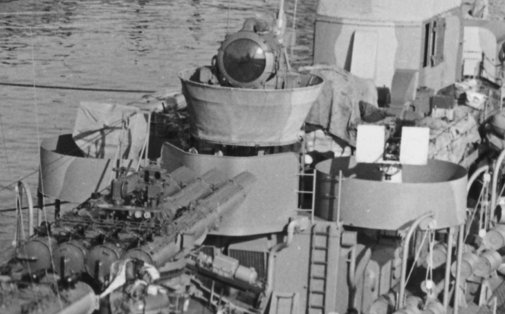

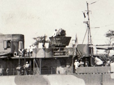

Remember that DD-411, 412, 413, and 417 were modified to the "Charleston Navy Yard" configuration. They all looked pretty much the same. The 20-mm "tubs" were (or at least started out) round. See the attached views of MORRIS at Charleston Navy Yard on 5 January 1942 and on 8 May 1942. In the same photo this image was cropped from, ALL FOUR of the above destroyers can be seen and they all appear to have the same type of 20-mm 'tubs'.
There is some confusion on my part for USS MUSTIN (DD-413). She operated separate from her "Charleston Navy Yard Modified" sisters for much of early 1942 and in a photo dated 14 June 1942 reportedly at Pearl (see third attached image), shows four 20-mm guns with exterior 'ribs' on the tubs and her after deckhouse 20-mm guns repositioned a little further aft. These look different in the limited views of her seen on 5 January 1942 (see fourth attached image). BUT, I found records that MUSTIN and O'BRIEN (DD-415) (a "Norfolk Navy Yard Modified" unit) had two additional 20-mm guns added, for a total of six, in an April 1942 yard period at Pearl Harbor. So either the photo is dated wrong, quite possible, or something else happened ... because I can't find another pair of 20-mm guns in the image.

Well, Rick, thank you for your efforts. I think I will now use the circular gun tubs for my conversion. I don't see how it could be otherwise, even though 413's differences gives me pause. My thoughts on the use of the oblong tub and centrally mounted aft control station would only add a second anomaly to a relatively small group. Not likely.
