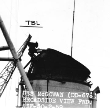

The next thing I have involved with is the forward stack. After painting the inside of the exhaust area and setting the caps in place, I can proceed to the pipes.
This is, pictorically speaking, the closest I had ever been to this stack a week ago:
Not very useful.
Mr. Rick Davis and Mr. Hank Strub provided me with some other closer pics, much more useful, dating back from a short time before the transfer of this US Navy unit to the Spanish Navy:
Being of USS MacGowan herself, these two pics are way better than anything I had seen before, but were not accurate enough. Purely by chance I came across this other web site:

The pipes seem to be too thin, but as the ship is clearly under refit or construction, it is also clear these pipes had not been isolated yet, as it can be observed in the following two pictures, without and with isolation:
I am afraid the upper part of these pipes will need some elaboration:

I don't know if you are aware, but the USN converted from "steam whistles" on the forward stack to an electrical powered whistles. This changed dramatically the "plumbing/conduits" required running up the stack. This would explain some of the difference you see in photos. I don't know exactly when this mod was started and done on all FLETCHER class units. I had not been tracking that mod, I just know it happened.
USS McGOWAN (DD-678) during her last overhaul in 1958-59 ... I think you already posted this image. It isn't very good at showing the detail of the whistle.

Rick E Davis wrote:(...)The USN converted from "steam whistles" on the forward stack to an electrical powered whistles. This changed dramatically the "plumbing/conduits" required running up the stack. This would explain some of the difference you see in photos. I don't know exactly when this mod was started and done on all FLETCHER class units. I had not been tracking that mod, I just know it happened.
Mr. Davis, yes I know that, but I think MacGowan had still a steam whistle when she was transferred to the Spanish Navy to become Jorge Juan, and that she retained it in the mid 1960�s...
...and well into the 1970�s:
On the other hand, USS MacGowan didn�t seem to have the small platform on the top, and nor seemed Jorge Juan either for the rest of her career. Too bad, I would have loved to build it.
