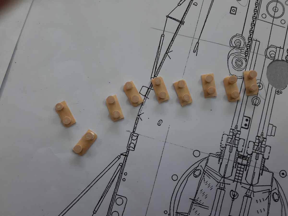

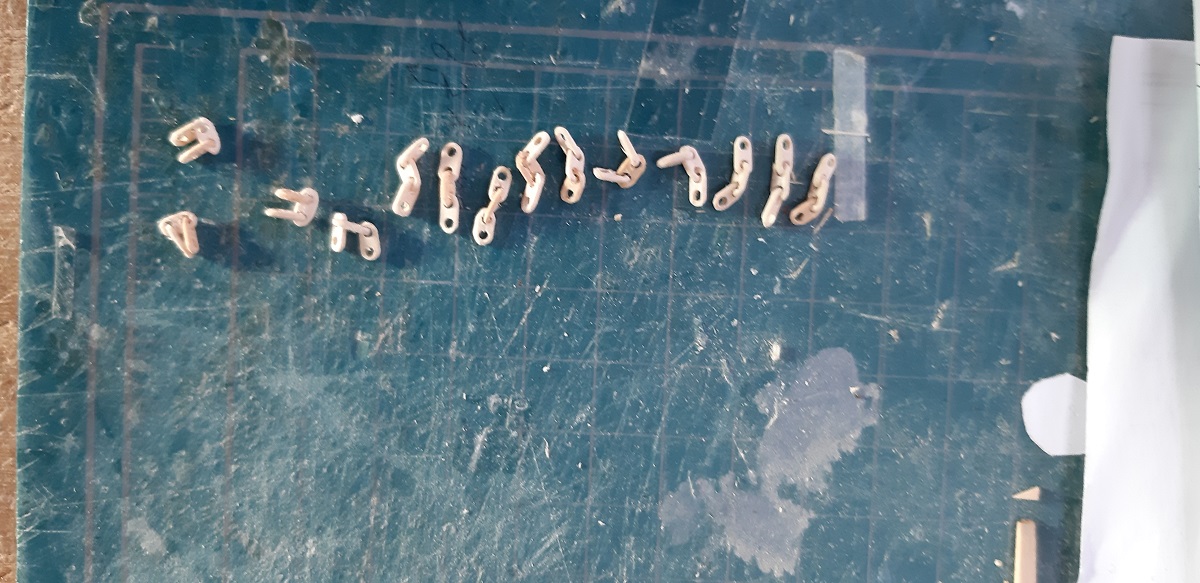

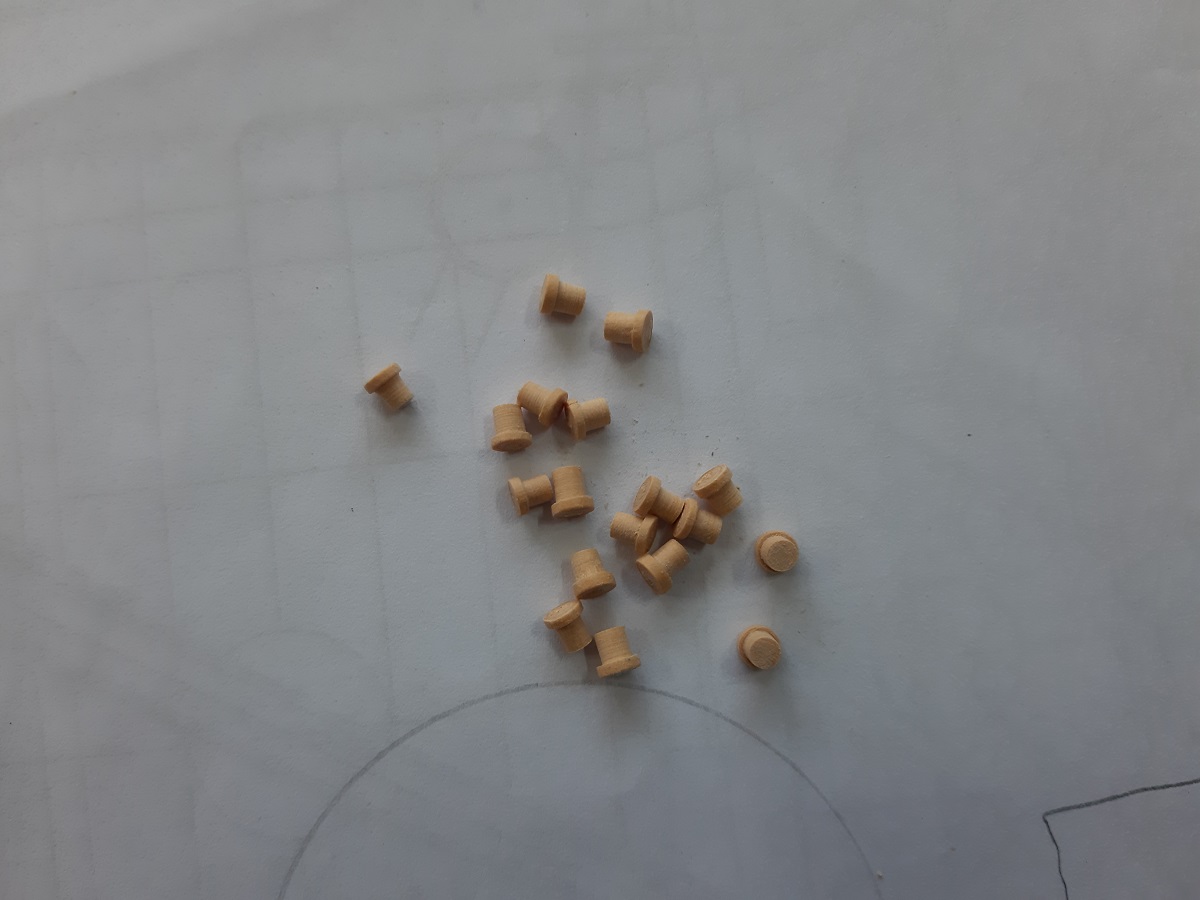

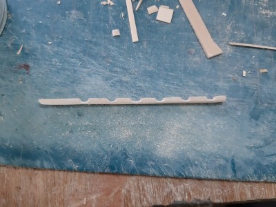

The method :
1.Make each link, drill the narrow panel 2hoes and cut and make shape of link by fine sandpaper or file.
Prepare enouh Qtys of link.(1st photo)
2.split a link and insert links both sides(3links) then glue the other piece of link.(2nd photo and 3rd)
3.connect links same method untill wanted lenth.
Cheers: Song.

The method :
Cheers: Song.

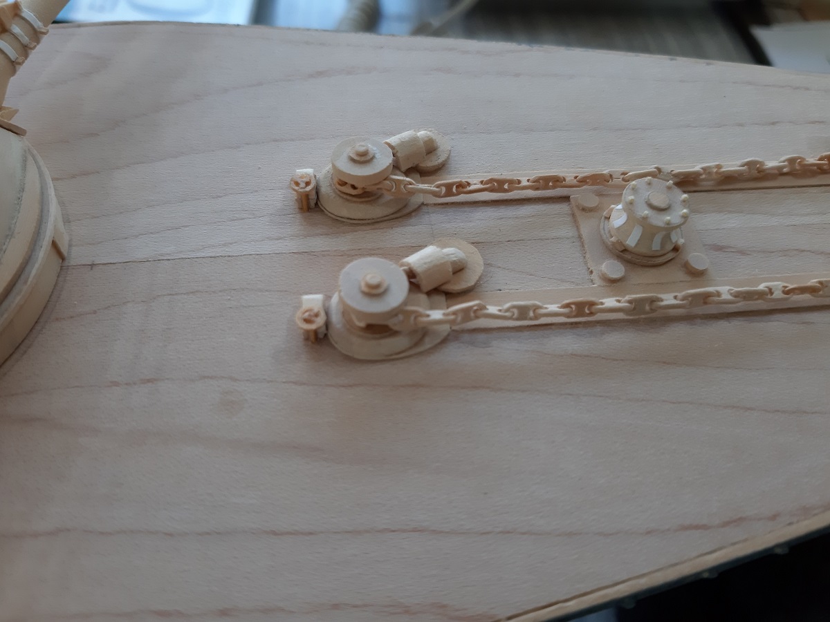

Hi,all!
I've installed anchors. First,I made chain stoppers and The chain goes into the hosepipe round the winches
finally down to the deck.
Other anchors was attached on the wall.
Song.

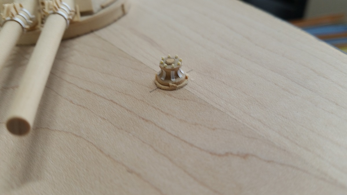

Hi,everyone!
I've done bollad of nagato.
Song.

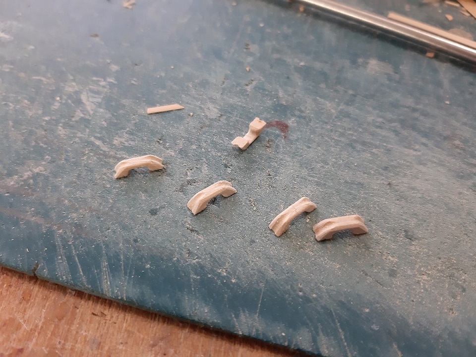

Hi,gentlemen!
It's opened fairleads. It's roller fairlead for paravane last picture.
Song.

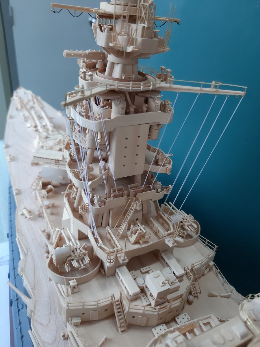

I start some rigging at the yards.
Song.
