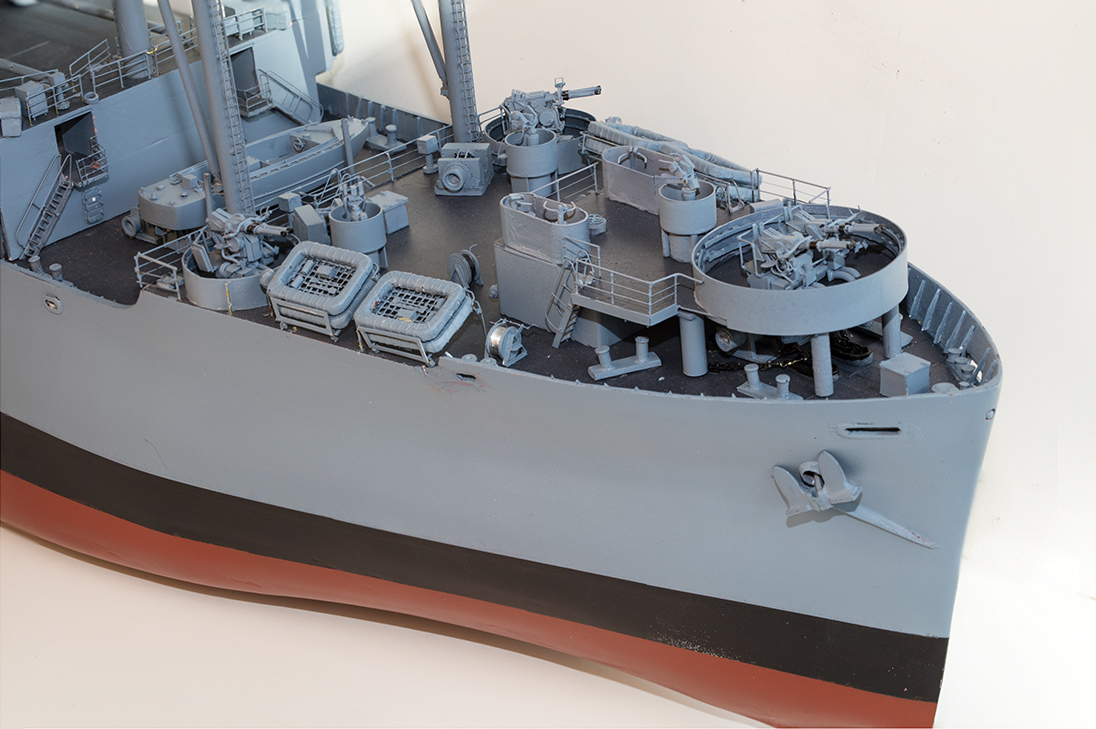

Today I soldered up the circular rails for the radar platforms. New technique for me at any rate. Turned a appropriate size wood cylinder to hold the wire while I soldered the ends together. Then used it to solder the legs on as well. Worked fairly well, Radars are now atop the masts.

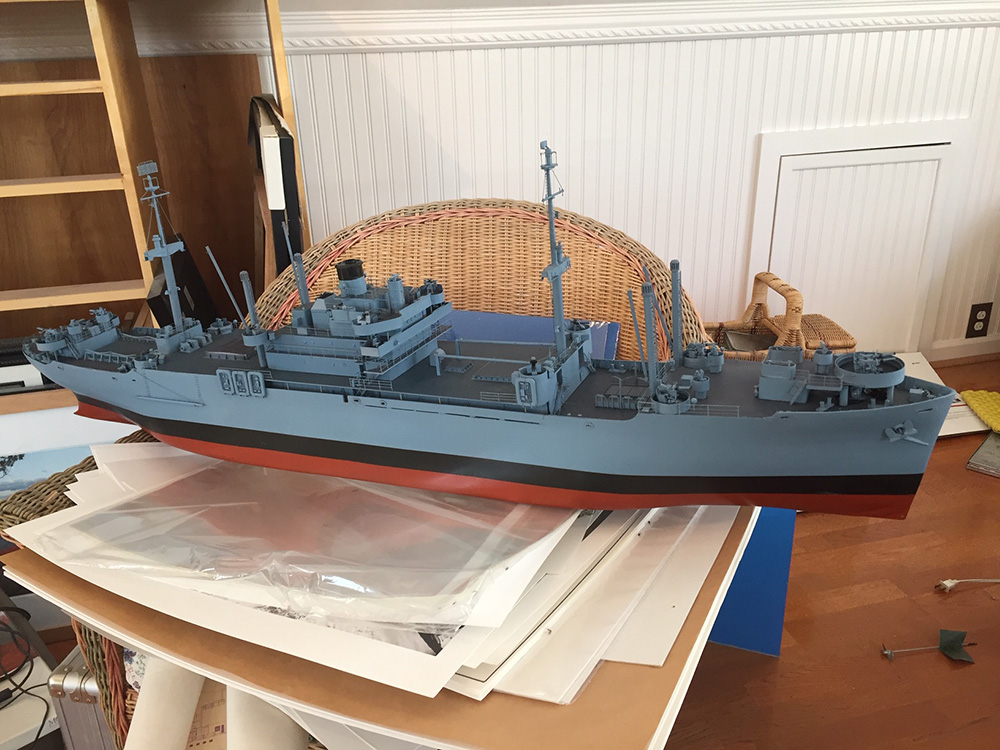

Current progress on the Forecastle. Made another half dozen rafts, the ship has a lot of them. Cast in resin from a basswood master.

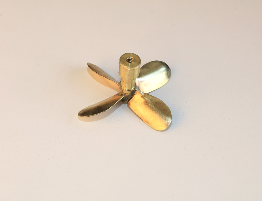

I'll show it anyway, prop try #1. I made the jig using whatever was around the house. I think I will have to buy a good base sheet to more accurately lay out everything. The jig works great, the soldering only takes a couple of minutes if that, but it's the setup that has to be very precise. Once the prop is soldered a significant challenge is curving the blades! A learning experience.
This is from the front of the prop looking aft. The shaft extension is left on to simplify the setup on the jig and willl be cutoff and the prop threaded onto a shaft.

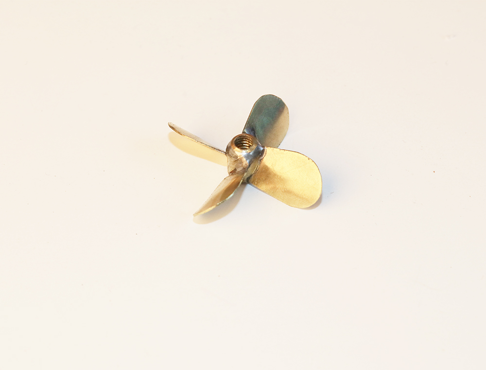

Prop try 2. Learning curve!
