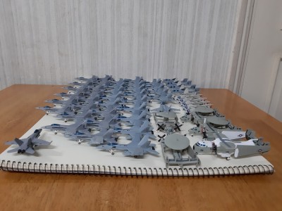

Hi,gentlemen!
it's CVW-11,total 51 aircrafts.
Song.

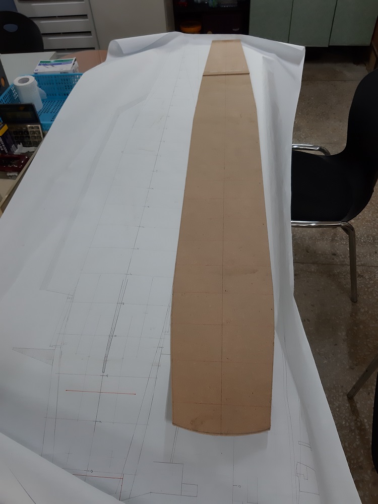

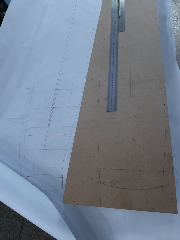

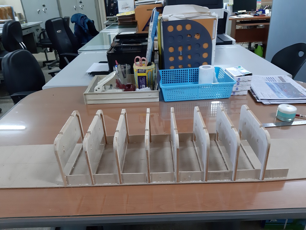

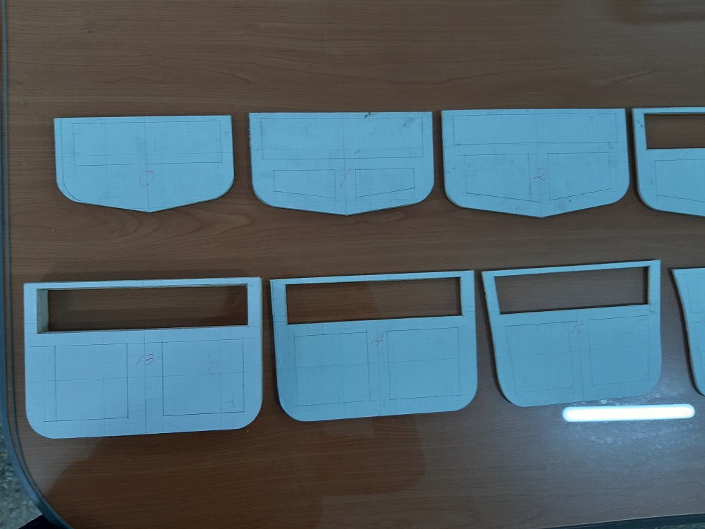

Hi, gentlemen!
I start aircraft model itself at last.
At,first i prepared bodyplan.
The purchased drawings is small different hull in the drydock.
I've drawed bodyplan and attached on the board.
and cutdown it.
Song.

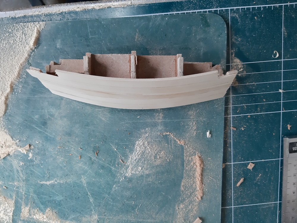

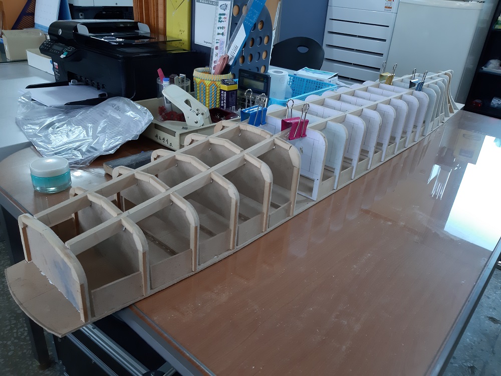

Hi, gentlemen!
I start to assemble frame of body.
Song.

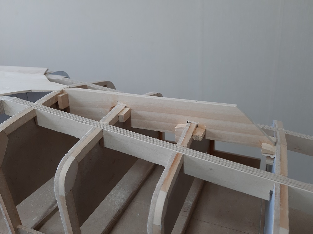

Song Jung Gun
Posts: 1631
Re: 1/200 USS Nimitz
Post by Song Jung Gun »
Frame work of hull.
Song.

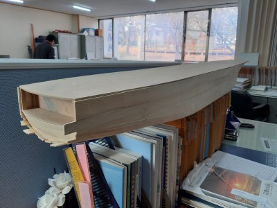

Hi,gentlemen!
It's still planking hull. I prepare transom and skeg,
The wood nails inserted to removed pin holes.
Song

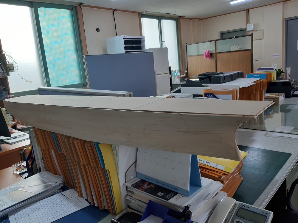

Song Jung Gun
Posts: 1631

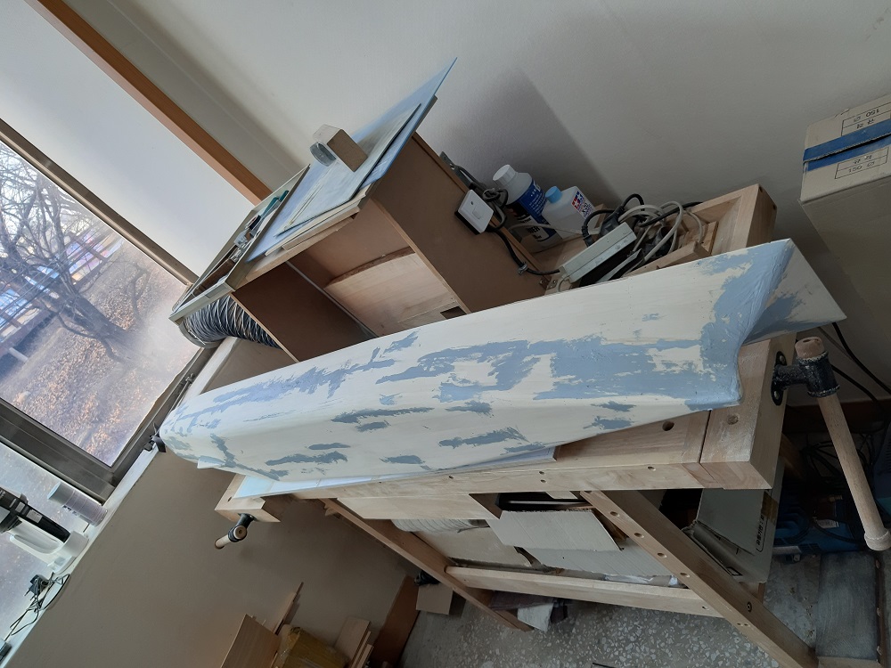

Hi,gentlemen!
I did sanding and sanding after putty and sanding.
Song
