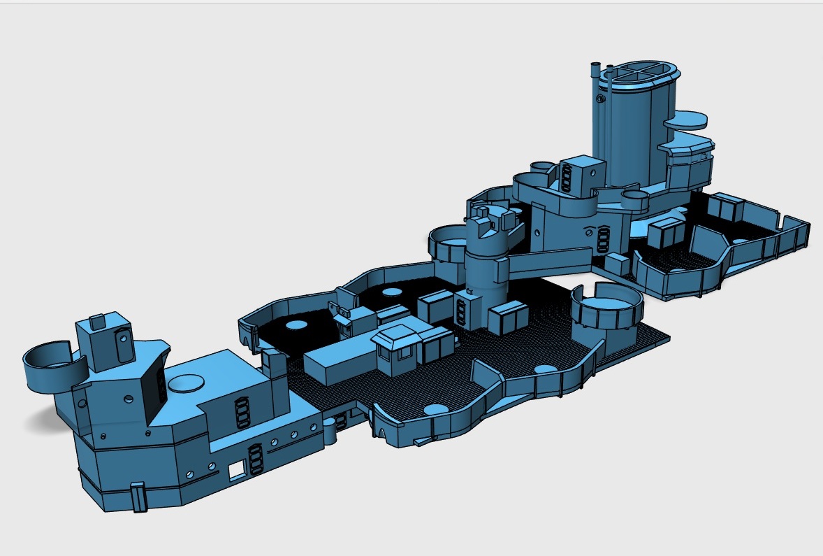

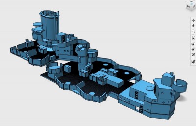

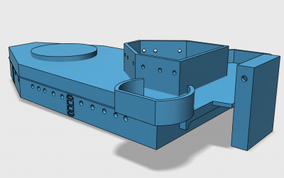

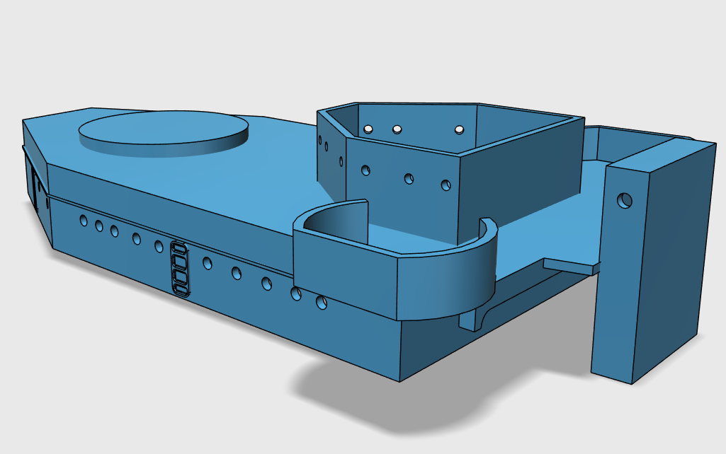

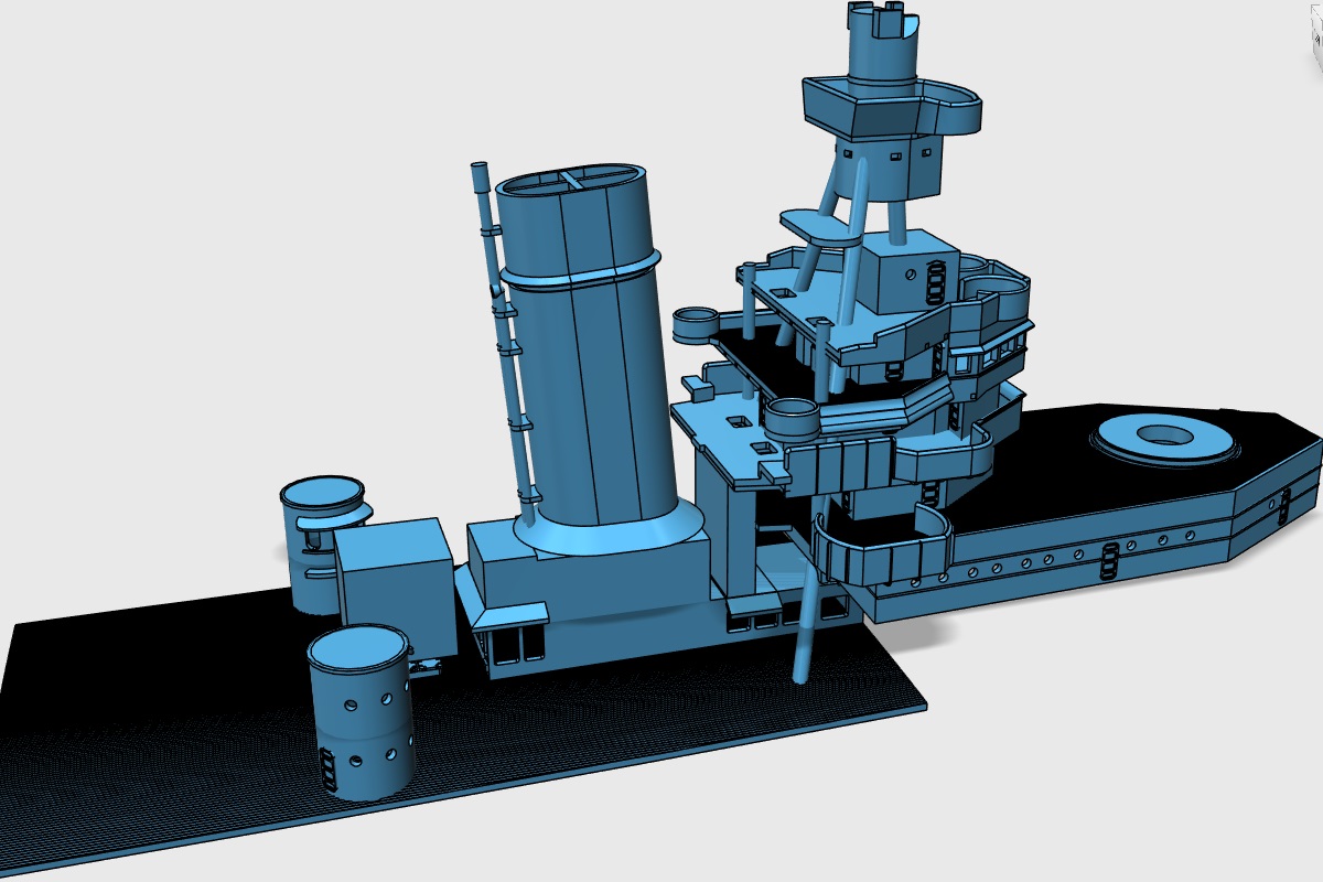

Bob of "Bob's Starship Shop" and I will be designing some WWII USN cruiser superstructures.
I'm happy to announce a 1942 USS Portland CA-33 forward superstructure design for 3D printing is in progress. Pre-war bridges of both "Sweat Pea" and Indianapolis are also in design. All will be available in 1/700 scale and 1/350 scale and 1/200 also.
Here are a couple WIP screenshots of the 1942 version's incomplete and not-yet-detailed 01 and 02 levels so far. Comments and advice are most welcome. I hope to have the first designs complete this weekend.

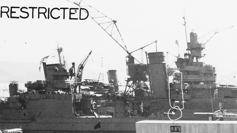

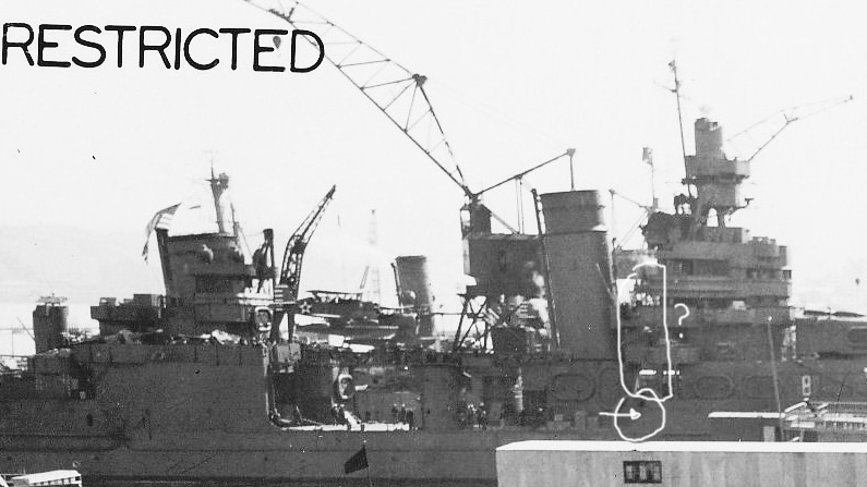

Re: Portland 1942 bridge
Go for it.
Modifications to an Indianapolis kit should start even lower though, since the break between the fore deck and main deck is further forward in Portland than in Indianapolis. The two rear tripod mast legs are visible all the way down to the plane handling deck area on Portland though not on Indy. It looks to me like they will need to pass right and left of that big vertical box shape that you've got on your 3D drawings in the back (hard to see it clearly in your two views). The clearances for that could be pretty tight. I'm not sure if I've got that structure in my 1942 reference photos or not. (My best photos of that area are not electronic at this point, but I've attached a cropped Feb 1942 side view that you probably already have in full).
The structure around the second funnel should also be an interesting challenge for Portland in 1942. It has undercuts and lots of details (windows, platforms, searchlights, inverted V brace for the plane handling crane,...).
Still, once you get it done, I'd be interested in the 1/700 version conversion kit.
Dave K.

DavidK wrote:Re: Portland 1942 bridge
Go for it.
Thanks!
DavidK wrote:Modifications to an Indianapolis kit should start even lower though, since the break between the fore deck and main deck is further forward in Portland than in Indianapolis.
Indeed. An aircraft handling deck, larger for Portland, is also in development. They will have to be made available separately as the parts will be too big to print together.
Be advised, the conversion parts are not intended to be a complete conversion kit. They will, however, relieve the modeler of having to scratch-build a new forward superstructure and aircraft handling deck.
DavidK wrote:It looks to me like they will need to pass right and left of that big vertical box shape that you've got on your 3D drawings in the back...
Good eye! Just forward of it, actually.
More will be discussed here as development continues:
viewtopic.php?f=16&t=160958

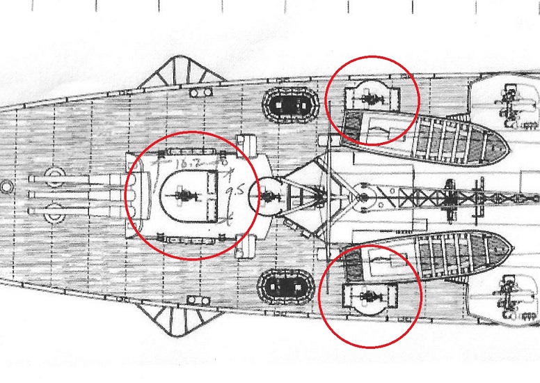

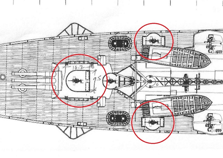

Anyway we can convince you to also make the aft 40mm tub as well? Portland and Indy during the war (until Dec'44) had the same tub shape, but Academy and Trumpeter failed to make this pieces, while still making the seagulls and Indy's forward 20mm tub (pre Dec"44). Should be easy to make :thumbs_up_1:
Posts: 4135
Re: Calling all USS Indianapolis & USS Portland (CA) fans
Post by ModelMonkey »
JTninja wrote:Anyway we can convince you to also make the aft 40mm tub as well? Portland and Indy during the war (until Dec'44) had the same tub shape, but Academy and Trumpeter failed to make this pieces, while still making the seagulls and Indy's forward 20mm tub (pre Dec"44). Should be easy to make :thumbs_up_1:
Sounds good. Please confirm exactly which tubs you need, perhaps from a photo of drawing.

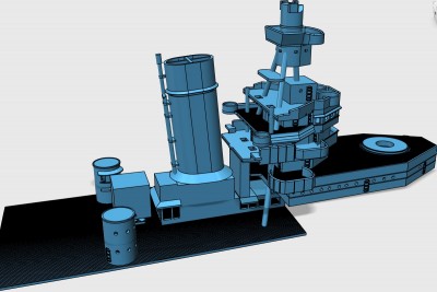

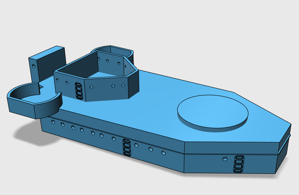

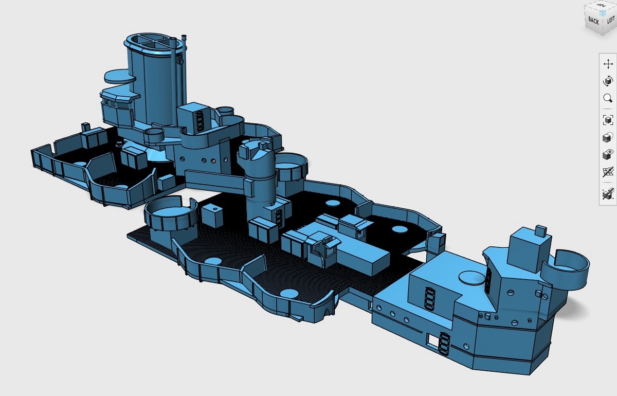

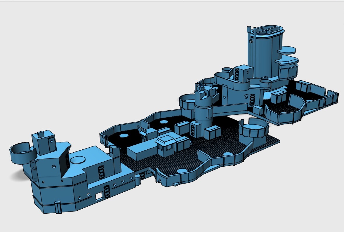

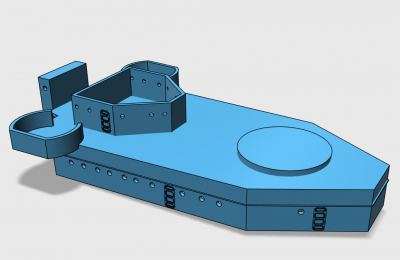

Hi Steve!
This thread should help; it shows some hull surgery to build Portland. viewtopic.php?f=16&t=160958&p=679789#p679789
You are one of the first to order these parts. I hope that you will find the conversion pretty self evident once you have the parts in hand, and that you are delighted with the designs.
The images below should help show how all six major superstructure sections are arranged:
