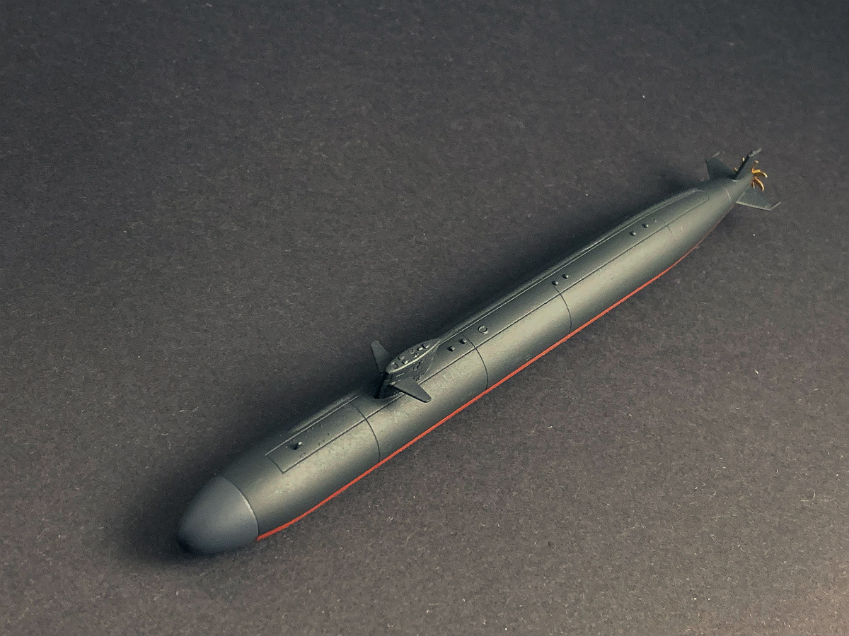

Agree with you Jacob :thumbs_up_1: , but Riich's propeller is too big
Here is my vision of the 3 LA flight , all are Riich models (except ASDS on Charlotte come from Hobby Boss kit):

Nice job, Pierre! The weathering is really good.

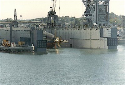

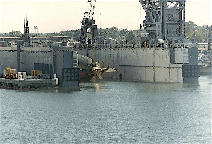

The blades are skewed back at the tips. There is a lot of technical detail about the specific design details of the props that are still classified. There aren't all that many pictures of an LA prop available. You need a bit of an oblique view to see the skew.
LA Class in Drydock
LA Class in Drydock

Thanks for some clarification Tom. I have seen the picture you posted and had a hard time seeing it with my Mk-1 eyeball. So the "tips" are swept back and not the complete blade? I will modify my 688s to reflect that.

Focus on the blade at the 3 o'clock position. The "tip" is the outer 2/3 - 3/4 or so, so a significant amount.

Thanks Tracy, it's hard to see it but the more I stare at it I can make it out. So then, the "angle" on the props for the current models (HB,DML,Riich) are correct?

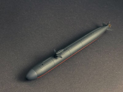

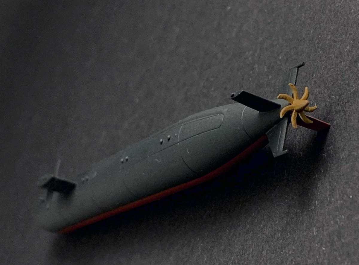

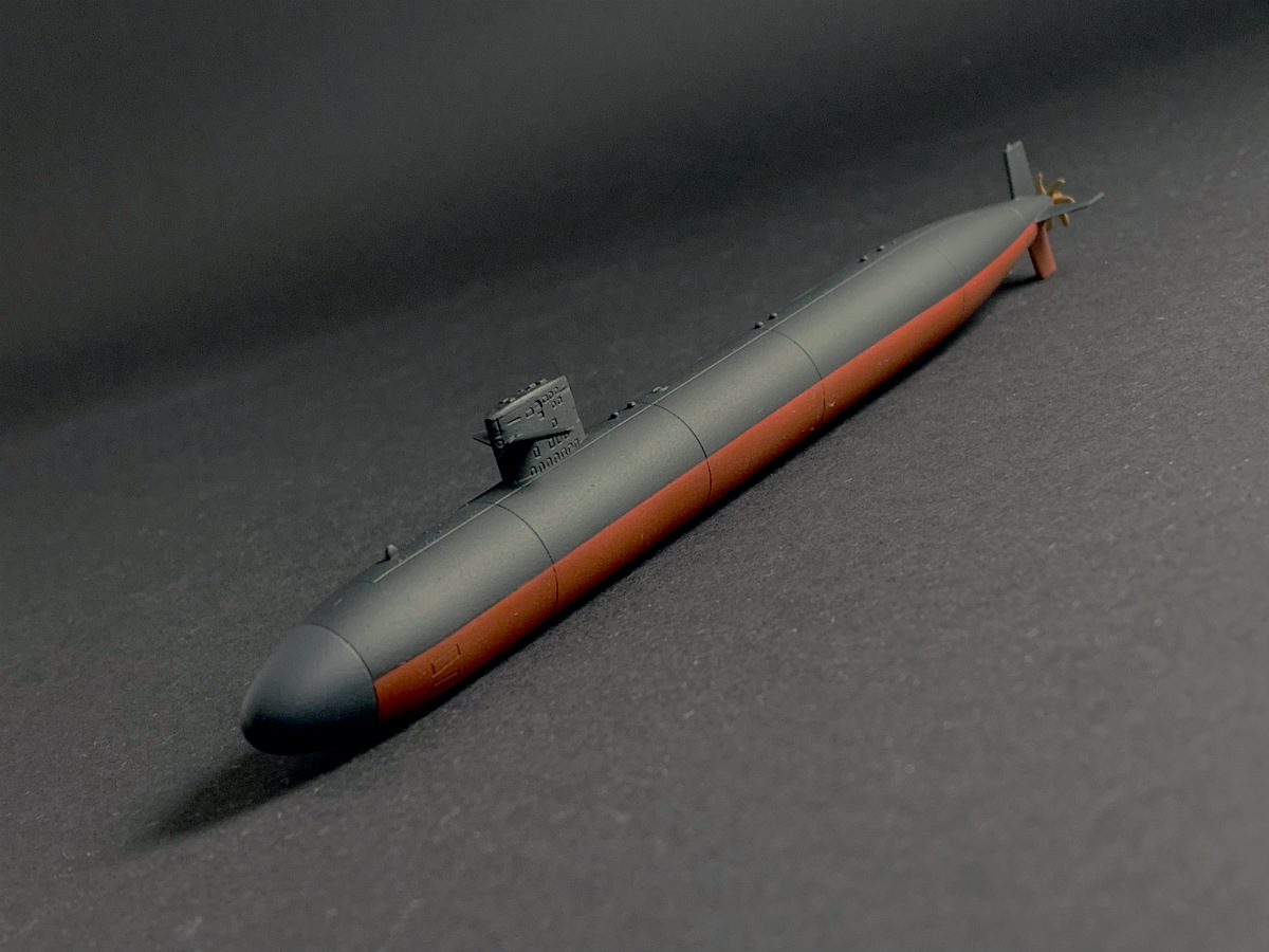

I have 2 question for you 688 buffs. Im building the 1/700 scale 688 from Hobby Boss.
1) The tail fins (horizontal) have these stabilizers on them - real submarine never had them, correct? Should I cut these off? (sorry dont know correct terms for them, im more of a ship guy).
2) Painting the original Los Angeles 668 - any tips on the correct scheme Flight 1 boat? Which options are there? Mainly regarding the levels where antifouling red goes - up to waterline all around, mid point of the sub, and what happens to the bow - radar tip - is that painted also same manner as hull, or differently?

You're correct that the Los Angeles class never had end plates (the stabilizers) on their stern planes. I blame the movie The Hunt for Red October, where the Dallas erroneously had these end plates.
Your paint scheme depends on the era and the stage in the individual boat's service life. When launched, they were painted red up to the waterline and had the white markings outlining the hatches and the number identifying the particular submarine. In service, they were only painted red from the keel to the centerline, and above the centerline they were black. The sonar dome was almost always painted black and the only markings were the draft markers near the waterline (the little tick marks with numbers next to them)
Starting probably around 2000, submarines started to adopt an all-black paint scheme. So if you're going for an '80s or '90s look: red below centerline. More modern: all-black or (in a few cases) dark grey below the centerline or waterline.
Also, I usually paint the sonar dome in a lighter grey because the fiberglass dome usually weathers to a lighter shade than the hull, even though they both start off as black. I do the same with the small sonar window on the leading edge of the sail.

Im doing an early 688 as launched but - operational. Ie without hatch markings and without the �688� on the sail - I hear they usually display those when in port and remove when operating. The boat will be without the tiles, so basically a cold war era 688 is what Im after. Based on that lower red hull on centerline, black dome, no markings of any kind except for draft markings. Makes sense?

Tbh, Im fairly confused about the state of its rear rudders. According to hobbyboss kits, the VLS has the triangular one, the 688i has triangular one with extra fins added at 5 - 7 oclock on the rear, and original one has these small ones. I didnt understand this and I have added triangular finds (when looking from top) - and yet it may be still wrong.
So, seems like Ive made the VLS here.... But without the tomahawks space in front. :( However HB painting instructions all seem super wonky. Im left in utter confusion, before I starred.

I'm not entirely sure I understand your description and what you are asking. The all moving vertical rudders are the same on all three 688 versions; one difference, as noted above, is the early boats were missing the towed array on the starboard stern plane. Hence if you want an early 688 "as built", you need to remove the towed array fairing along the starboard side, as noted by Jacob above. I see you left the towed array fairing on your model. The towed array itself deploys out of the tube on the tip of the starboard stern plane. You might want to drill this out a little bit (not too deep) to make it look like a tube rather than a solid plug. Likewise, the stern planes (which are different shapes than the rudders) have an immovable section forward and a hinged section in the rear; it looks as if you have these on correctly as well. So I am not exactly sure what you are asking about the rudder shapes....
I see the kit comes with "panel lines" running around the hull, as well as a waterline scribing around the upper deck. These should be filled in with putty and smoothed to be level with the hull. Submarine do NOT have panel lines in the hull (think about that... would you want panel lines in a pressure hull?). In the "real world" at Electric Boat, hull sections are joined and welded (with multiple welding passes) together and then the welds are ground down to within 1/16th of an inch of the rest of the hull, to minimize flow noise and friction. The only "panel lines" on a submarine should be the removable panels on the sail (for maintenance of the various masts) the two deck hatches, external torpedo tube shutters and the panel lines on the VLS installations on the later boats. Somewhere in the lost sands of time, back in the early 1990's someone at (Dragon) DML making the masters thought they would put panel lines on the hull, and that mistake has been repeated ad infinitum.
Here's an LA in dry dock; see any panel lines in the hull?
http://navsource.org/archives/08/770/0877201.jpg
https://i.pinimg.com/originals/94/1d/52 ... fe9ea4.jpg
BTW, what IS missing in these kits are ballast tank flood ports on the bottom of the hull. I mean they ARE submarines and these are a vital necessity when attempting to submerge. Also, lose the six unsightly bumps along the centerline aft of the sail. These are very poor & oversized representations of retractable cleats. The exception is the one protruding installation on the bow, which is a sonar installation. I suppose the round circle aft of the sail is supposed to be one of the entry hatches. There should be one forward of the sail as well. Bad news, though, is that the circular hatches have an oblong integral cover to smooth the hull, which you can see here:
http://navsource.org/archives/08/700/0870019.jpg
So it should be an oblong and not a round scribing.
The anhedral fins were on the later 688's, which also had a "ringed propeller" to operate under ice (protect the blade tips). The anhedral were actually at the 4 and 8 o'clock positions, more horizontal than vertical (see below photos). You can see these two items, along with another towed array that was added to the port side on Jacob's propeller page- about 4-5 photos from the bottom of the page.
https://imgur.com/a/IQBOi
Also, here: https://www.reddit.com/r/WarshipPorn/co ... ck_5514_x/

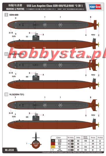

Have you seen the HobbyBoss 1/350 early 688? The stabilizers are small and squarish. That's what I meant. I wasn't aware they were ALL identical.
See attached on top.
As far as I understand I have the hull panel lines that had to be filled, which I did not - that's too late for now, sub is already painted and has water markings added--- Ill probably go back and redo this part at great cost to my sanity.
Thanks for the tips. I think Im covered now. For my 1/350 LA class Ill build the VLS with the proper smoothed lines from the start. Cheers. :thumbs_up_1:
