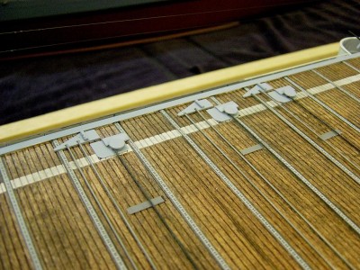

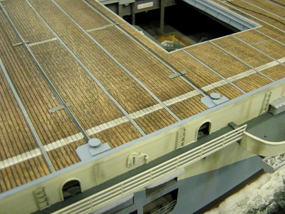

I'll start with the barrier arms. For those of you who are not familiar with carriers, a barrier arm is a series of wires that pop up to a vertical position during landings. This prevents the aircraft from crashing into things should it miss it the hook on the arrestor wires. There are 3 barriers just aft of the bridge(island). Shown in the lowerd position on the stb. side.

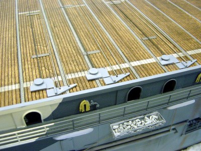

Here's another view. Arrestor gear and barrier arms are styrene. Arrestor cable is .025 waxed rigging line, and the barrier wires are .025 piano wire. Note the yielding bars, the small rectangles you see beneath the arrestor cables. These were kind of like a leaf spring that popped up and raised the arrestor wire slightly above the flightdeck, to facilitate the aircrafft grabbing the wire with its hook. Small strips of .010 styrene used here.

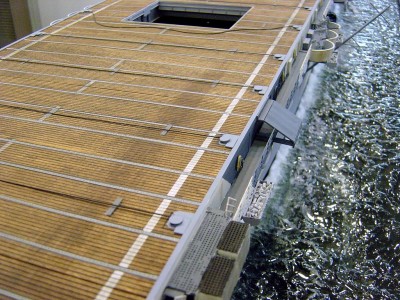

Another view of the arrestor gear. There are a total of 13 arrestor wire assemblies. A bit of weathering needed yet.

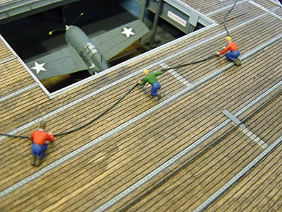

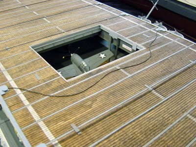

Note this arrestor cable. It goes right across the aft elevator opening. All the plans and reference material I have show this. Question was, what did they do with it when the elevator was in use? Detaching it from the gear would have been a time consuming task, I would think. I called one of the pilots that flew off the Santee, Don Pattie,a highly decorated man, and asked him. He told me the deckcrew would simply pull it back out of the way once the tension was released on the cable. When all aircraft were up on flightdeck level, and the elevator was no longer in use, then the cable would be pulled back to it's original position. By the way, Mr.Pattie is 85...

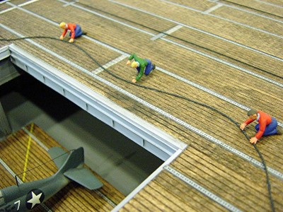

Hmmmm....deck crew pulling the cable.......OK, how's this??
Looking from behind. I plan about 50 figures or so. Don't want it too busy. The real aspect of this project is the ship, not the other stuff. Just icing on the cake if you will......

Hi Bill Very effective use of figures, makes for a more realistic model.{ I have 50 or so figures for Kiev , more like dots than deck crew} Re- the arrester wire across the elevator , some times it's the simple procedures that are not that obvious. As usual a tremendous job . :thumbs_up_1: :thumbs_up_1: :thumbs_up_1:

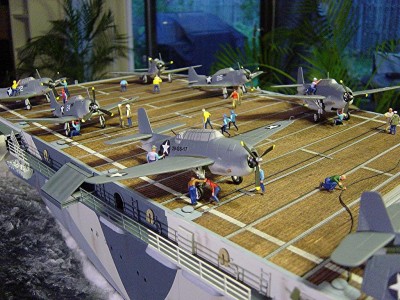

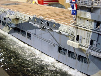

As I stated up above, the ship is now pretty much completed. I am awaiting 6 more 20mm guns for the port side. Sure are slow in getting here. Anyway, I tried to get a couple of overall shots of the ship. And I am working ever so tediously on the aircraft. Crew last. So heres some shots of the ship, still in the shop and I plan to move it soon which will be a tricky task at best. Ever paint yourself into a room?? :big_grin: Some shots of the SBD Dauntless dive bombers, too. Take a look......
TBM Avengers are next....torpedo bombers, the the F4F Wildcat fighters..........Stay tuned......More to come.... :wave_1:

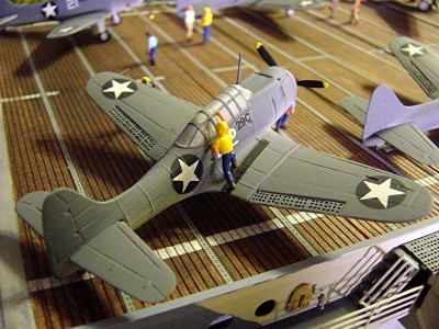

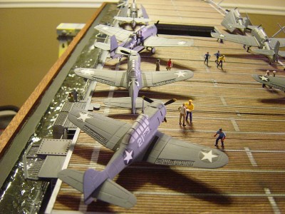

Here's one of the SBD dive bombers. All the aircraft are resin kits from JR Haynes from the UK. There are 9 -10 pieces in the kits and consist of some cast metal parts such as the props, landing gear and the cowling. It also comes with the national insignia. I added the radio antenna, pitot tube, and some bombs and bomb racks under the wings. I have also drilled out the dive flaps.
A view looking fwd. from portside. The figures add another dimension to the model, I feel.

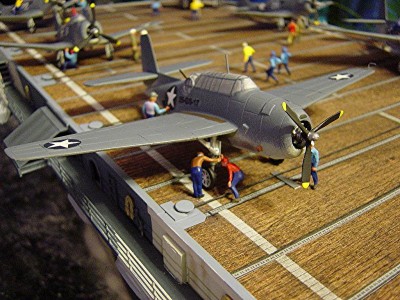

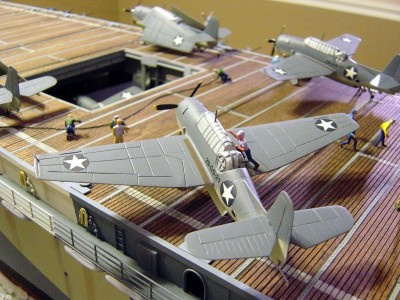

One of the torpedo bombers, TBF Avengers. Again, I added a few small details to the planes.
An overhead view of the TBF. I made the black squadron codes with some inkjet decal paper, my PC and printer.
