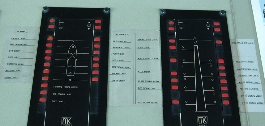

I'm onboard at the moment and I thought I'd share something about these signals with you guys. Here is a picture of the normal light arrangements on a ship. Showing the Christmas tree on the right and the regular navigation lights on the left. N.U.C means "Not Under Command" (when your rudder or engine are broken). Red Flashing Light is only used for dangerous cargo in Japan. The regular Red light, which is switched on in this case, is a dangerous cargo light in the rest of the world (Bravo/Red flag during day time)
For the rest you can see the two anchor lights switched on, as we are at anchor at the moment. Most of these lights can be found on all ships, including warships.

They are actual replacements for each other. The navigation lights should be carried from dusk till dawn, while the daymarks are carried from dawn till dusk. For example the anchoring case, you won't spot any white light during the day, instead, the black ball, which is much more contrasting with any other colors, is used during the day. During night you won't spot any balls, so a light or two (depending on length) is replacing it (daylight, irrespective of length is only 1 ball).
There is not always such a logic in it. Two red lights, not under command, is replaced by two black balls. Sounds logical, three red lights, vessel constrained by draught, is represented by a black cilinder... Where's the logics there?
There are a couple of other cases where the daymarks differ from lights, so practically you really have to learn them case by case.
For warships however you'll get far enough with the basic anchor ball and restricted in ability to manoeuvre. Towing, fishing and others aren't quite important.
Another well known, more in mine clearance operations is the blue-white Alpha flag, which indicates that the vessel or boat has a diver in the water.
