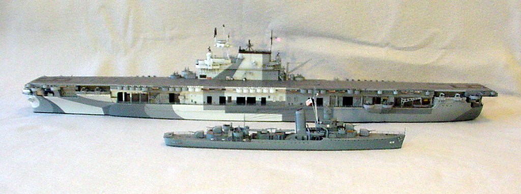

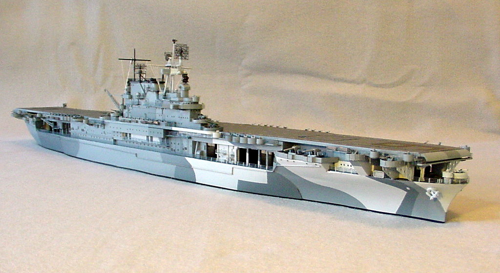

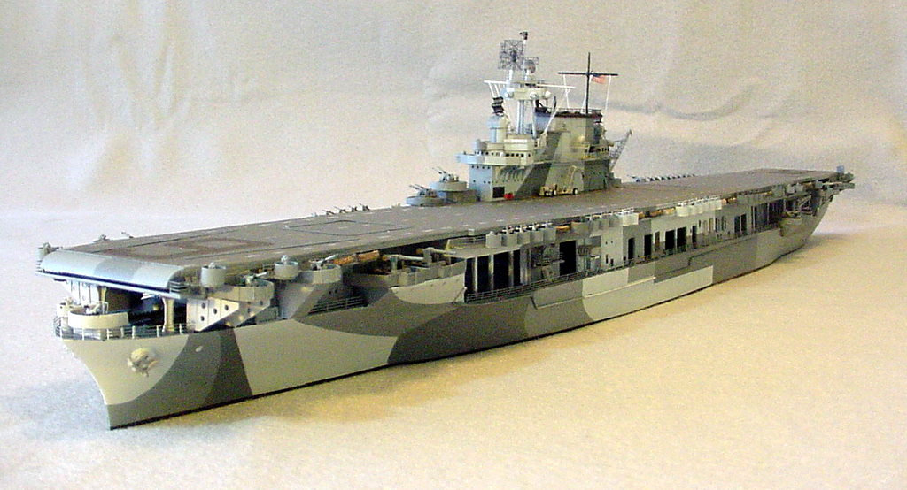

In December of 2005 I posted on page 1 my intent to do a 1944 Enterprise. It is now almost March 2008 and am finally done with the ship (still no planes). A little history of the build is in the "picture post" area. Here are some pictures.
Jim
Jim

She's awesome, Jim!
Great job!
I hope the BWN model sitting in my stash turns out half as well....I already know they hull won't!
Bob
