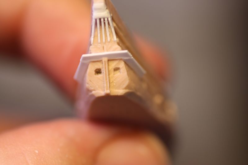

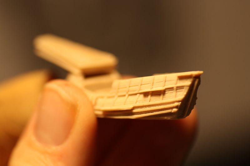

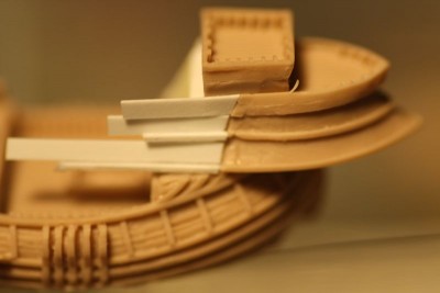

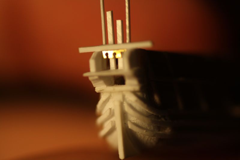

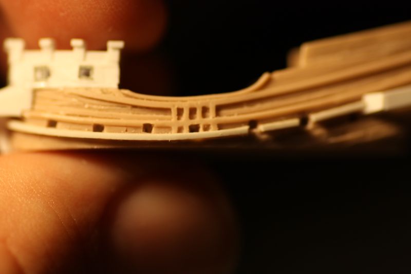

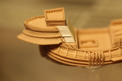

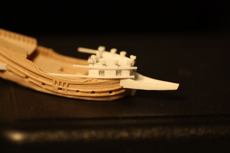

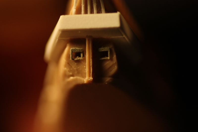

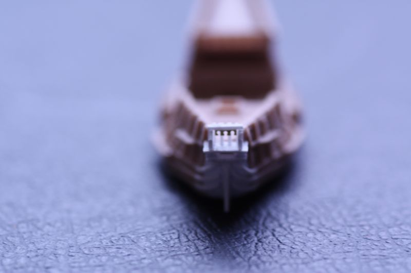

Gun ports! Raison d'Etre of the Galleon...
In my research I have read that the reason for the transom stern was to facilitate the creation of rearward facing gun ports, which seems to make sense. It explains, among other things, why the stern of the 14th Century Flemish Carrack has a 'round tuck' (not a transom) and why the Mary Rose, et al. does. But it also means that any ship with a transom stern in this era probably ought to have gun ports there as well...
Completing the stern gallery...
The lower wales took a beating as I attempted to create a gun deck in the resin hull. It was necessary to re-face it with strip.
Trimming smooth the amidship 'bumpers' since these do not seem to be a feature of the Galleon type. Not sure what to do with the detail remaining between the wales. Trimming it out would leave a 'blank' spot in the planking...
A bit of spare photo etch from an old obsolete Eduard set helps to face the gun ports....

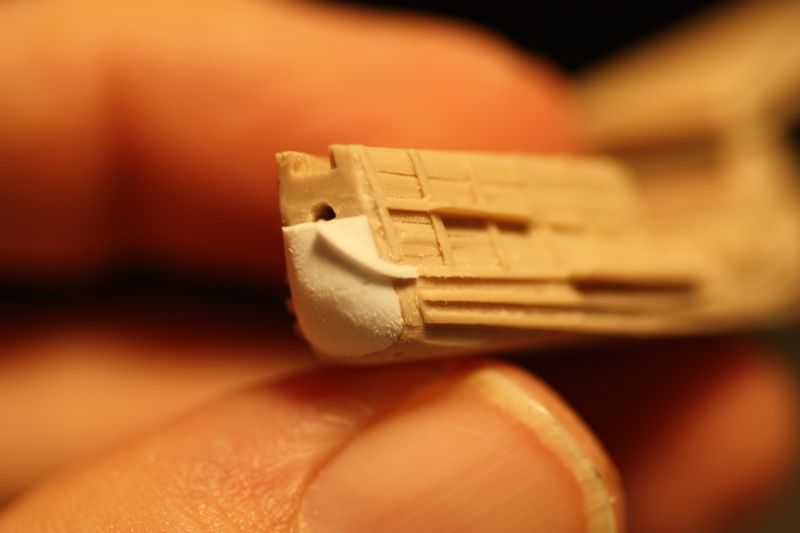

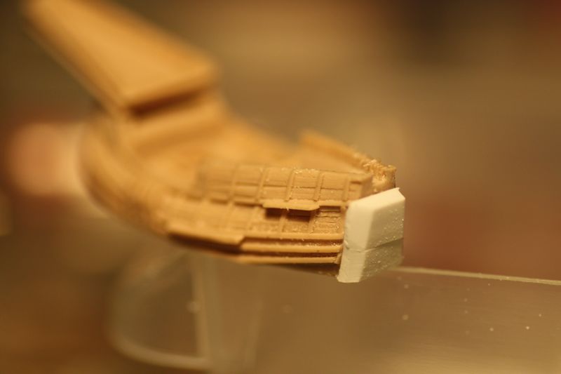

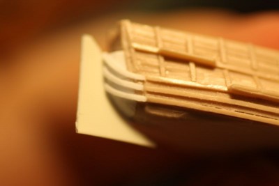

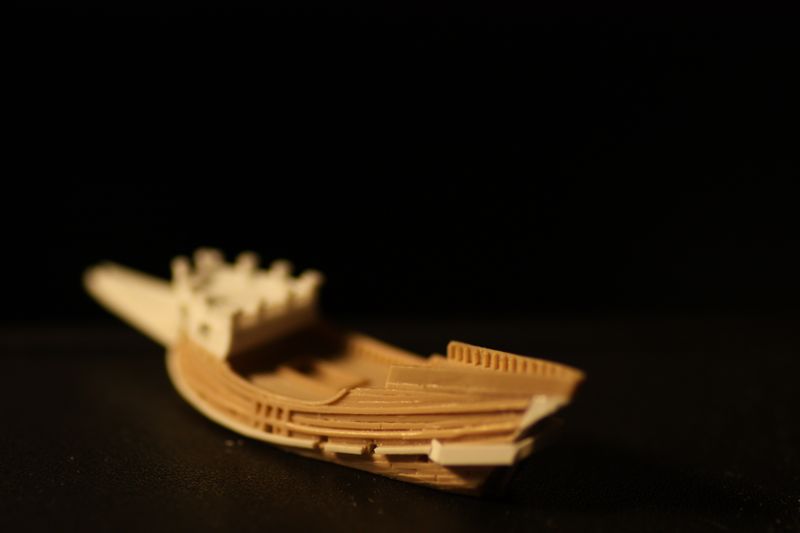

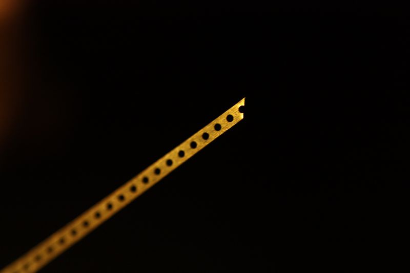

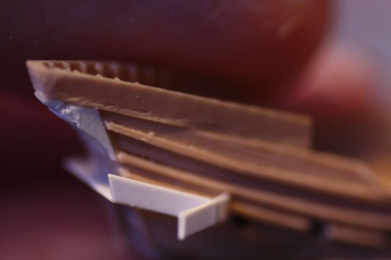

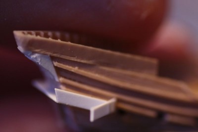

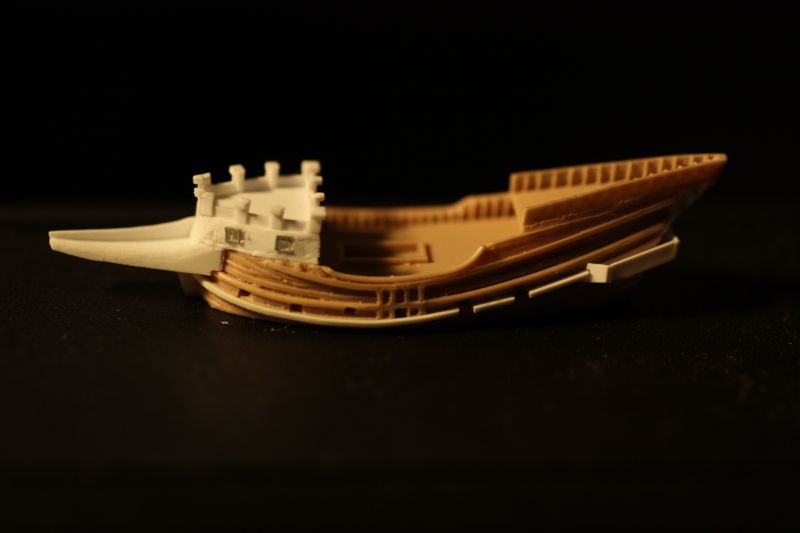

But how does one create those lovely carved supports underneath the stern gallery? I got to thinking about some of the photo etch I had collected modeling 20th century warships... Lion Roar has a nice set of IJN 'perforated bar.' I got to looking at it...
Creating a wedge from this bar with a diagonal cut through the hole resulted in a somewhat 'ornate' looking support structure. I was quite excited about this at the time, but realized later it would be better to remove these before priming and painting and install them later....
I had reached the point now where I had 10 or so builds to prime and paint, including the Galleon. But some of them still needed work. The 'Maxed Out' Carrack needed some facing... Tedious and un-fun work.

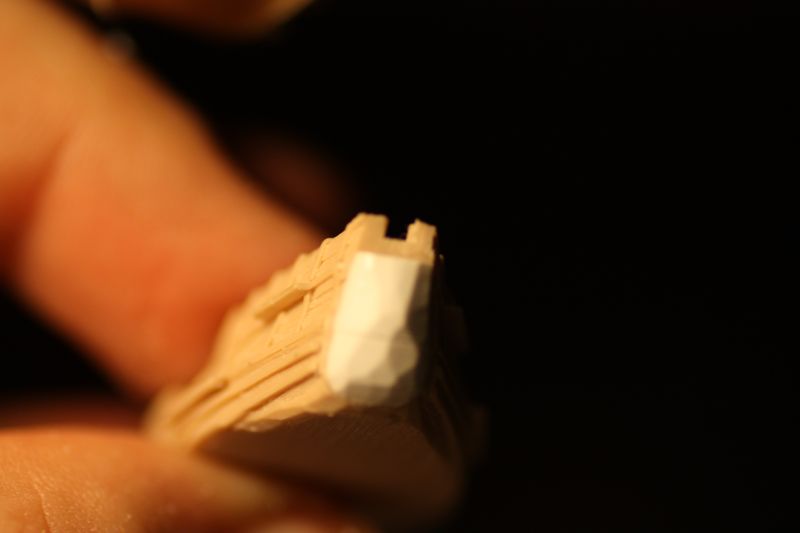

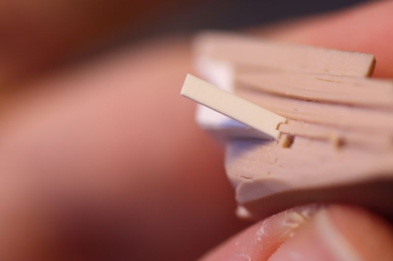

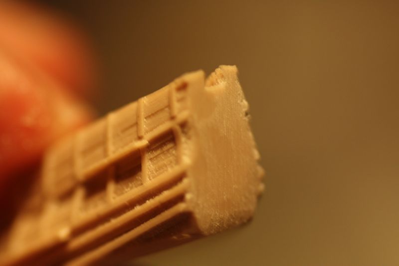

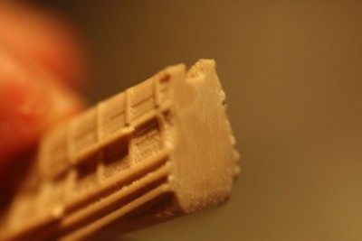

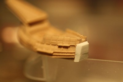

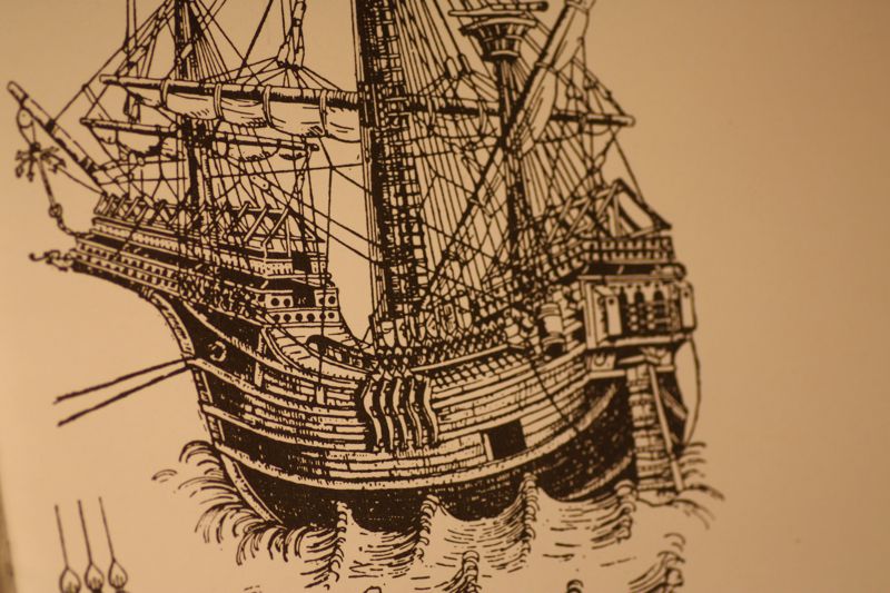

What to do about the transom stern on my Flemish Carrack? This one is supposed to be mid-to late 15th Century (before heavy cannons and gun ports) and I had just finished putting gun ports in the transom of the galleon. If I'm honest, a Medieval Carrack really ought to have a round stern, not a transom...
Well... let's get to it then. Not going to be fun. To be honest, I wasn't even sure if I could pull it off...
First thing, sand it flat, easier that way.
Build up material for the rounded shape...
Start shaping...

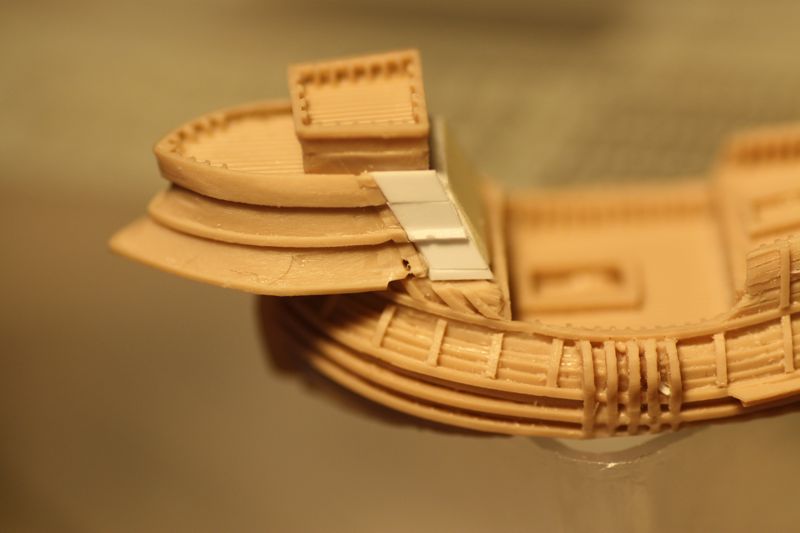

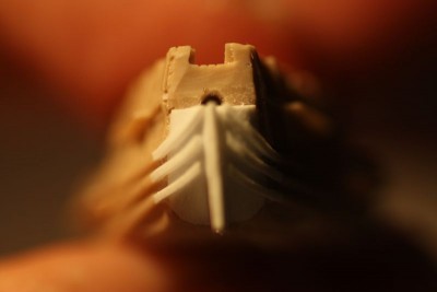

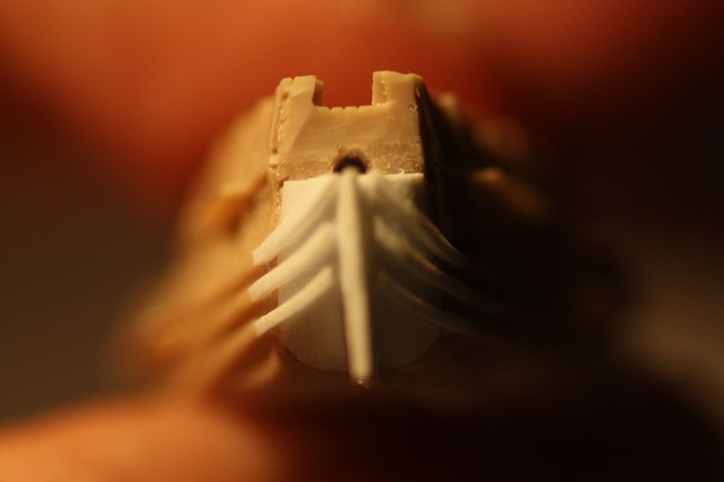

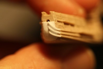

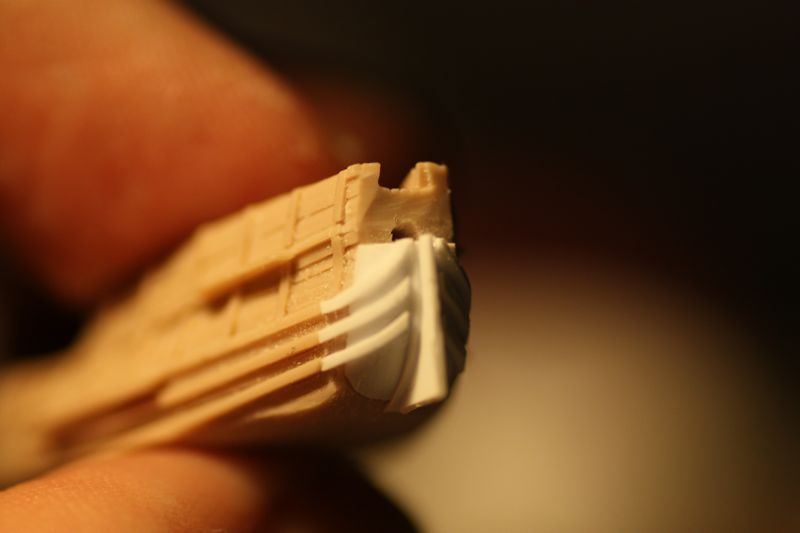

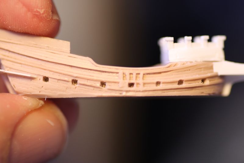

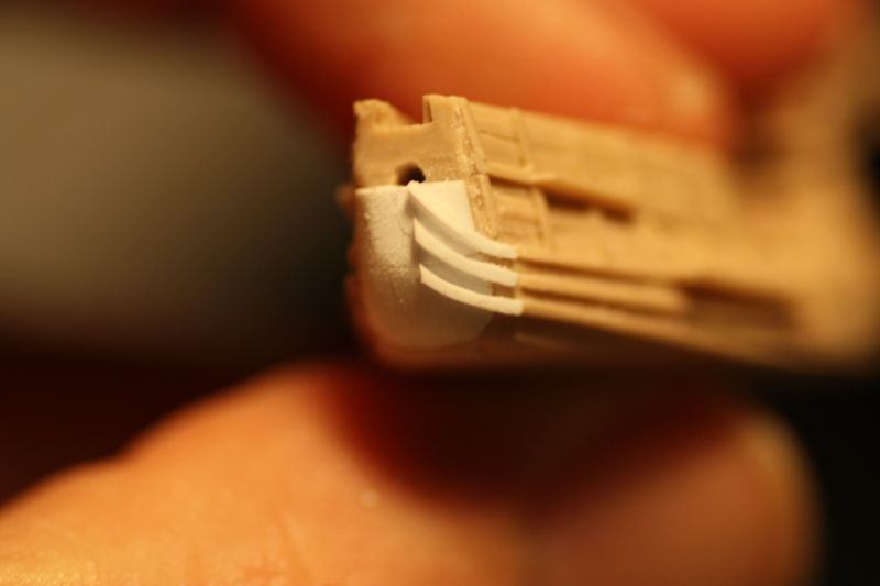

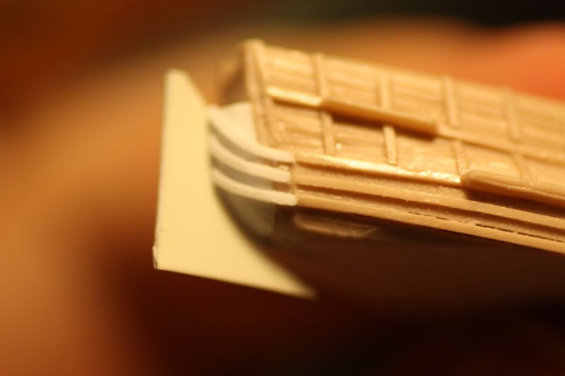

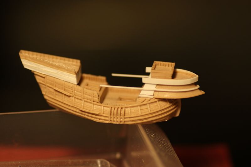

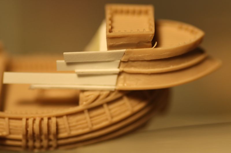

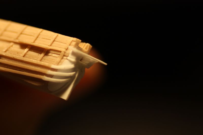

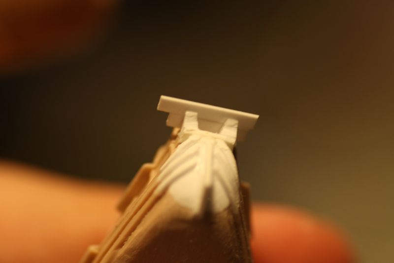

Tricky, getting those wales to tuck up round the stern post. Involves a compound arc in the rod. Fortunately using square rod helps you to bend neatly in different planes. I've tried to do this in the past with round rod and had 0% success rate. :heh: The real trick will be getting both sides to look uNiFoRm :heh:
Sternpost roughed in. Carving the inside curve to match the curve of the new stern took quite a bit of testing and sanding. It took me two attempts before I got it right...
Coming together... Shaping the wales was not as hard as I thought it would be. I'm learning most things in modeling are that way.

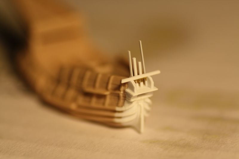

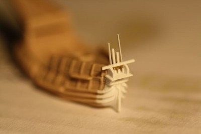

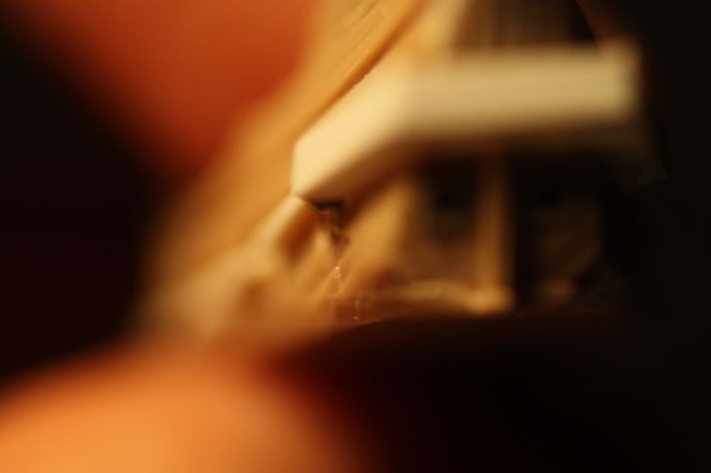

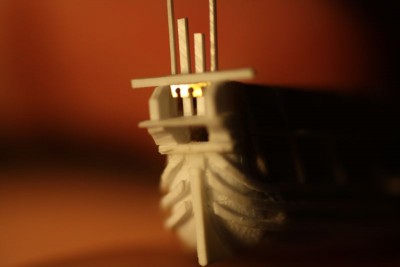

Can we try to create that odd stern walk on the back of that ship?
Cut out perforated bar to make arches instead of holes, and use that for the entrance from the poop deck...
I suddenly wished I had not done this. The gold color of the unpainted brass looked perfect as an accent at the top of the pillars...
The Rudder will be created separately and attached to the stern post after the hull is painted. The tiller will be inserted through the round port below the walk, similar to the engraving. The results are not exactly as depicted, but similar, and hopefully plausible. One of the fun things about modeling these ships is that you have the freedom to try things and experiment a little bit. You have some leeway to be creative, but, on the other hand, you can never be certain about the accuracy of your efforts.
That's all I've got for now. Let me know what you think.

Excellent work Callen
You really make those small vessels look huge!!
The perfection of the portholes says it all! :)
Oh, and a tip for cuts: use CA Glue to fix it - just put the skin "aligned" and use it, trying to keep the glue outside the cut
(remember that CA Glue was created for this purpose!)

Thanks Rui! Much appreciated. :thumbs_up_1:
BTW you should know I have been talking to Filipe, and looking up the published builds by you and by him, both here and elsewhere. I was completely blown away by the quality of the builds I saw. You are both really terrific modelers, I have to say. Really first rate. :thumbs_up_1: I'm not surprised your stuff gets featured in museums. I don't know how many modelers there are in Portugal, but from what I've seen so far, it looks like there's a pretty strong scene there. I'm very impressed. :cool_1:
About the glue, my wife has been telling me the same thing. I use CA for everything else, I might as well try it for this too. I'm going to have to too, because I've got a gig Saturday and I won't be able to play if my finger opens up and bleeds all over the place... :Mad_6:

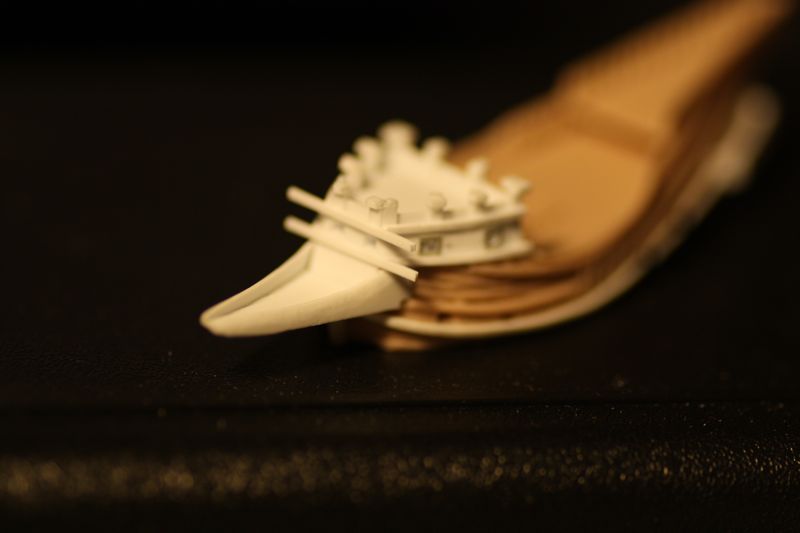

Your speed of building is frightening ;)
The stern of the galleon looks right to me, I am not sure about the proportions of the bow.

Somebody else said I built fast, but you have to remember these hulls are around an inch long before adding the superstructures... It doesn't take long. :big_grin:
maxim wrote:The stern of the galleon looks right to me, I am not sure about the proportions of the bow.
What do you think Lars? Too little freeboard? Too long a beak? Too high a forecastle? I justified this build to myself because I had gotten the impression that at the beginning of the Galleon Era people were cutting down carracks and converting them to Galleons. My worry is that she's too fat for a proper galleon, but then I see these De Vroom paintings of these Spanish ships that make me think there were some fairly tubby galleons out there, particularly early on. I eventually want to create a proper galleon master, but I thought I'd go ahead and try this for starters just to see. Jean and Bruno are both big galleon fans and are wanting a couple of galleon masters this year, so this is 'practice' for that.

I am not sure. It could be a combination of too low freebord and too long head.
Your assumption that early galleons are similar to carracks is probably valid, especially for bigger galleons (not the smaller English galleons optimised for speed).

Thanks for the Mary Rose pic. I am planning on doing her in a big way, not just in 700th scale but probably in a large scale at some point, 1/72 or 1/192, and probably more than once, as I have a number of friends interested in her, not the least of which is the Mary Rose Trust in Portsmouth England...(It's a long story, has to do with music.)
But, you know, she deserves her own thread :thumbs_up_1: so you won't see any of that here. :cool_1:
Thanks for posting! I'll have more on the carracks soon.:woo_hoo:
