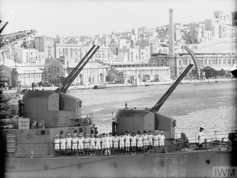

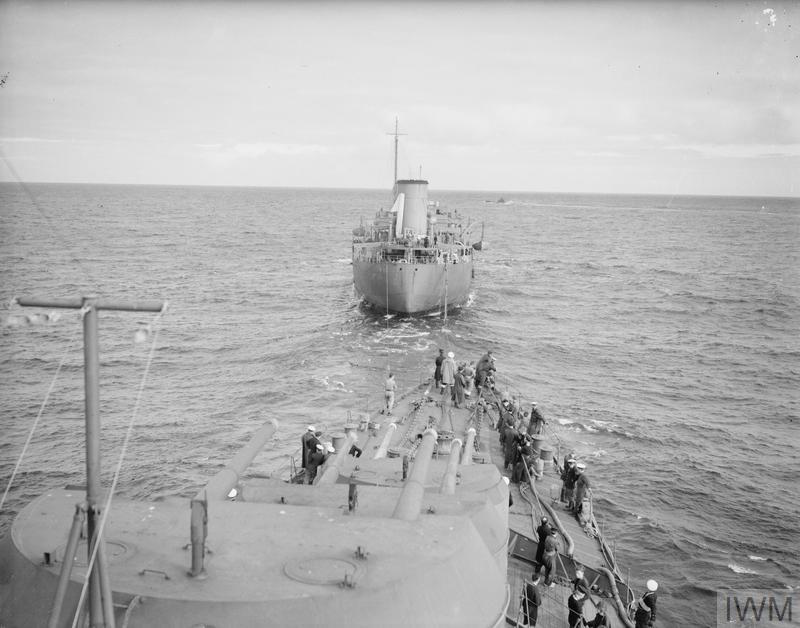

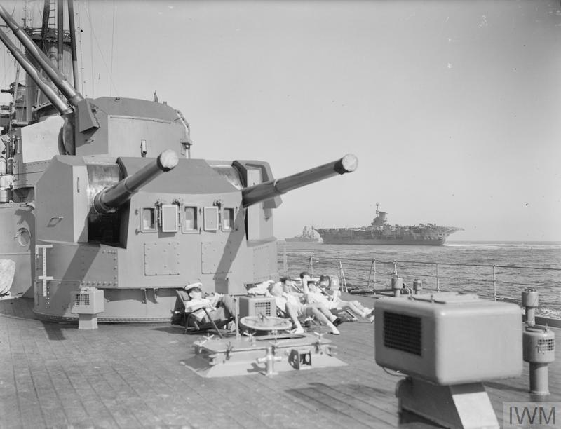

Thinking of building hms Hermione, Rodney and ark royal in the Mediterranean (op halberd?). Hermione generally described as overall medium grey. However some pics from iwm suggest top of guns & ? Top Turrets a darker grey - what do others think? Maybe 507a? It�s pretty convincing on some, but less so in other pics - ? maybe brighter sun so in some pics it looks same colour even though darker paint?
Cheers for any input

The first pic clearly shows a wavy pattern over the gun barrels, so there is certainly a light/dark scheme applied. The paint on the top of the A-turret even looks a bit weared-down. In the third pic you can actually see that the darker paint is not added exactly ending on the top with tiny bits on the vertical surface.

Thanks ej.
That was my impression too. One more question... Any thoughts on x turret in picture 2. Do you think that vertical surface with the sticky out bit on (rear starboard aspect if turret was in neutral rear facing position) is also darker grey or a trick of the light due to the differing angle meaning it looks the same shade as the turret roof/angle? I suspect its just a trick of light looking at y turret below but not sure.

For X-turret it's tricky but I'd say darker. For Y-turret I see no large difference between the turret roof or this particular cover and it appears to transfer to the near-vertical surface. I would go for dark.

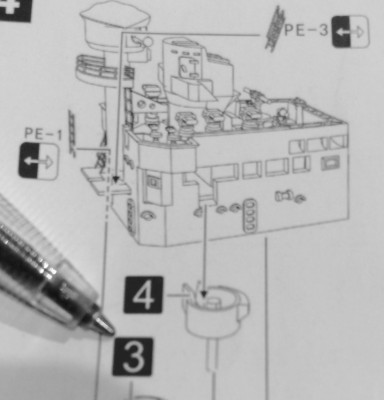

Still slowly building hms hermione under air attack in med (flyhawk naiad). What equipment is in the tubs at gallery level on bridge? It�s numbered 3&4 on pic of instructions. Have had fun working out what all the other bridge equipment was (thank you ej foeth in the slipway blog for all the pics!) but not sure what is in these tubs. On John Haynes blog of his model of euryalus (later war fit with oerlikons) it looks like maybe a director (see pic) but not sure this was on hermione in mid �41 ib the med.

From what footage I have of various Dido's these tubs contain pompom directors (as on the John Haynes model) or 20mm guns. When a 20mm gun was placed in the tub you'd typically see a guard rail. Many Didos had the pompom directors either moved to, or already as fitted out, in tubs midships near the quad pompoms, after this move the tub on the bridge is not always present anymore (configurations vary between ships; you'd find the 20mm gun there if the tub is still there and some ships never had this tub to start with). If I look at pics of Hermione from 1941 I do not see these midship tubs near the pompoms so my guess would be that the bridge tub indeed has a pompom director. HMS Euryalus definitely had a pompom director there.

Fantastic! Thanks ej. Will scratch a mark ii pompom director for them (thanks for pics of this on your on the slipway blog too!)
