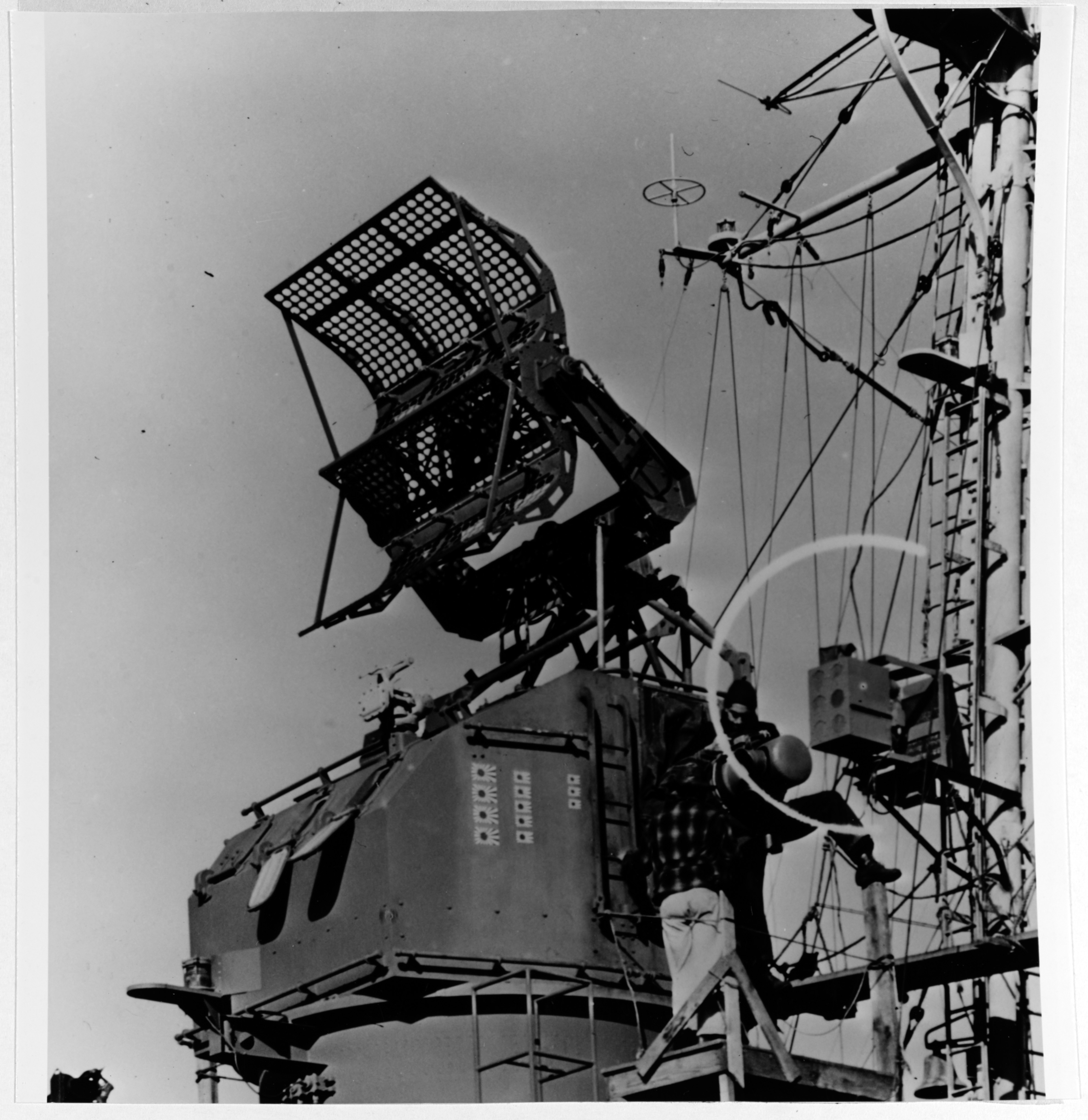

Secondly, I don�t know the exact names of the boxy installations shown in the images below. Here�s a view of Woodworth�s Mk37 director(on 16 June 1944), which I referred to is circled in the center.
Another one is something similar on McCalla�s foremast, January 5 1944� also been circled.

First off, the "boxy" device with six portals are called "reproducers", a fancy name for loudspeaker. They were installed to be "louder" than the previous standard horn speaker. This came in useful for underway replenishment and for communicating with small craft during amphibious operations.

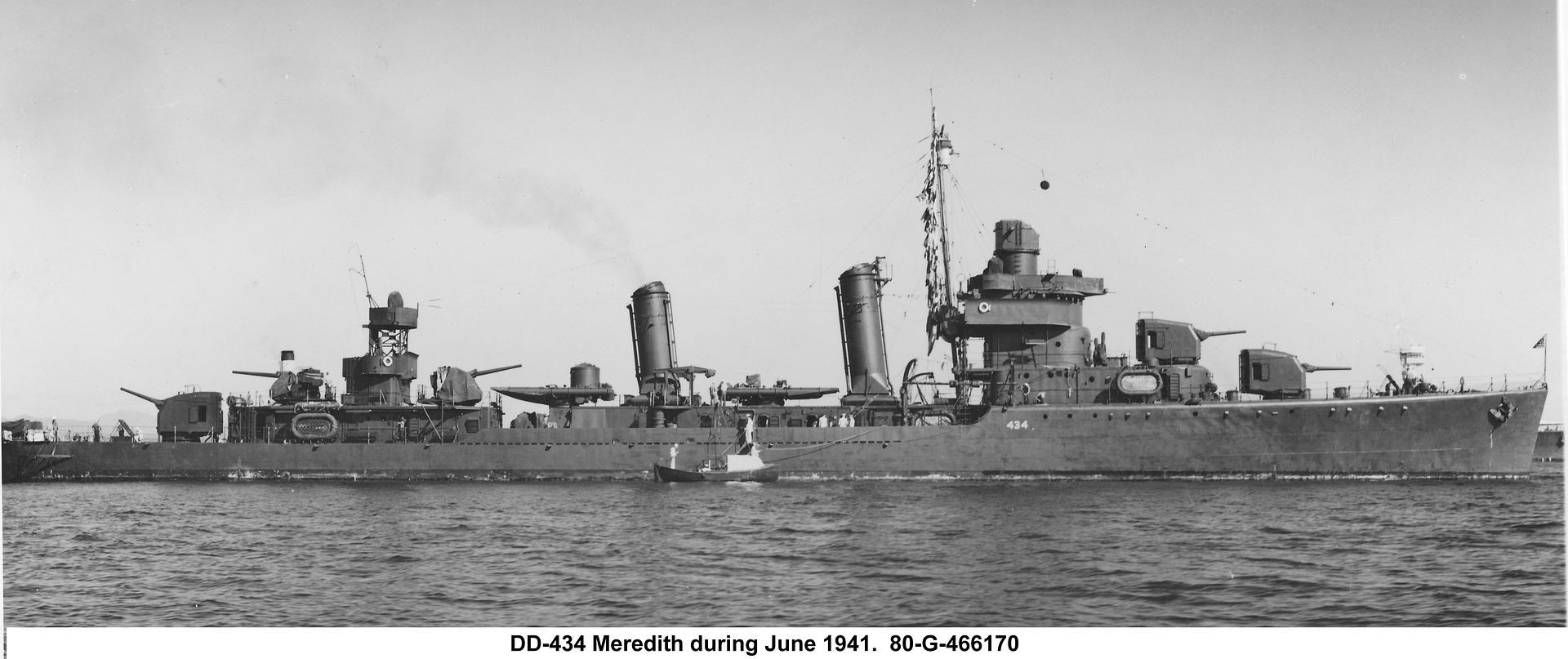

I am planning on using the Black Cat open Mk30s on my pre war Benson. Should the fuze setter be present or did mount 53 and 54 have setters integral to the hoists?

I'm not sure I can answer your question. I don't have time to hunt for a close-up image of a Mk 30 5-in/38 open mount. But here is a rare view of an early BENSON-GLEAVES unit without a canvas cover completely covering the open mounts. Full frame with date and info and a close crop view.

Thanks, Rick. That's exactly what I needed. No fuze setter on the mount.
