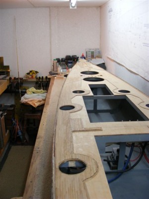

HI All
I am sorry for not posting more often.
I have been very busy with work and with Bismarck.

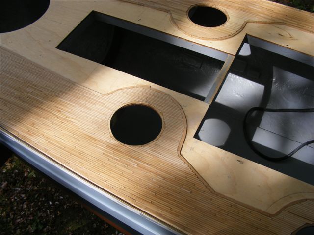

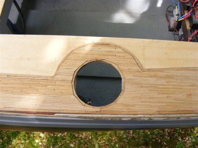

I started work on the deck planking about a year ago now and are getting towards the end.
I have spent almost every hour when at home working on the deck, around 12-14 hrs a day..
The planks are 2mm wide and 60mm long.
The ship is 222 planks wide by approx 3.5 metres long.
These planks are "Joggled" in at each end so you may realise the amount of work in the deck.
The photos attached are the deck in the "Rough" and under all that with a bit of luck should be a fairly good deck.

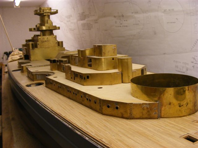

Re: 1/72 Bismarck
Now that everything is slowly coming together, the sheer hard work is shining through, the decking is 1st class, and I wouldn't mind that in my living room, the superstructure is now appeared and looking like a battleship being built (like the real thing) outstanding work

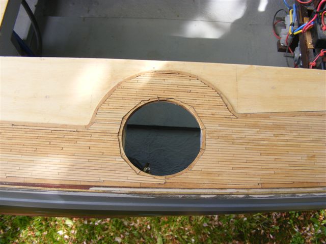

Hi Mick
It is not like down home and the sun is not an enemy.
When I plane it down to height and shape etc, I will give it 2 coats of clear Shellac or clear Eurathane.
It will be well thinned out so as not to put any visible build up on the surface.
The appearance will be matt.
I will not alter the colour at all ............... Keith Jewell (Modelling Timbers) very kindly, has given me a very good assortment of coloured woods to give a more realistic effect.
I am lucky with Bismarck as there were not any visible means of holding the planks to the deck apparent so there will not be a build up of Shelac in these areas.
Regards

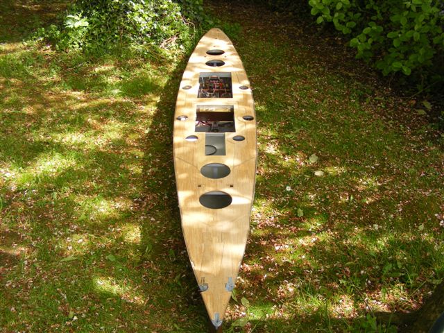

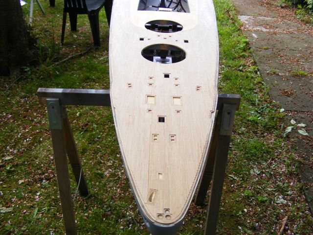

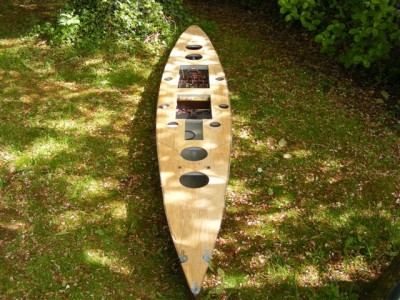

Re: 1/72 Bismarck
Good morning All

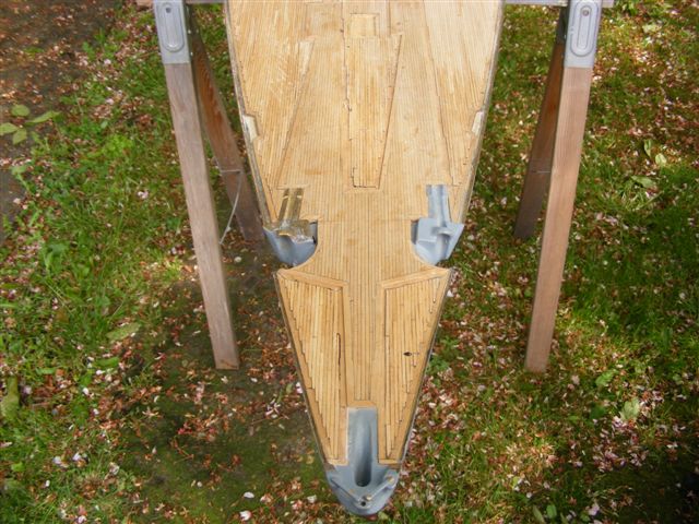

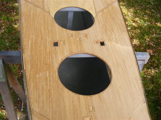

I have taken a few shots of the deck.
The planks are 1.8mm wide by a max. of 60mm long. This gives the approximate sizes I have calculated from photos.
There are thousands of them. They are joggled into position.
All lines of deck start with a joggling and end with a joggling.
(A joggling is a term used by many to describe the act of cutting chamfer into the plank as well as the margin plank to make a perect join.)
This was done to stop the planks twisting if the angle of cut is too great. Cut off point is around 45 degrees.
anyway that is 18 months work.
Full time it equivalates to around 9 months of full time work 10 hour days ......... 7 days a week. (Christmas day off!)
