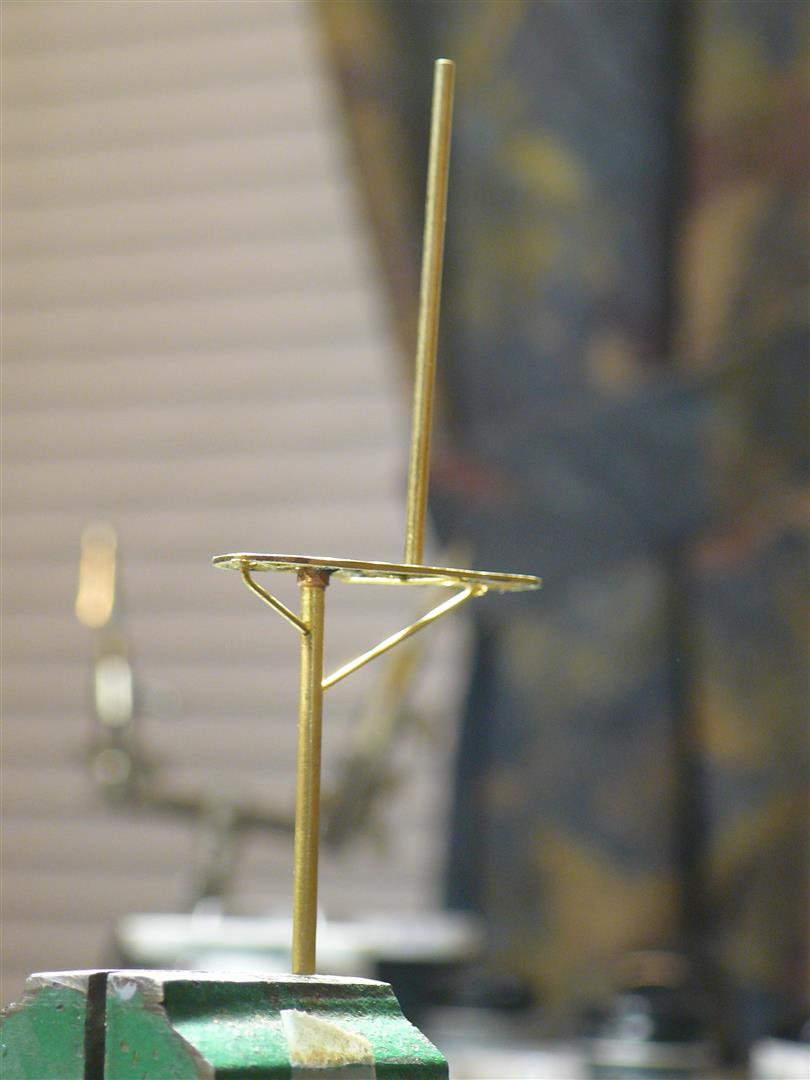

Update � 03/28/14
Well, Murphy�s Law bit me on the ass big-time Wednesday night. Somehow I managed to topple the superstructure & foremast from the model to the floor and the damage to the foremast is almost non-repairable. The superstructure only had a minor injury overall and that�s been repaired. It will require some touchup painting, but that was going to take place anyway a couple nights from now.
Bottom line, I�ve started to build a NEW Foremast. Rather than repair the existing one, I�ve decided to go from scratch once again. Only, this time the platforms will be made from brass bar, rod, and PE, rather than solid styrene, and will incorporate PE grating which is closer to the actual masts than my solid styrene plastic ones were.
So, I�ve already soldered together the framework of the lowest platform and have sized and cut the upper and lower masts from brass tube. These will be drilled for the various support legs rather than depend on cryo to hold everything together.
Since I may not have PE grating that is large enough, I may have to make the platforms out of various pieces cut to size. Since there is grating available for the WWII inflatable raft baskets which won�t be used on the model, I will have enough to complete the 3 platforms I need. I hope to be able to salvage the various radars on the damaged mast rather than making all of those again.
Today�s photos show the 1st platform frame w/the lower and upper masts in place. It looks nasty now, but when painted I think will be better the 2nd time around. I�ve also taken time to ensure that the support legs are as close as possible to the actual mast � something many photos I have for reference are still hard to decipher since very few photos are close ups from different angles of the mast. One most helpful is actually one I took in 1969 looking up at the mast from the port 03 level. This photo shows the various platfoms on the mast and their grating, as well as positions of the yardarm and it�s components. I should have a new order of 1/32" sq. brass rod by next weekend, so I'll work on the lowest platform this week and getting the masts prepared when I am able to complete the other 2 platforms.

The platform looks especially nice! On mine I used a fabric ribbon net which I stiffened with paint that looks pretty convincingly see through. Sorry to hear about your mishap, but as often happens the second version is better!

Thanks, Tom for the support. I think the floater net grating will work. The difficult part is that there is an opening next to the mast pole thru the platform, but even my photo from below doesn't show this clearly, so I'm going to have to review other mast platforms if I can find them and see what's the common practice - I think it's a circular opening.
