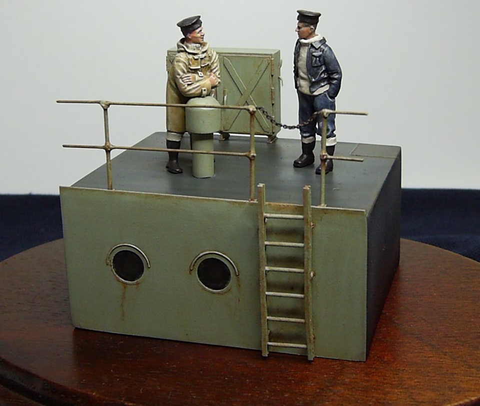

Although not plastic or resin these white metal figures are very easy to work with.
They need work to convert but are another option

Thanks Roy
These are nice figures and are modelled in a quite "human" pose. Some cheap figures tend to look like they have been run over by a steam roller, possibly as this makes them easier to mass produce.
I shall have to try hard to get my figures to look as good as this.
