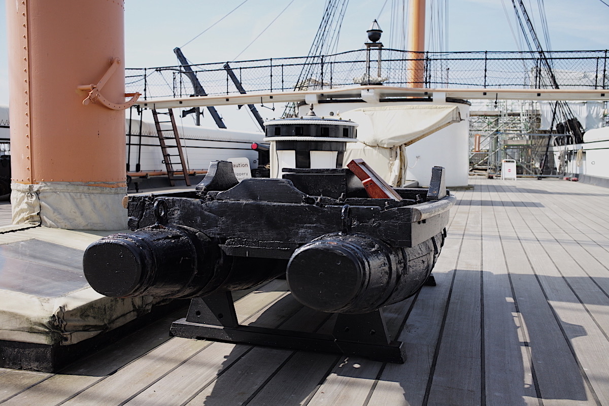

Re: WEM H.M.S. Barham 25.11.1941.
Posted: Fri Jul 05, 2019 4:57 pm
by Bill Livingston
"An example of a copper punt can be seen on board HMS Warrior in Portsmouth".
Exactly... here are a couple of pictures of it...

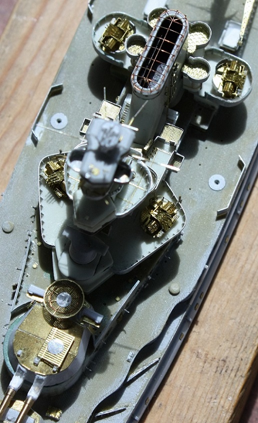

Posted: Sun Nov 10, 2019 12:21 pm
by zs180
The machine gun platforms on the main turrets were scratchbuilt using PE mesh and lead foil. I deviated from the plans inasmuch as I altered the shape of the lower platform on turret B with reference to a photograph which shows it to be rectangular rather than circular. A very nice PE catapult (for turret X) was provided in the WEM kit which was a joy to assemble.
In the last three pictures the result of much work can be seen: hundreds of tiny bits awaiting painting.

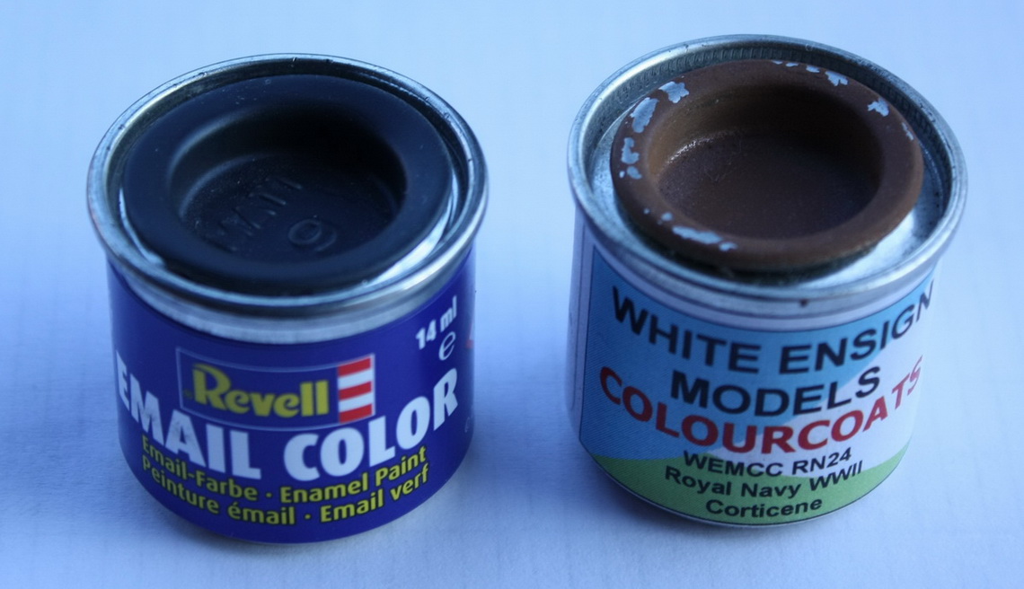

Posted: Wed Nov 27, 2019 9:00 am
by zs180
I have started painting of the model at last. First I disassembled the dry-fitted bridge structure. I prefer to use enamel paints. First to be applied was Revell 9 Anthracite Grey. I do not paint anything pure black with regard to the scale effect. The boot topping was sprayed first� because of the bulges it is almost impossible to mask it from the top and get a straight line, so I will mask the boot topping instead. A section of the mainmast and the funnel cap were painted this colour as well. Next the decks of the signal platform, the compass platform, the admiral�s platform, the air defense platform and the 15� gun director platform were sprayed a lightened WEM Corticene.
After a light wash I carefully scraped paint off the the previously attached PE tie-down strips giving a nice contrast.
. I painted steel decks WEM 507A, lightened with some Revell 35 Matt Flesh. The first real challenge in the painting process was getting the teak cover of the forecastle and quarterdeck right. I attempted to achieve a darker shade than usually for two reasons: first, to my knowledge wood decks were no longer holystoned in wartime, second, in the well-known original footage showing the ship�s demise the deck of the capsizing ship seems very dark compared to the colours of the camouflage. I mixed roughly equal quantities of WEM Teak and MOLAK 194-M Brown Yellow (a vintage tin of at least twenty years of age) and covered the wooden deck with it.
I then picked out several planks with lighter, paler and darker variations of the original deck colour, at first masked and airbrushed, then freehand with a fine brush.

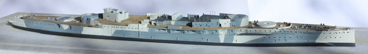

Posted: Wed Jan 01, 2020 6:06 pm
by zs180
Some progress has been made, here is the report.
Deck fittings had been painted by hand and after a very tedious deck masking procedure
the camoulflage colour of WEM 507C (very slightly lightened with Revell white) was sprayed on the vertical sufaces. All the previously prepared other parts such as the individual bridge leves, funnel, gun turres, boats, etc. have also been painted this way.
The WEM camouflage colours used:
Next, after some additional masking I applied the darker camouflage colour, WEM 507B (minimally desaturated with Revell flesh colour), the shade of which is now believed to be an equal mix of 507A and C, and the colour so far designated 507B is equivalent to 507A. Numerous corrections have proved to be necessary to obtain an acceptable degree of aligment of the camouflage panels on the individual structures of the ship, e.g. hull, barbette, gun turret. In defining the exact panel layout I relied on the WaveLine instructions which, confirmed by original photographs, seem fairly accurate, while the coloured illustration shown in the Profile Morskie monograph has numerous minor inaccuracies, yet it is copied in a number of other publications, Trumpeter�s own instructions being one of them. There was another tough call: I decided not to carry the boot topping to the upper end of the bulge although it was this high in 1941, because it would have been impossible to produce a horizontal line, the bulge of the model being non-straight and too large � a flaw that I recognised late in the build and would have been almost impossible to remedy anyway.
Now, with the painting process practically finished I am looking forward to what comes next: applying washes, enhancing contrasts and weathering.
