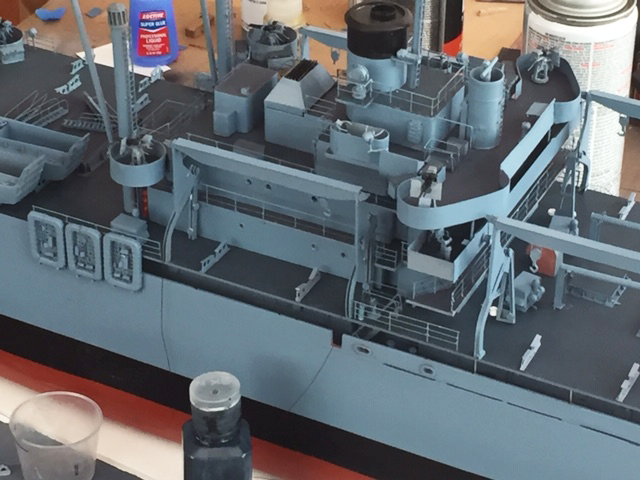

Re: APA project
Current progress: Added side arched bulkheads below the bridge wings, some Davit supports, more rafts. The wooden small dowel is just to hold the Davit legs in place before glueing. Pilot house and upper deck/stack will sit on top here, note locating blocks.
The angled racks for rafts behind the bridge wings were constructed from photos kindly supplied by Noel Paris.

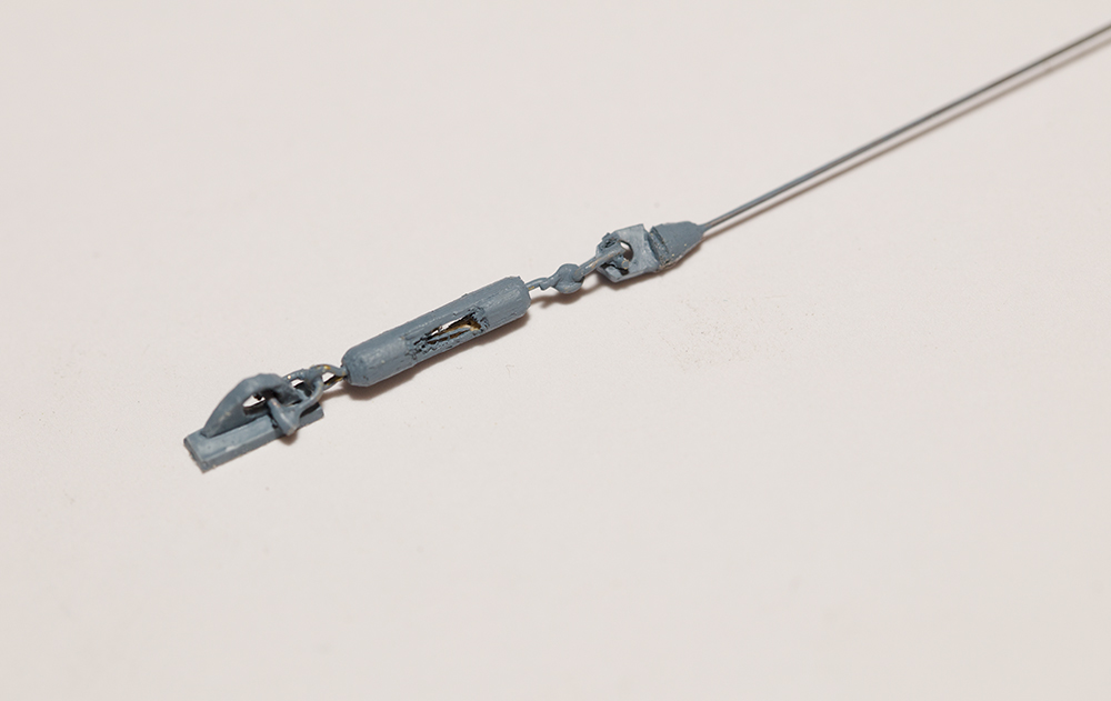

These are fairly small, a pad eye to attach a main mast/Kingpost to the deck, with shackles, and turnbuckle. The main mast has as far as I can tell eight guys. Some ships maybe had more (10) or fewer.
