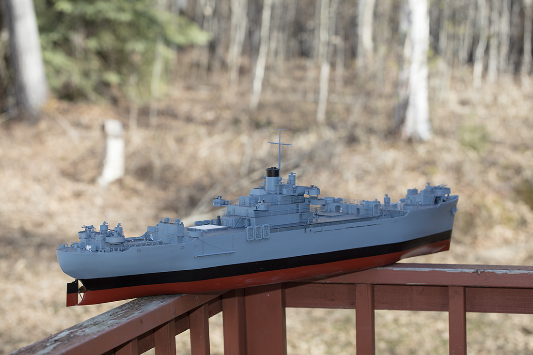

Rudder, stern post and prop added. APA clutter not onboard at the moment.

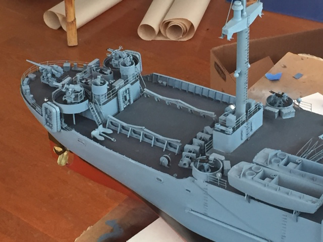

See the empty spaces abeam hatch five? Space to fill up with fueling hoses and 2 50' LCM's
A lot to do here, everything still stacked loosely in place awaiting some decisions on when to rig and what's in the way currently.

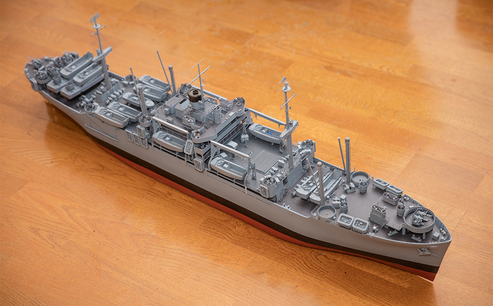

View from about 650' (scale) feet. One can see how the ship starts to disappear under a pile of boats and whatnot. For full LCVP compliment I would need another six boats! Most of the stuff is just piled on there for now, but you get the idea.
