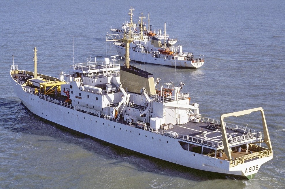

Maybe a bit late, but I would like to share a thought on the colour yellow you have used on the inside of the bulwarks. As the ship looks today, your paint choice matches perfectly. However, I'm inclined to think that in the past the yellow colour used on (Dutch) navy ships was not the golden rich yellow you have used, but a more white-ish yellow, also seen on utilitarian vessels like tugs and fishermen of the period.
To illustrate the point, included here two photos of Hr.Ms. Luymes A902 and Snellius A907, two of the last hydrographic vessels in the traditional colours. The yellow used on this is I believe a good example.
Also this painting of Hydrograaf seems to point into that direction, even exaggerated, but that's of course subject to the interpretation of the artist:
This picture of the even newer Buyskes, Blommendal and Tydeman illustrate the point even more:
Humbrol 74 would have been a good choice, but you may be of course of different view.
