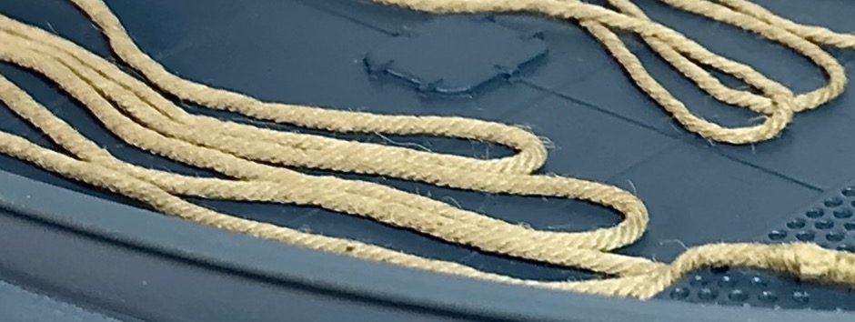

One final question, tell me about the making of the faked down towing hawser?
- Iceman 29
- Posts: 1945
- Location: Bretagne, France
Re: TugBoat USS Nokomis (YT-142) Woban Class 1:350 & 1:100 -
For the ageing, I forced the dose a little, because I think that in normal times, these tugs were well maintained in terms of paint, although if you look at the picture of Life above, it is not so obvious when you look at it in detail.Memories from over half a century ago are sometimes in error, but I don't remember any rust or other staining anywhere on superstructure or hull. The crews took a lot of pride in their little charges and they were petty shipshape, even with a lot of white cord fancywork on rails etc. Perhaps being resident in a shipyard in more or less "peacetime" (Remember that?) allowed for extra attentive upkeep.
Very creditable indeed! Tom
So I forced the point because of the date. This ship just went to put out fires during the attack and afterwards to pump out flooded compartments, all this in the atmosphere of soot laden smoke from the fires and sea water with a good layer of heavy fuel oil on the surface because of the stale bunkers of the ships that were hit severely.
I could have even added a black oil border at the waterline, but I didn't.
I limited the aging on the superstructure, less solicited and easier to maintain for the crews in general.
I also liked it clean in its more "traditional" version of the model.
We had to make a choice. The current trend is towards this style, closer to reality. It suits me well.
I used 3 differents size of Occre rope, 0,8 , 0,5, 0,15.Pascal:
https://www.miniplanes.fr/images/thumbn ... -17034.png
For hawsers and towsers, I used this method with Occre's ropes, it works very well.
I burned the strings with a lighter to remove all the little unsightly wires.
https://navi-modelisme-com.translate.go ... r_pto=wapp
It is regrettable that Occre makes its strings in S (not on the left) instead of making them in Z (not on the right) as they should be.
For almost all strings, it's always Z and S for steel strings in real life.
Pascal

Well, yes, there has been quite a discussion about Dirk's research on left-handed hawser-laid rope in our German fora ...
It seems that even museums now prefer polyester thread over the traditional linnen one for rope-making. A brand commonly used on both sides of the Atlantic is G�termann's Mara that is available in many suitable colours and shades.
As it is available only down to a certain size, many people, including myself are using polyester fly-tying threads as starting material for rope-making. My preferred brand is the Danish Veevus two-ply that is available down to size 16/2 in suitable colours.
Polyester has the advantage of being smooth, without fuss and can be tempered to take out the springiness.
Here is my rope-walk for making sub-millimetre ropes, constructed from an inherited 1 metre long optical bench:
https://www.maritima-et-mechanika.org/m ... ewalk.html
With a rope-walk you can also unravel commercial threads/rope and give the correct lay.
