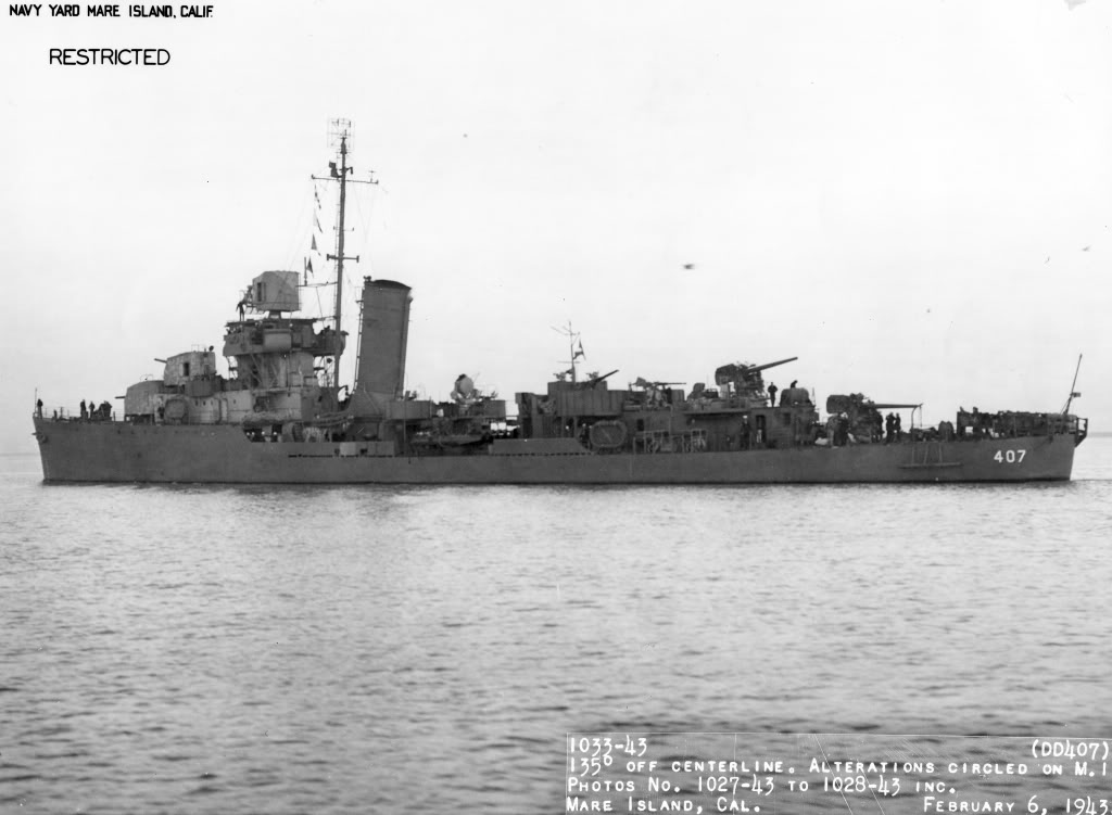

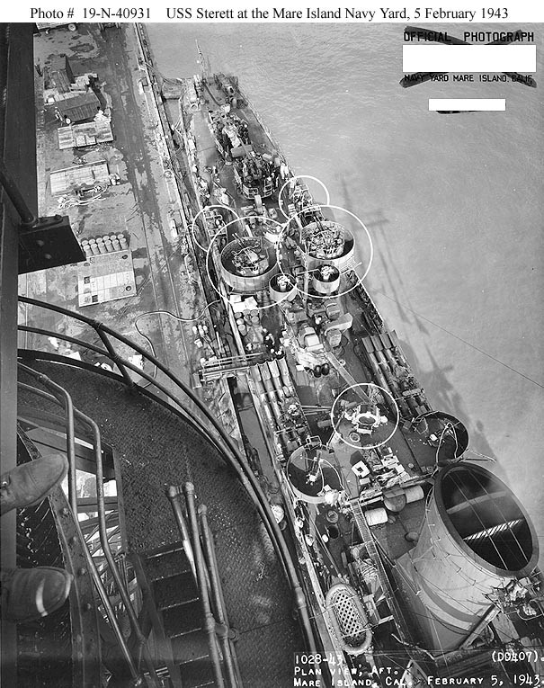

Hello fellow modelers. Just bought the Iron Shipwright USS Ellet with the intent to build the USS Sterett in its 1942 Guadalcanal configuration. After doing more research I have decided to do the Sterett in 1944 configuration with MS 32/11D paint scheme. I read Mr. Frank Fowlers post earlier in this blog on converting the Yankee Modelwork�s Benham to the Sterett. In it he mentions �during the refit in February 1943 the overhead protection was reinstalled since mounts 3 and 4 returned to open mounts�. The kit does not have the overhead protection so I was going to attempt to scratch build it. However, after reviewing all the photos in this blog and other sources it appears the configuration of the protective shield is different than the original layout. In the pictures that Rick Davis posted of the Benham on the first page of this blog the overhead protection looks totally different than what appears in the picture below. I�ve seen this structure in other pictures of the Sterett but none with a clear view of its layout.
Cajuntiger
- Posts: 35
- Joined: Fri Jul 16, 2010 5:02 pm
Re: Calling All 1,500 tonner (USN DD) fans!
Thanks David,
I know that the #3 and #4 guns are open mounts. I did n't make it very clear that what I was referring to is the shield coming out of the aft deck house in the photo below.
Scot
Scot

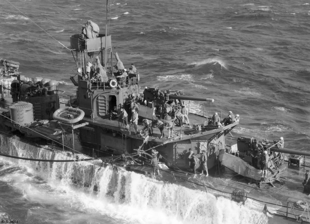

There were 10 ships of the Benham class, and all 10 had the static blast shield you referenced as built. When the war started for the US, 8 of the 10 were in the Atlantic, where the open after guns were prone to icing up in the North Atlantic winters. So all 8 Atlantic units had the after mounts enclosed; #3 had a half shield with a canvas top and #4 had a full shield. The static shield was unnecessary topweight and was removed. The after torpedo tubes were also deleted as weight compensation for the shields and the additional depth charges. The two Pacific units, Benham and Ellet, retained all 4 tube mounts, the open guns aft, and the static shields. In 1942, when Wasp transferred to the Pacific, 4 Atlantic Benham's came with, DD399, DD406, DD407 & DD408. They retained their Atlantic fit until their first Pacific refits, at which time the enclosing shields were removed from the after guns. Of the 4 transfers, only DD399 seems to have reinstalled the static shield during her refit.

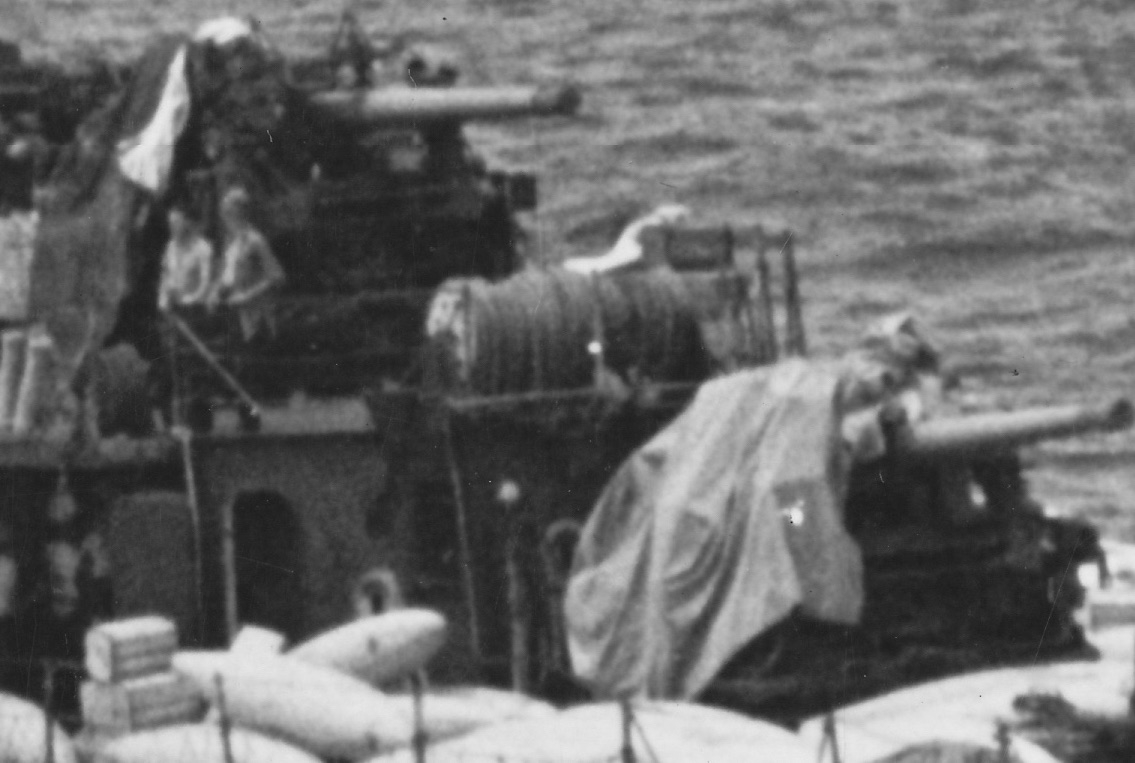

I was just trying to figure out what the structure was just behind the #3 mount. In the first picture I posted there is a sailor standing behind the #3 5"/38 and behind him is the structure I was referring to. Is it a locker or some other storage container?
Scot
Scot
- Posts: 3871
In looking at another photo taken in the yard at the same time, it looks like a big reel (it is covered in canvas in that view). Kind of unusual for a reel that size on a destroyer, so I'm not sure what it is for? In this other view from November 1943, it looks like it is for ropes or hoses?

That's what I thought it looked like but didn't have a good enough resolution photo. This picture from NAVSOURCE seems to show a more angular structure. Since the photo you provided was later in the year I could assume that this was a temporary structure used during the yard work.

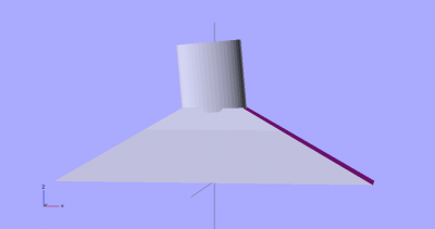

I would like to see replacement Shapeways/MM 700 scale stacks for the Gridley (Bagley) class. These would enhance the Midships kits (as the Benham stacks have done).

I took some guesses at dimensions from some of the photos in this thread and started modeling the stack and the updrafts.
The transition piece still needs more work, though. C&CC would be appreciated.
