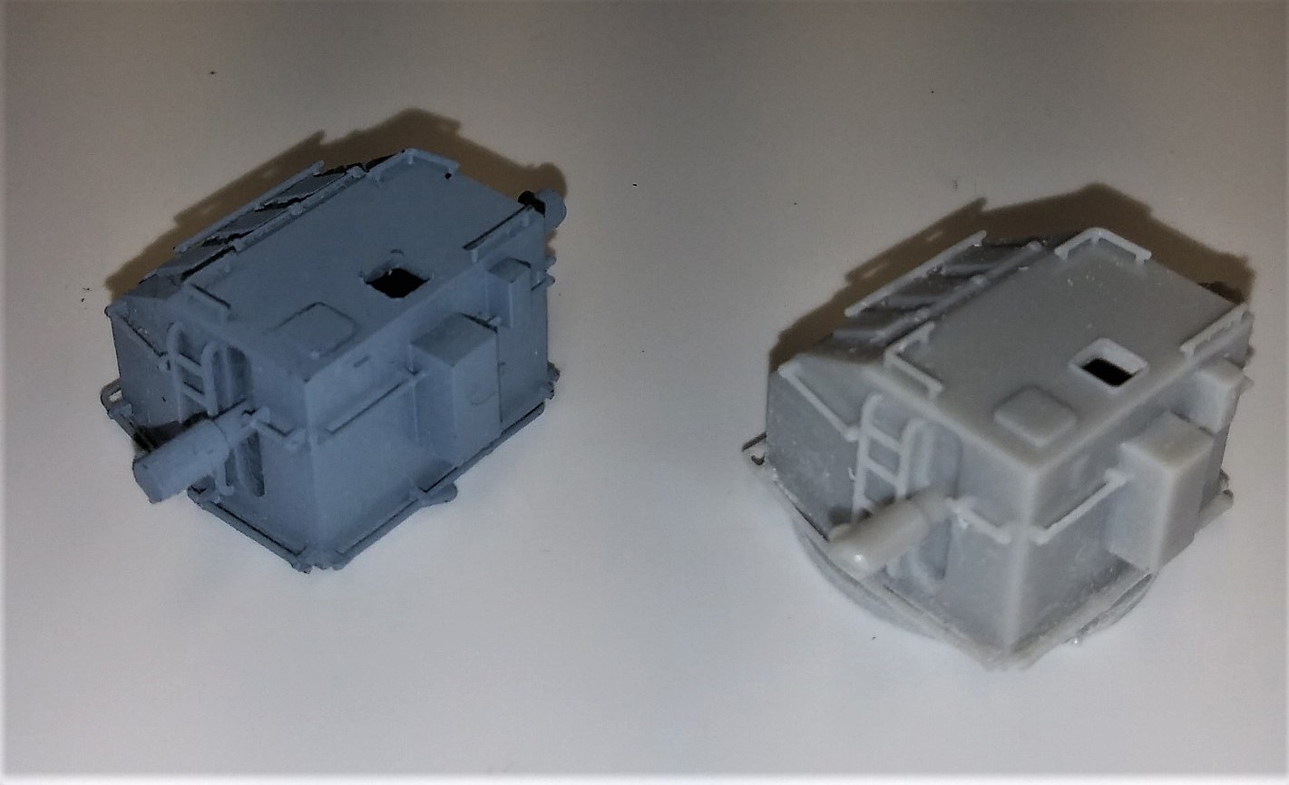

Nice results!!! In 1/96 scale you've been able to add a few details that in smaller scales would be extremely difficult, if not impossible to produce - i.e. the waveguide etc. I've actually got that drawn up for my DD-566 project on the main mast 2D CAD files but whether or not I can get them into 3D will be a challenge.
I believe Tom & I both experienced the sagging and also distorted handrails that came out of our first efforts. I took his 133 scale Mk. 37, scaled up to 144, made some modifications for my use and this save a whole lot of time in the long run. My Mk. 25 RADAR & base ring are also separate parts. Here is a photo of my last version prior to painting:

Here is Tom's version in 144 scale (left) next to mine:
His is primed and made of Rapid Black resin while mine is raw printed in Matte Gray resin - at the time I printed this I had not tried the Rapid Black resin - I've since been doing all my small detailed parts in that resin as it gives much higher detail results.
Getting a successful print w/o holes on my Mk. 25 RADAR dish was a challenge, as well. Finally succeeded in that attempt but it is conical throughout - at that scale/size those kind of variances can't be seen in any case.
I found that manually supporting the director base worked out much better than letting Chitu do that - the orientation I can't recall now, but I think I had my last edition at either a 15 or 30 deg. angle.
Good job - excellent results!!

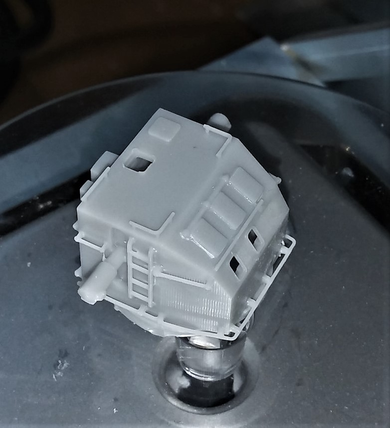

Phil,

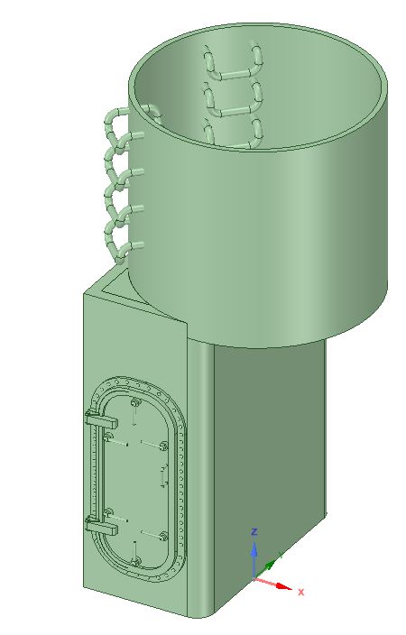

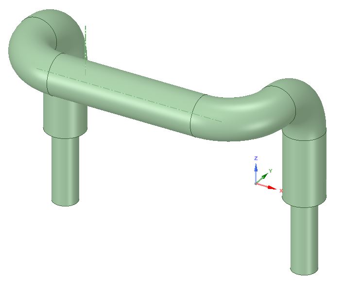

I don't understand at all why you should have any problems working in 1/96 scale with printing hand grabs, esp. at the diameter you are making them. Tom is working in 1/133 and 1/120 scales and I'm working in 1/144 scale and we're both able to consistently print hand grabs that come out excellent. Here is a shot of my typical grab with an OD of 0.2mm with inserting pin of 0.13mm dia. -
0.2mm dia. Hand Rung in 1/144 scale
I came up with this design well over a year ago and use it on just about anything that needs them. (I use the smaller dia. pin more for locating purposes than anything else. On my LSM/R project I scaled this part up and actually drilled holes in the stern for locating correctly. That is where the pins came into play) At 1/144 scale the rungs are located 2.12mm apart (12" apart in reality) and as such look like this:
Mk. 51 GFCS Tub in 1/144 scale
Handling these parts is a bit tricky, but I've not lost any of these rungs in well over a year due to my own ineptness. Small arms return fire and counterbattery near hits non withstanding :doh_1:
My handling problems have mainly to do with handrails and open positioned bulkhead doors - I see NO need to go back to using wire or drilling holes to manually place items such as this - it just takes some patience and learning how small or thin to make the part. Again, Tom & I have seen good results at the smaller scales - 1/96 scale should not be a problem. I've also found that printing stanchions & handrails as one unit works well with a thin lip at the bottom of the stanchions to hold everything together once it's ready for installation. I always check my plans & photos to make sure that the location has the raised deck lip on that particular item before adding. As You have mentioned before, many of the stanchions were welded to both the deck and deck lip on the inboard side of the deckhouse. This would not be the case for stanchions welded on the outside of the bulkhead.
In regard to printing gun MOUNTS and turrets as single parts there is no issue with that - comparing the Model Monkey 5in/38 sgl mounts that I purchased a long time ago for my STODDARD project (1/144 scale) to the Revell kit parts is a no-brainer - why print parts separately if you don't need to? MM has some really good 3D parts available, and these mounts are all printed IN DETAIL as one part with a separate barrel. I think there is WAY too much overthinking into all this stuff, and it only makes the process unnecessarily difficult. Keep the design as simple as possible while incorporating the details you want to see. Once again - this is a TRIAL & ERROR stage of development. So far, I've found that deckhouses can be printed as a single part or depending on size, divided into equal halves with either tabs or pins/holes for proper assembly alignment.
As for drilling resin parts - that can be tricky and disastrous! I start with a very small dia. bit at high speed and then gradually increase the dia. of the bit until I reach the intended hole diameter. While a jeweler's bit may be the best choice, I simply use my std. machinist drill bits and make sure the drill speed is appropriate. I don't manually drill holes in this type of material.
Hope this is helpful!

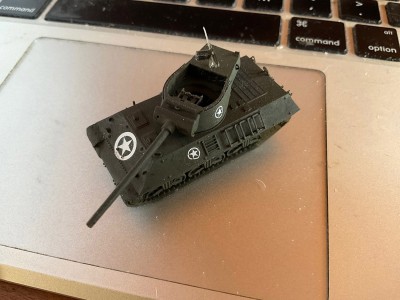

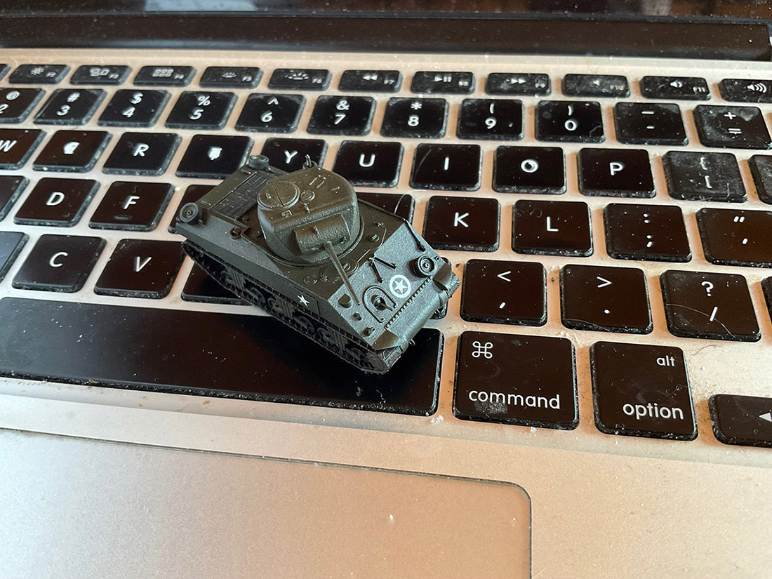

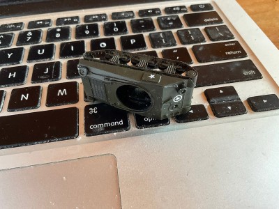

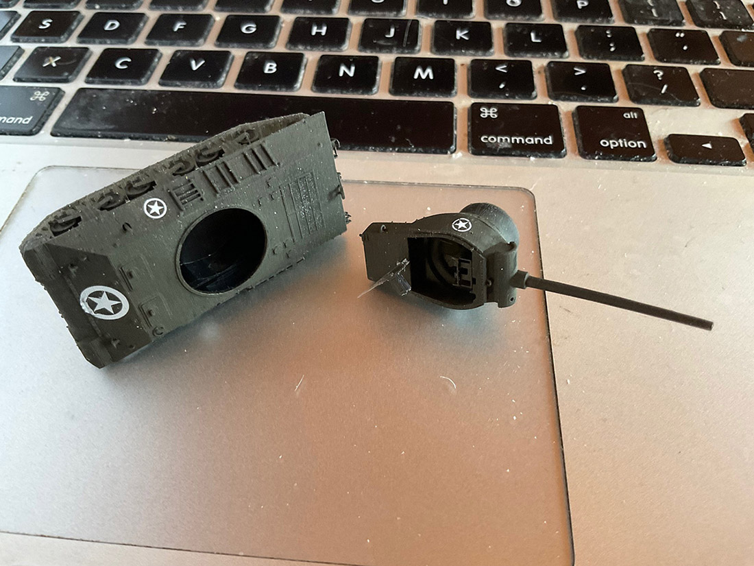

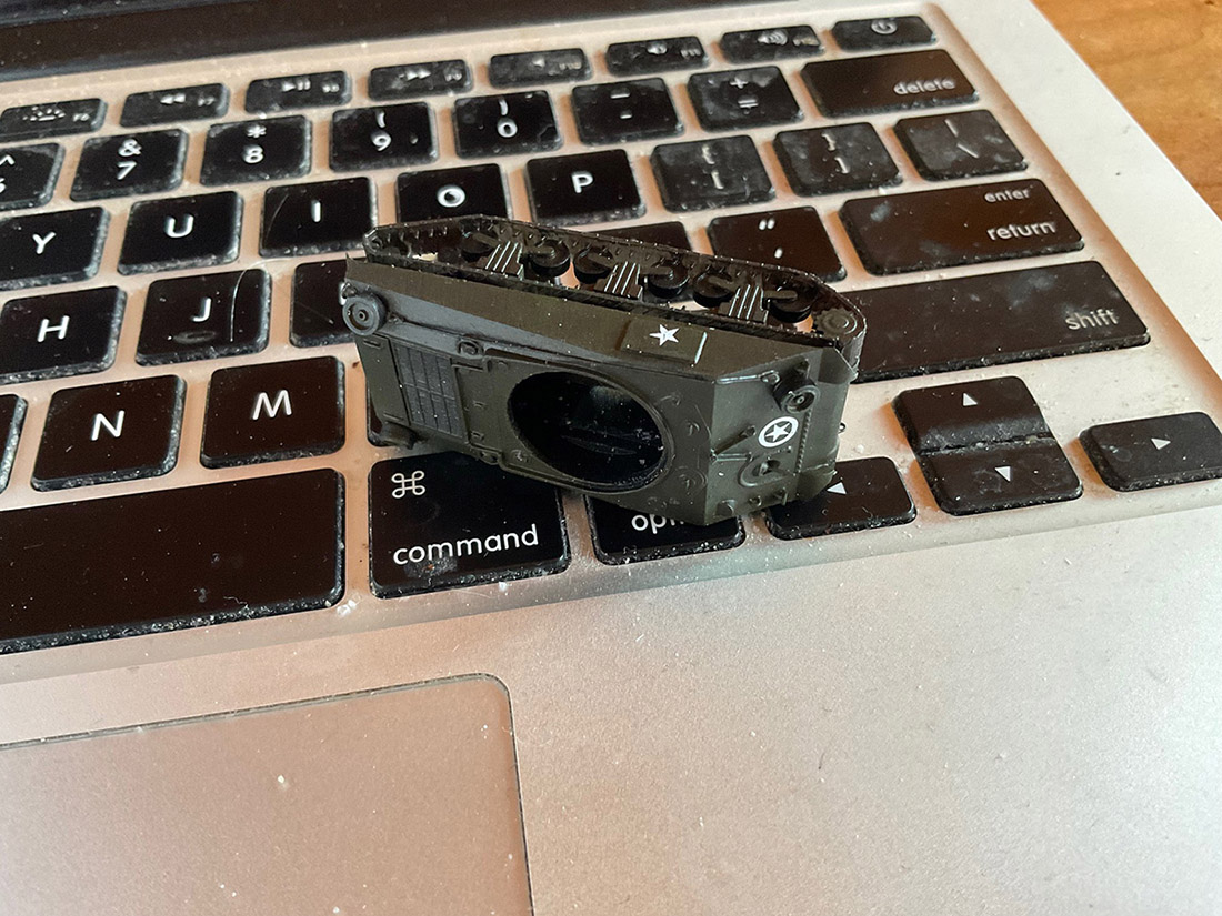

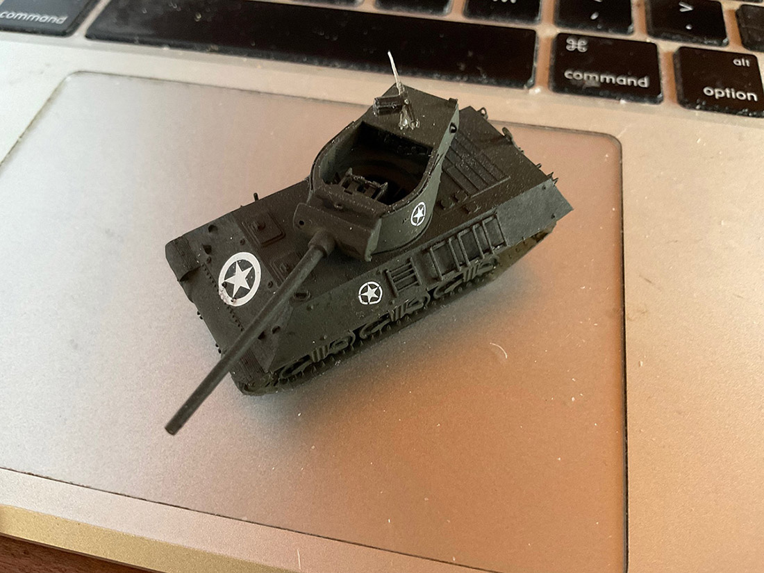

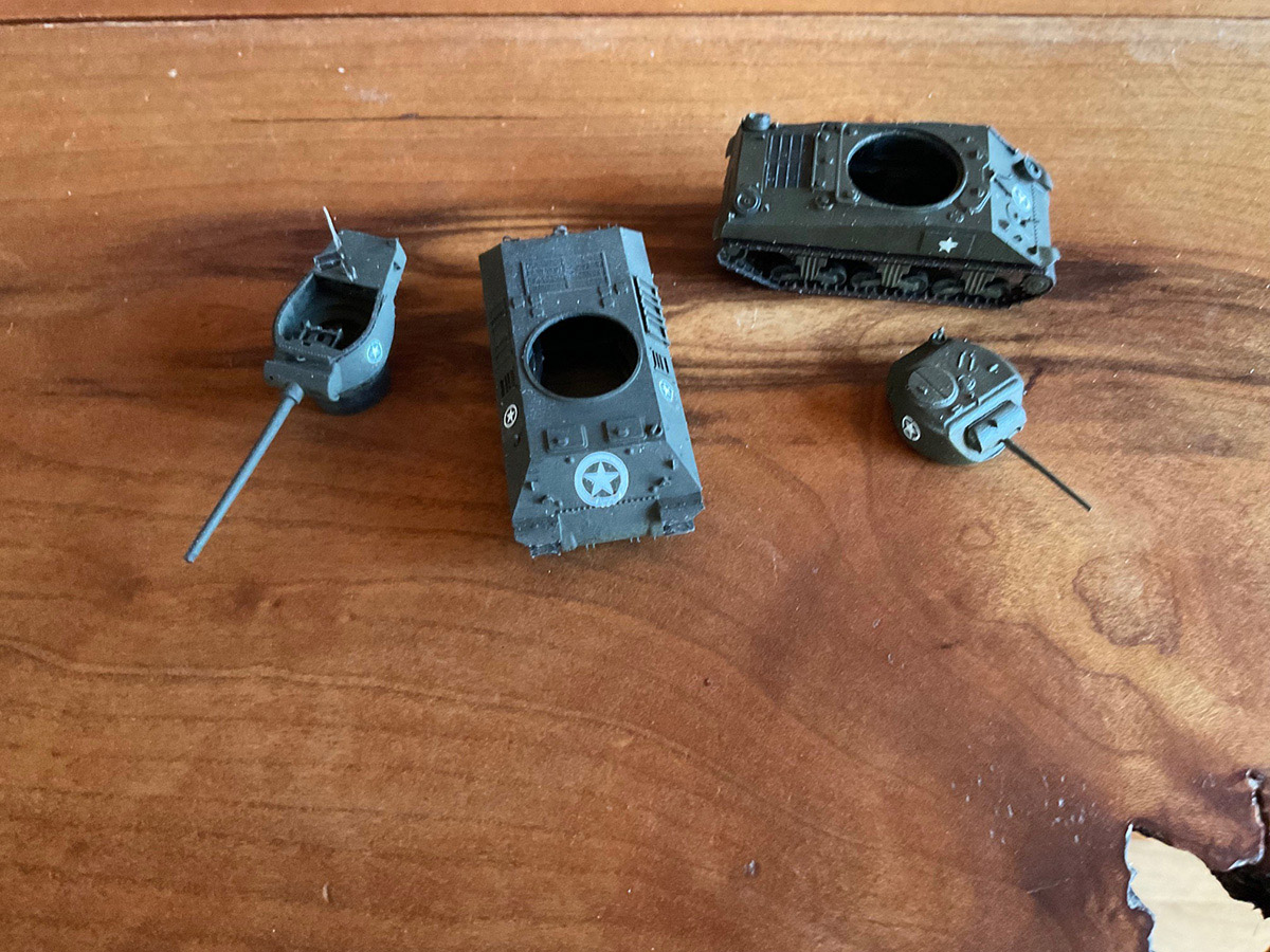

A M-4 Sherman and M-36 Tank Destroyer. These printed with separate turrets and interiors designed to produce a smooth distortion free exterior. To get bottoms and tracks to print "OK" the chassis were inclined at about 15 deg. These were printed in both 1:120 for APA and 1:133 for LSM.
Tom

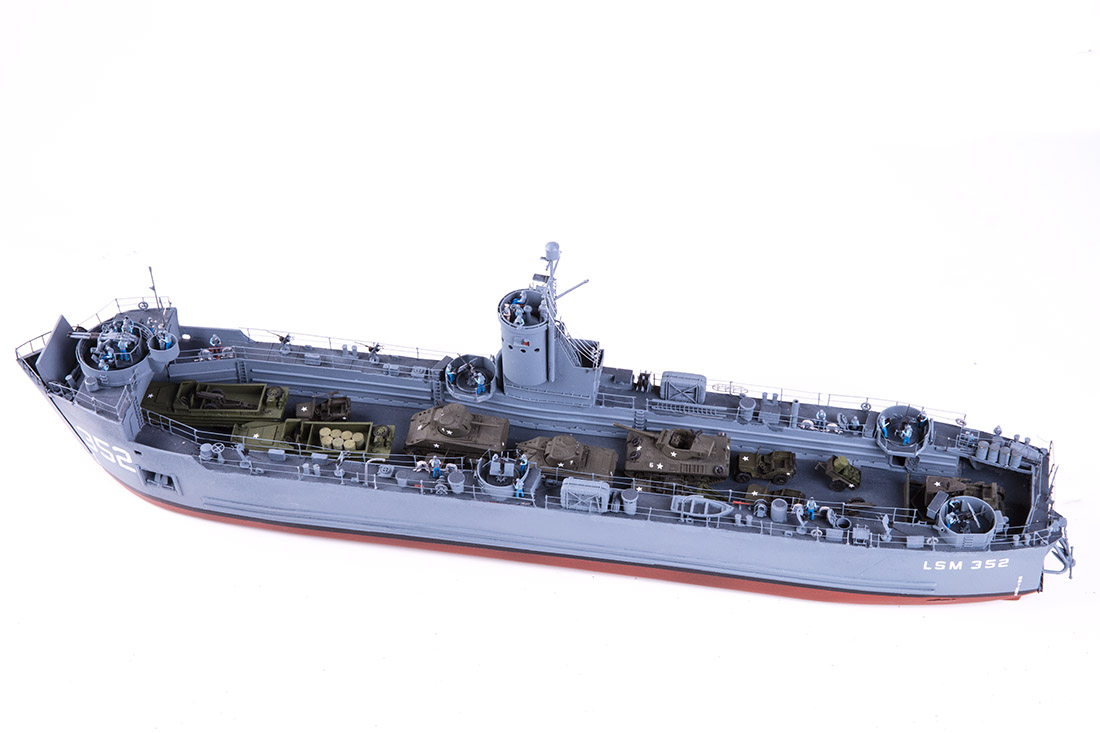

The LSM project, sitting on the sidelines for a but, but with a load of invasion vehicles and some deck crew. The hull originally made from .20 thou Aircraft Aluminum circa 1963? Many printed parts added in more recent times. I don't think I could have constructed the vehicles and certainly not the figures by traditional methods.
Tom

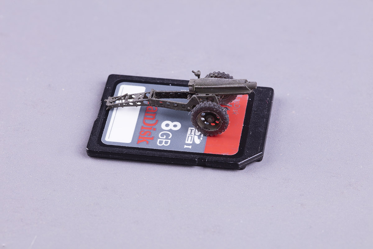

I titled this photo as PAK 75, but of course it's not a "Panzer Ab Kanon", but instead the versatile 75 mm Pack Howitzer. So named as it could be broken down into components and carried on Pack Mules! Also towable by a jeep or even carried in a DUKW.
It's printed in three pieces, carriage and tires. The tires print extremely well horizontally but not so much vertically mounted on the carriage. This also proved true of the jeeps, the tires printed much better separately from the Jeep Chassis.
I don't think that using covential means that I could make the tires with the tread lugs and holes in the wheels. Perhaps the cghassis could be done with PE, though I think this is better. Printed with a water based "Phrozen" Rapid Black Resin, which Prefer for detail. Living in a sub arctic climate where the indoor humidity is around 2%, dust is really unsolvable.
