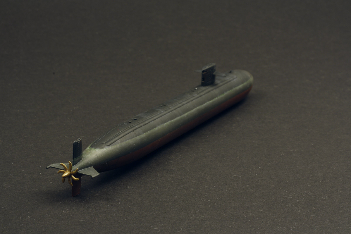

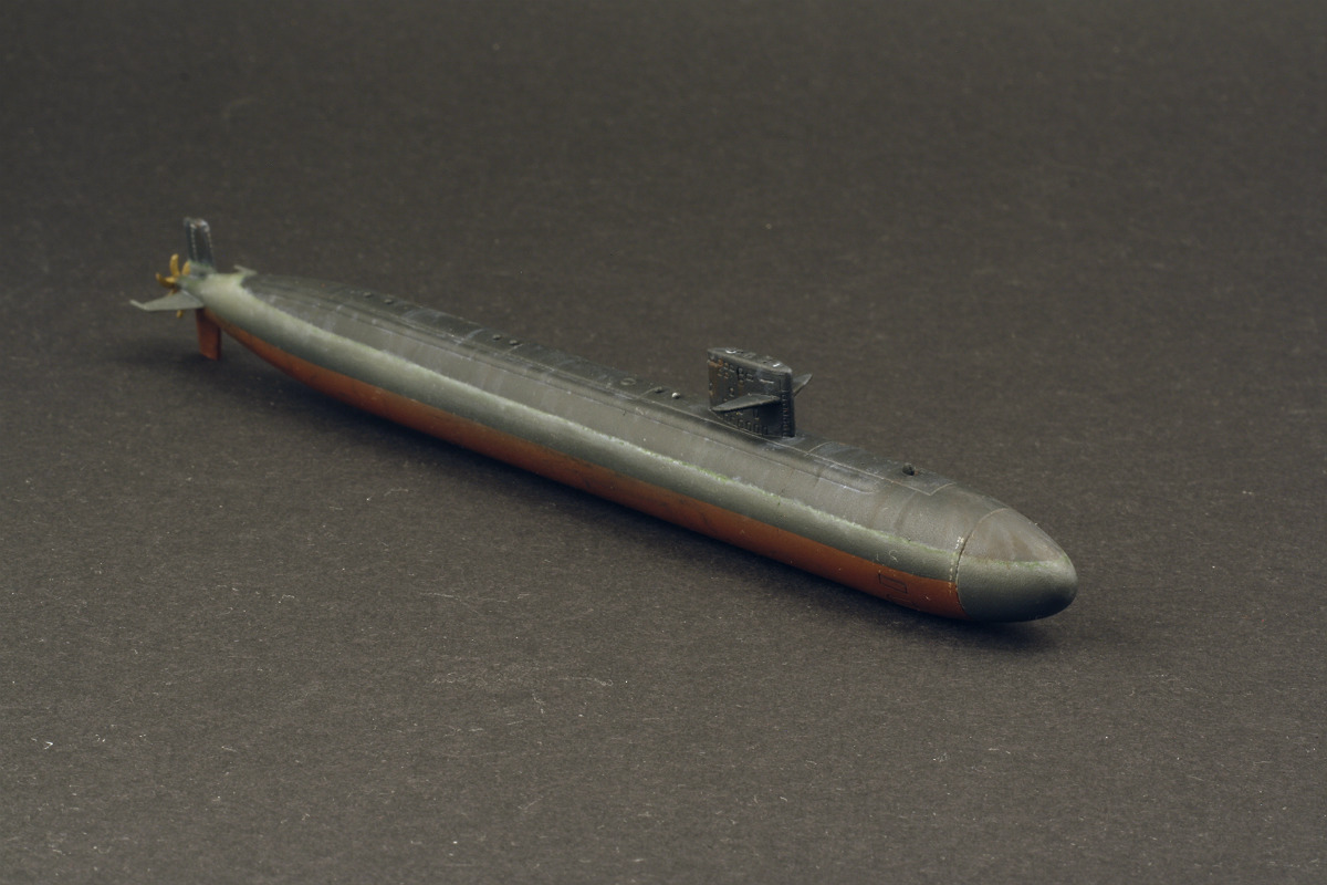

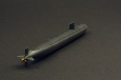

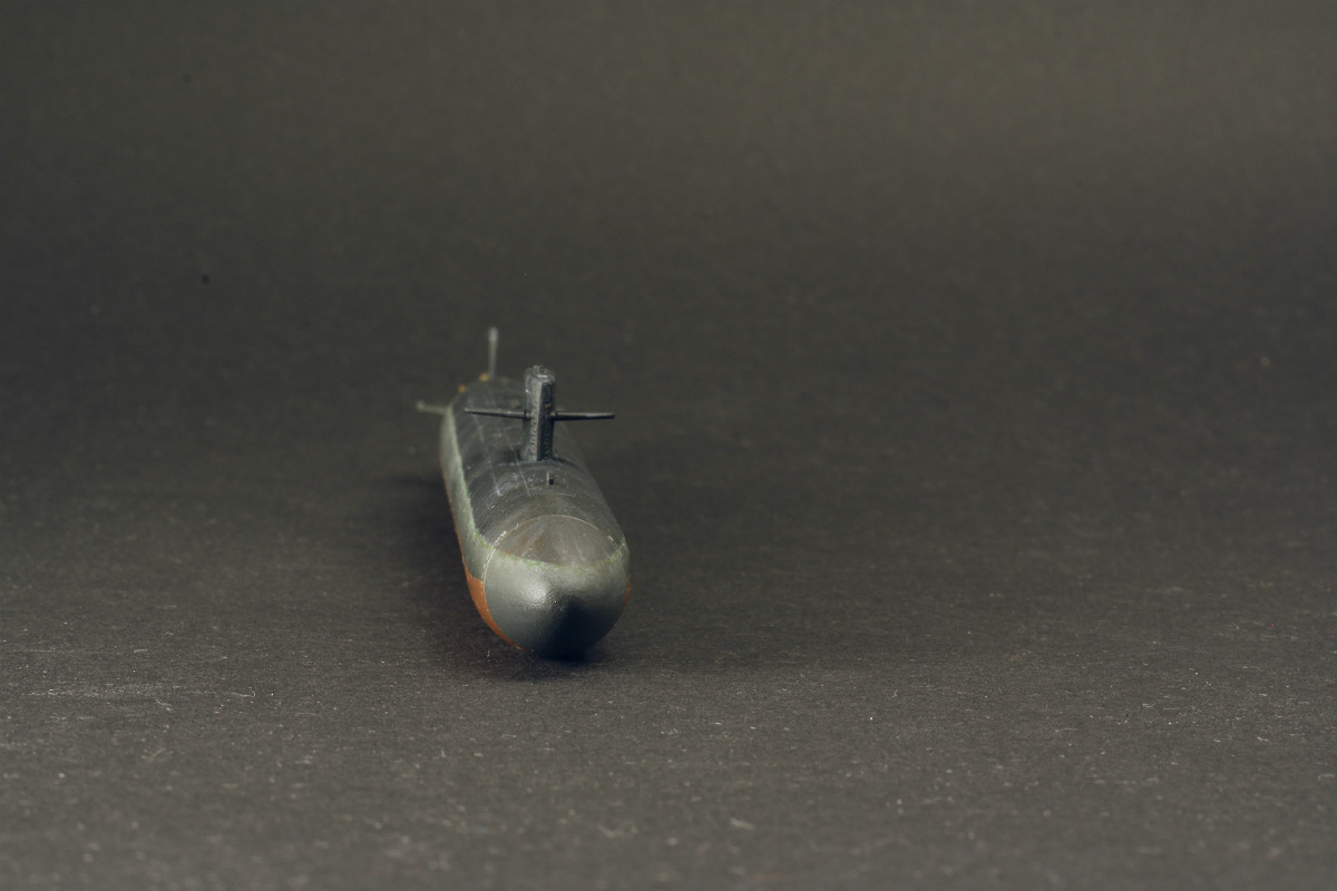

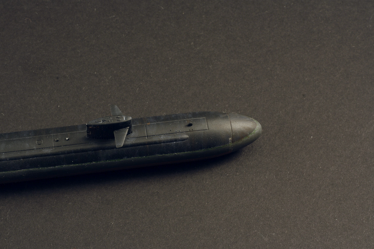

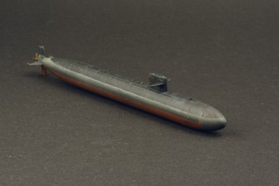

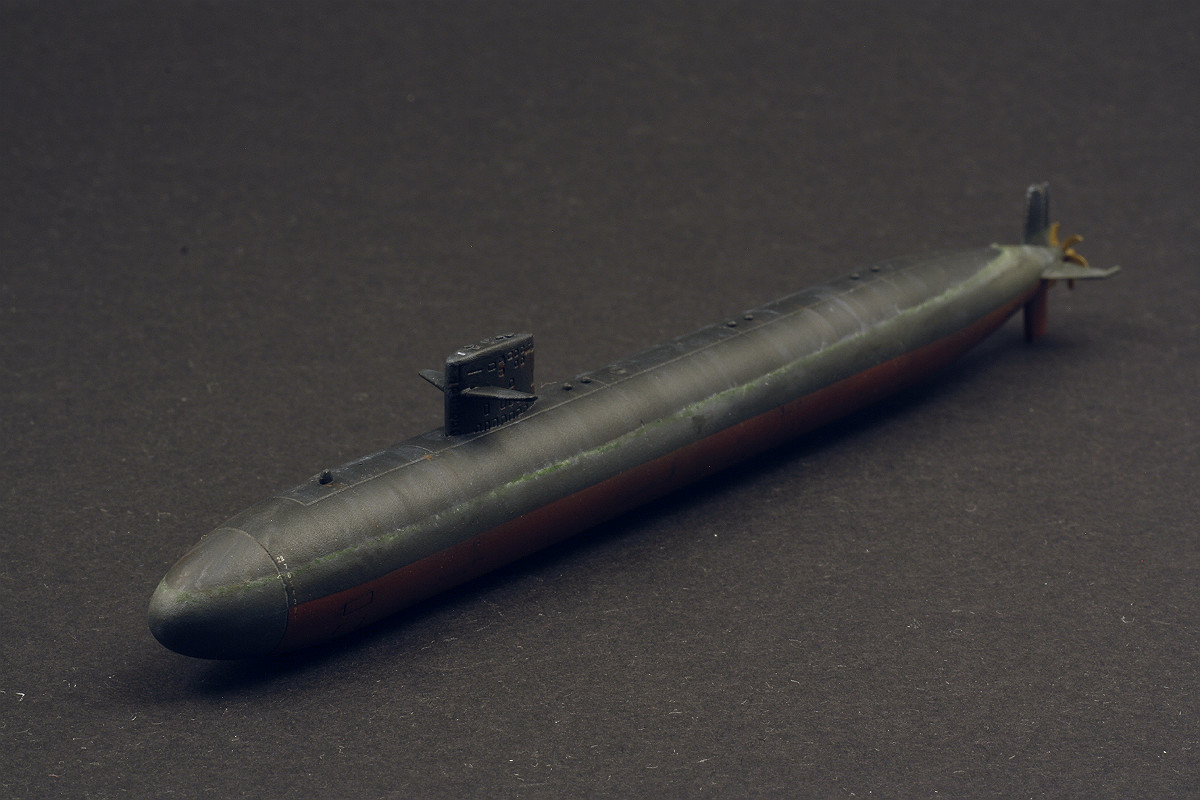

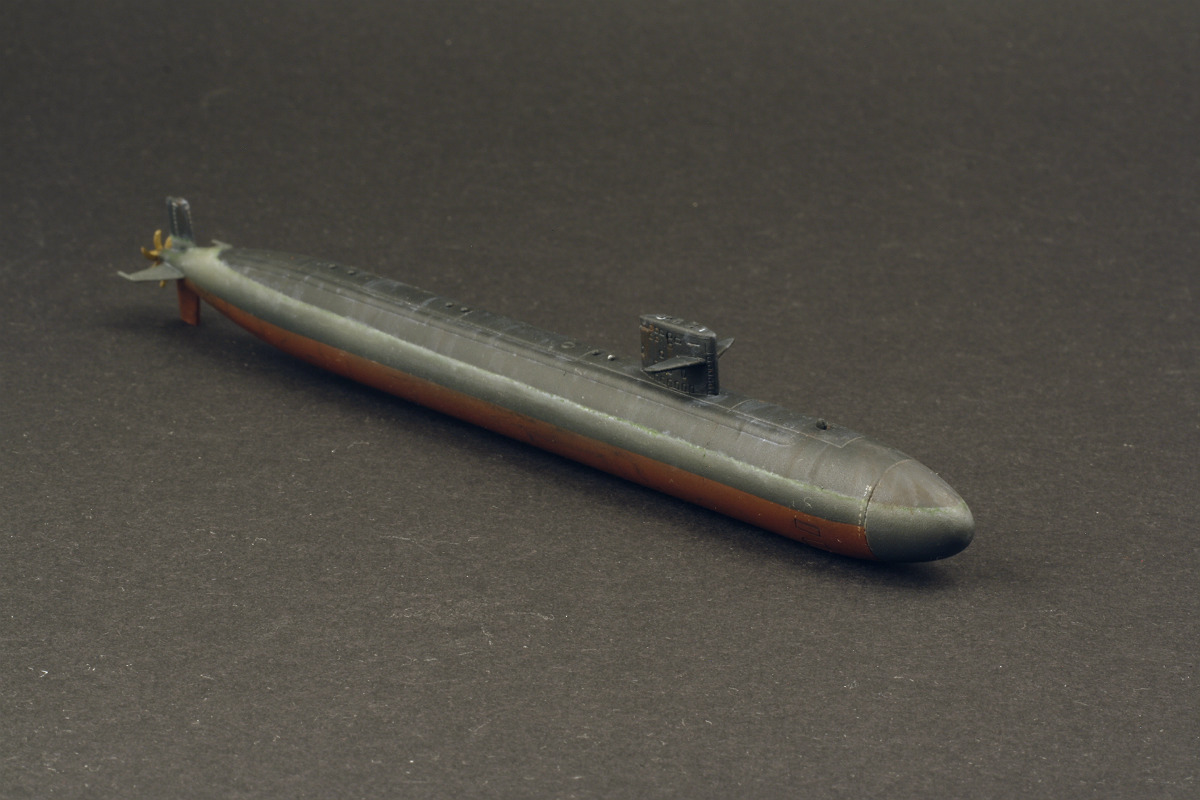

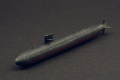

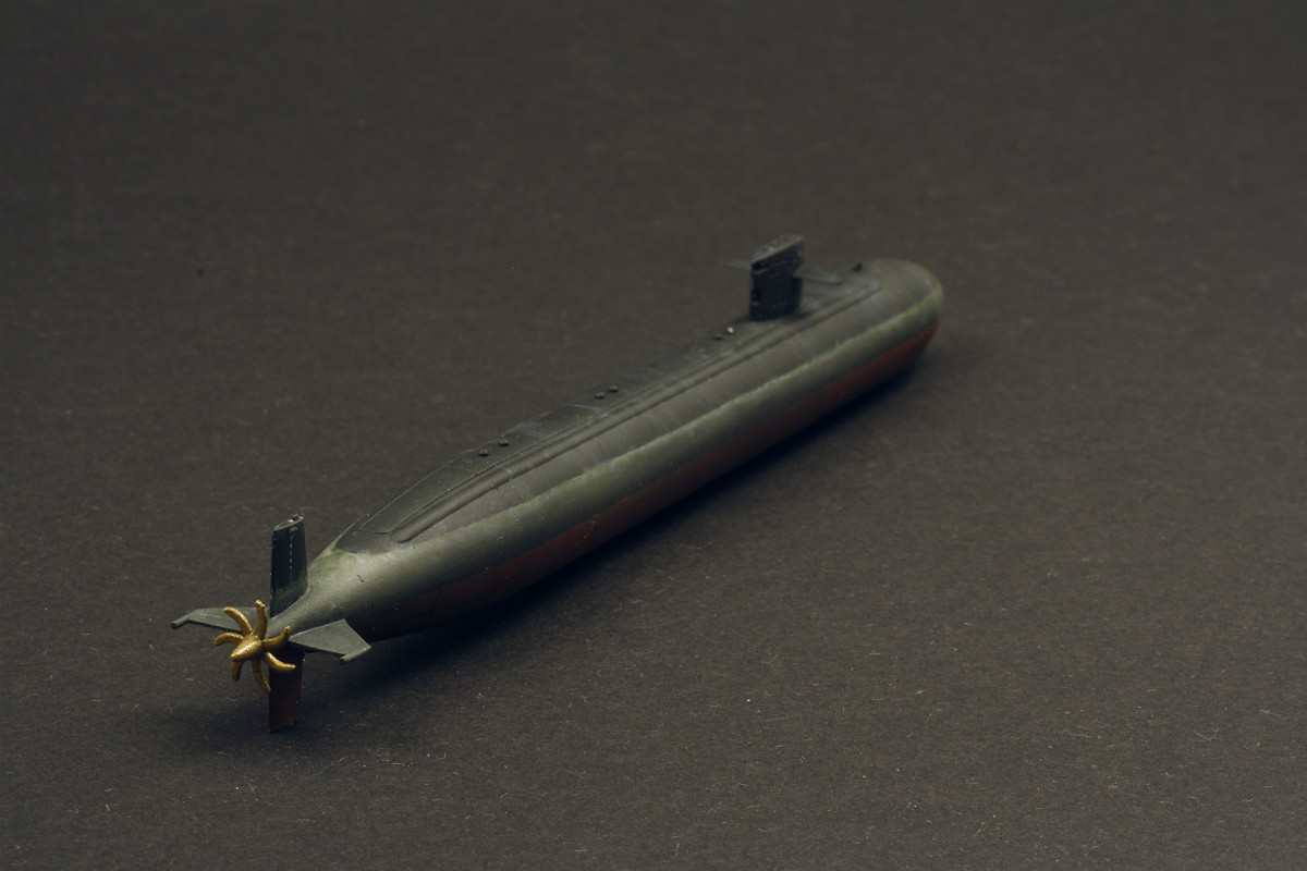

Cool. So appreciate all the inputs from you guys.
I completed my 1/700 build and will go into 1/350 with this info and built the Flight 2.
Here is the Flight 1 Los Angeles in 1/700 from HobbyBoss with changes to rudders and hull joints.
I modelled her as in dry dock.

You're '88 looks great, except for the sonar dome. Your model looks close to two of my old boats; the USS Albuquerque (SSN 706) and USS Dallas (SSN 700). I enjoyed them immensely! I love your paint job!

Thanks!William wrote:You're '88 looks great, except for the sonar dome. You're model looks close to two of my old boats; the USS Albuquerque (SSN 706) and USS Dallas (SSN 700). I enjoyed them immensely! I love your paint job!

I have served on three 688 class boats, two Flight 1s and one Flight 3, the USS Albuquerque (SSN 706), USS Dallas (SSN 700), and USS Pasadena (SSN 752). I am also on the SUBASE New London, Groton, CT, where I have seen other 688s in drydock. I have rarely seen a the bow dome painted differently from the rest of the hull. I am sure that there might be exceptions, but I have never seen it.
There is a photo of a 688 undergoing an emergency blow, with the entire bow breaking free of the surface. The hull appears to be all black.
That said, your model is exquisite!

By the way, what shade of black did you use? It seems to have a tint of gray mixed in. It looks great!

I use the not-so-black Tamiya Nato Black XF69. I find it best for models that need to be black, because it is not so pitch black that it starts to lose all details. I think it is the most accurate color for this scale. It takes in black wash for any kind of dark recesses, and also dry brushes beautifully with something like medium gray for those areas you want to highlight.William wrote:By the way, what shade of black did you use? It seems to have a tint of gray mixed in. It looks great!

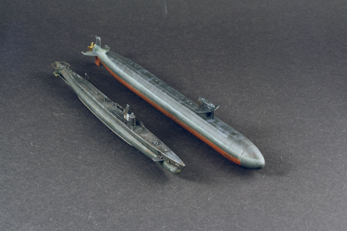

Just for you guys, both projects done I asked about here on CASF so you can have a nice little comparison.

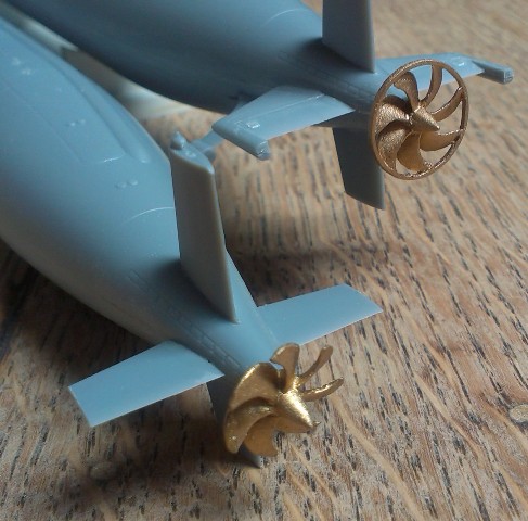

I was just curious if anybody knew of any upgrade kits (not that there is much to upgrade like on a surface ship) available for these ships? I just ordered a Riich kit for the Flight II that I'm going to build into the USS Chicago for a friend. He was the CO of the USS Chicago for a number of years, and recently he was able to get me a tour on an active Virginia class boat, the USS North Carolina. So i'm going to try to build the model as she was when he was the CO as a gift for him.
I saw the posts earlier about the better shaped screws, but and having trouble finding them. Anybody have the direct link or know of any other options available?
Also, are draft markings included in the box? Or do I need to source them elsewhere?
Thanks!

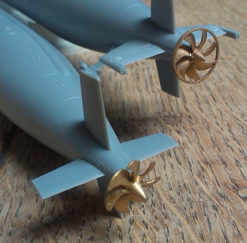

Hi, I made the correctly shaped screws for these (and other) ships, you can order them from Naval Models in The Netherlands. For some reason these are not yet on their website, but send and email to info@navalmodels.comhondaman117 wrote:Hello,

Thanks! I sent an email so I will see what comes back. On a side note, does anybody know how these look?Maarten Sch�nfeld wrote: Hi, I made the correctly shaped screws for these (and other) ships, you can order them from Naval Models in The Netherlands. For some reason these are not yet on their website, but send and email to info@navalmodels.com
Please let me know when you have success!
Cheers, Maarten
https://www.hobbylinc.com/g-factor-la-c ... :350-35018
They are discontinued, but I found one on Ebay and thought about getting it as well.

Yes, I think this is a brass copy of a bad looking plastic prop. The blade shape is just as bad as the original: no blade twist, blades much too narrow at the root, the sweepback is not correct. I wouldn't spent my money on these G-factor screws.hondaman117 wrote: Thanks! I sent an email so I will see what comes back. On a side note, does anybody know how these look?
If they had done their homework and created a good looking screw instead it would have been another matter, but making brass copies of a bad original is not a good idea. For comparison here my screw again.
