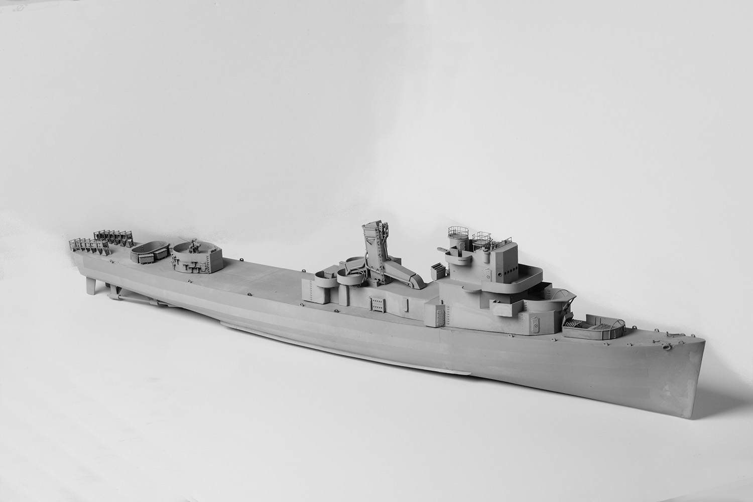

Current progress, none of the on deck items are attached. Am re printing aft superstructure for various reasons.

"Stuff" piled on the deck and not attached, current progress. Not inclusive of all items currently produced for this model.

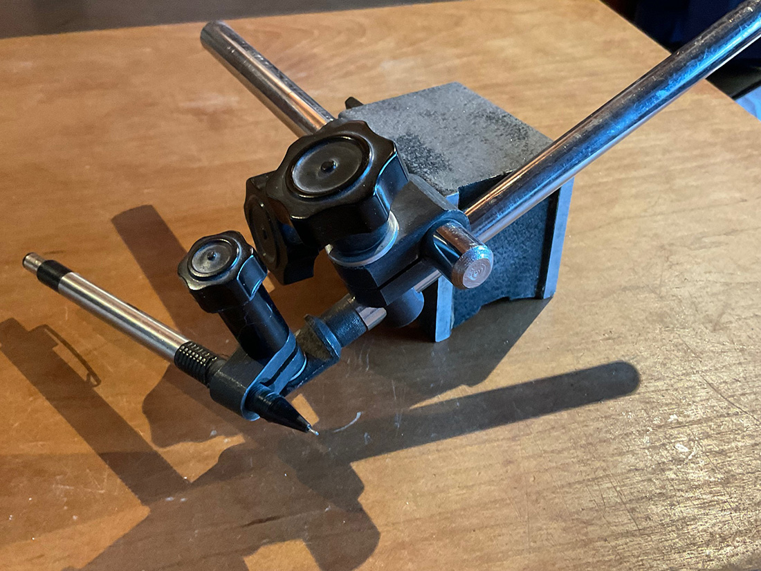

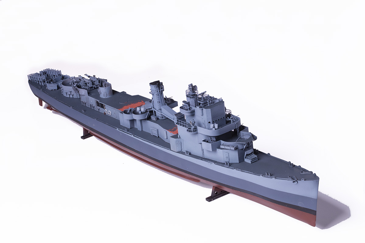

Began painting the hull, starting with my secret home made hull red. Next will be boot top with Liquitex flat black after the red thoroughly dries. I did thin with "Valley Jo" airbrush thinner and flow improver. Seemed to work well in allowing a longer session without brush clogging.
My magnetic adjustable arm which I use for scribing hull lines is currently MIA, will turn up, I hope!

Found the tool holder. It's mostly for holding dial gauges used in measuring runouts etc and adheres magnetically. It's performance was enhanced when I took a .5mm mechanical pencil and turned down the plastic ferrule to fit the holder. Scribed the appropriate lines and masked and painted the hull body in measure 22. The deck remains to be finished in 20B though I have laid out a preliminary coat.
Also spraying the superstructure pieces with my formulation of 5H. Due to the complexity I'll probably have to hand paint many of the deck areas in 20B.

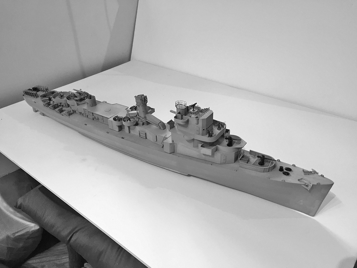

Current progress, all the stuff here is attached. Note puttied areas on O1 level where superstructure modules join.

Many items to produce and add. I already have many items such as the 26' Motor Whale Boat and radars but mast works, lifelines, and the large power cable spools remain to be designed and produced. Cable spools are currently on the (low priority) Roundtuit list. A large number (approx one zillion) of small parts to produce and add such as position lights, loudspeakers, chain stoppers, vent pipes and whatnot.

More stuff added, things seem to progress fairly rapidly. Much of the wartime shipbuilding rapidity relied on standardization and availability of off the shelf components. Much in the same way having built several WWII era USN ships, I have accumulated 3D design files for many common shipboard items. 3" 50 cal mounts, 40 mm Bofors, 20 mm Orlikons, chocks, bitts, directors, searchlight and whatnot. Some items with minor modification such as the K Gun racks which are slightly different than the DMS ones.
3D printing has an advantage in being able to produce multiple items and also mirror them where traditional construction would be very time consuming. The level of detail is often better than I could produce by manual means.
