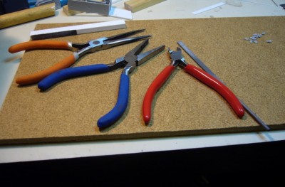

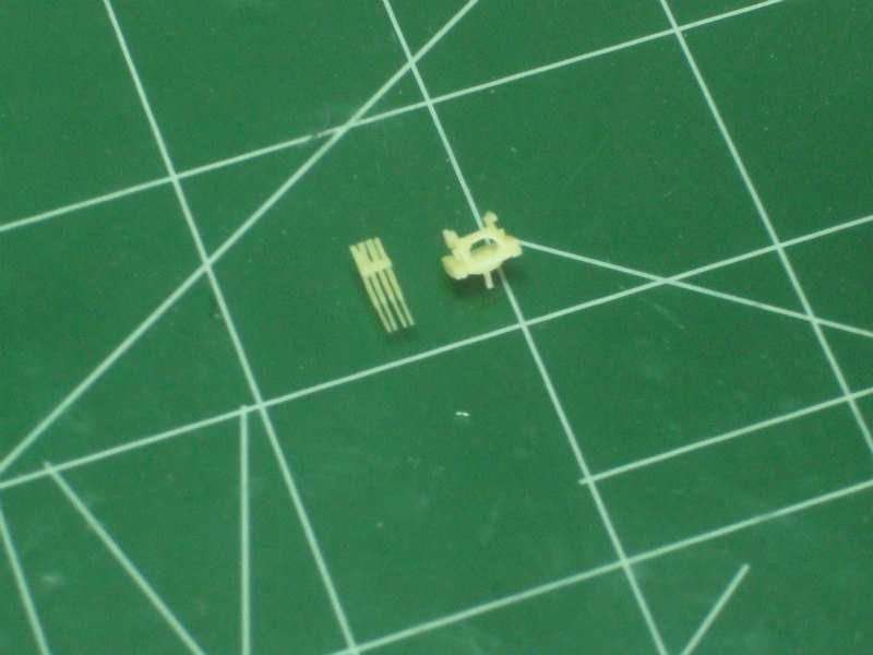

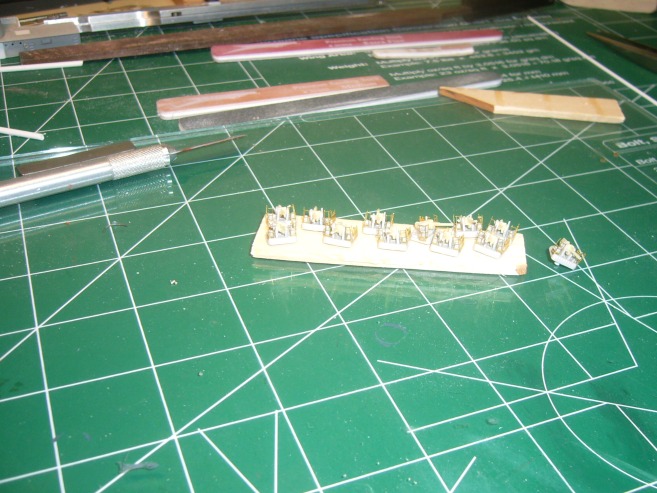

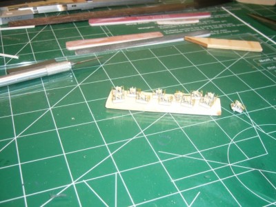

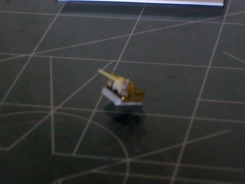

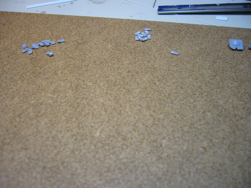

Along the way I have worked on the different guns to have them ready for installation when the hull is done and the deck is mounted. Here are some pics.
The 5" 25 cal are done. I used the base of the kit gun, the barrel from L'Arsenal, and the rest from the Gold Medal Models PE set.
I have the 20 mm and 50 cal guns cut and trimmed from the spru and standing in my little holding tool, a piece of .40 styrene drilled with the corredt holes for each different size. I intend to at least attempt the PE for these but god are those parts tiny!!!!!!!

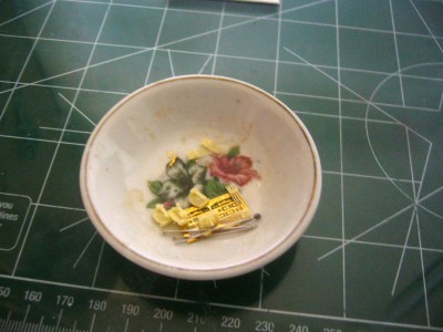

I have the 1.1's from L'Arsenal and have played with the first package of four. Clearing the flash from the base of the gun is a real pain as it is really kind of thick and can't be cut as flash normally is. I ended up drilling a small hole and then cleaning it out with my Dremel tool with a diamond point. It really does take a very small bit to do this. The PE had me spitting nails as it is really, really tiny. And even using my highest magnifier, 3.85 I think it is, I have to really put it in my nose and I lost one seat, couldn't even come close to finding it when I did, and totally squashed the foot rest on another but have hopes of saving that one somehow. I think the modelling is much more accurate to scale than the kit parts so am willing to put up with some difficulty but boy what a pain!
Some of the pics are fuzzy but I had trouble getting my camera close enough to see anything on some of them.
My handy holding tool for the 50 cal and 20 mm
The 5 incher
The 5 incher

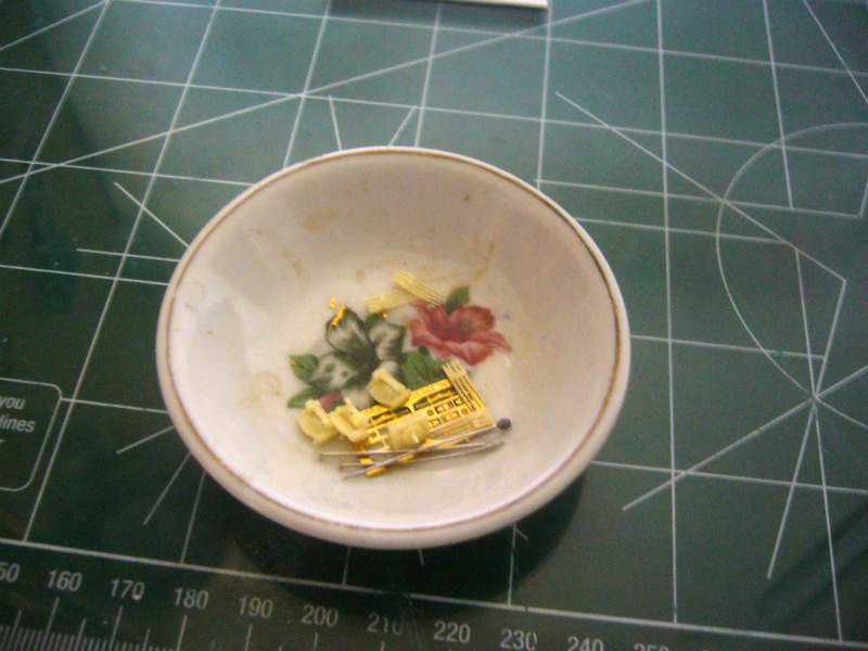

My holding dish for the 1.1's. Notice the straight pins in there for a size comparison
The 1.1 by itself
The 1.1 by itself

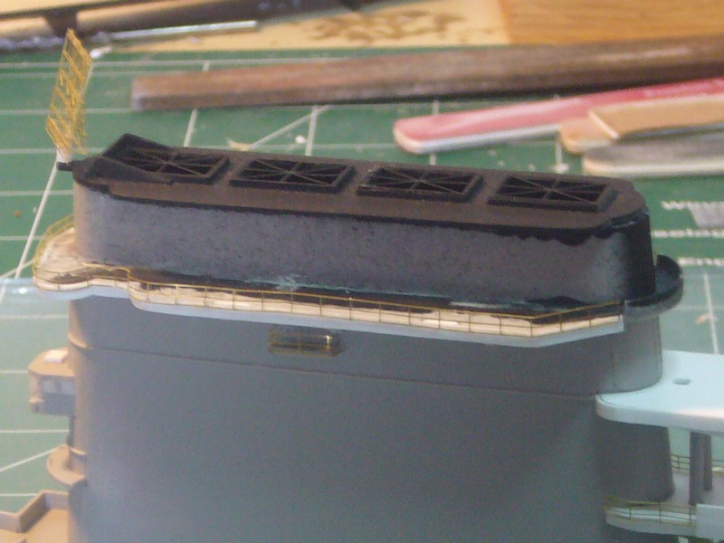

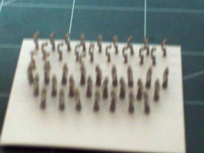

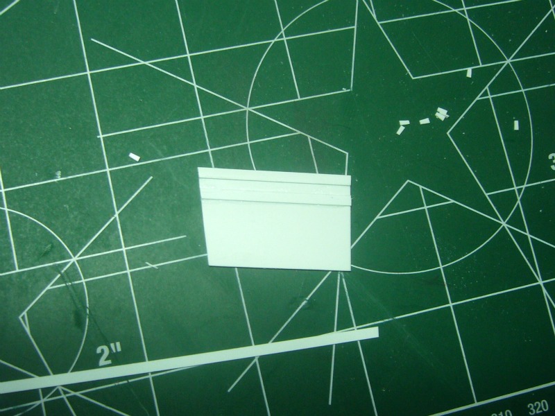

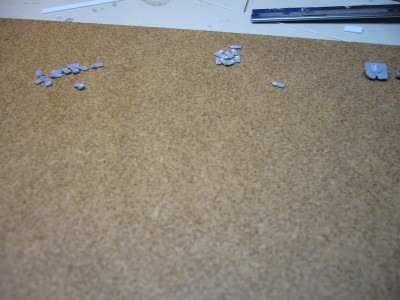

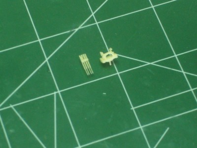

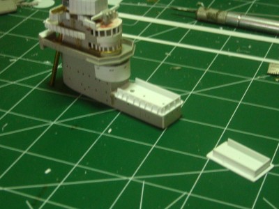

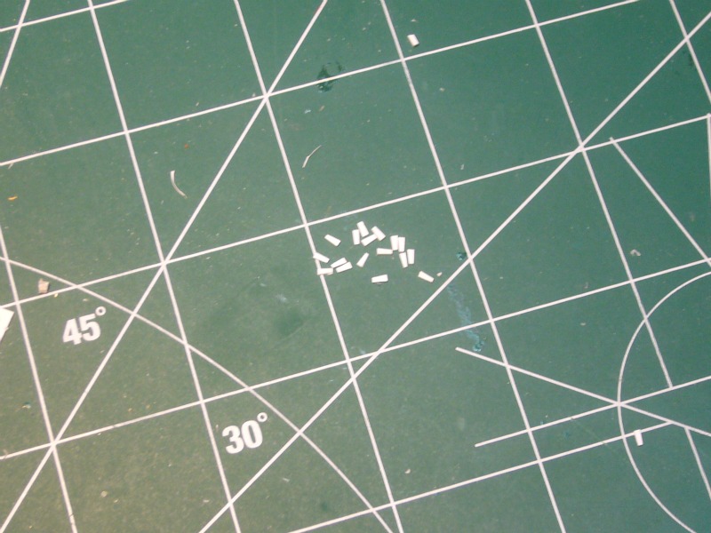

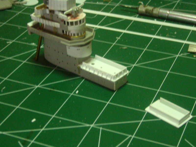

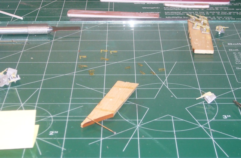

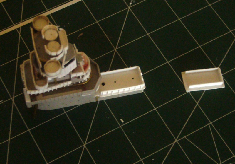

Have been really busy with travel and other things and haven't had much time to actually work on my ship but I did start to tackle one of the tedious tasks I've been avoiding, namely all the little braces on the 1.1 splintershielding. I still have to do the one for the one actually on the back end of the funnel assembly where the upper 8" guns were. But here are a couple of pics of the jig I use to make all those )(&&&^^@#$% itty bitty pieces that can pop out of the tweezers so easily and go off to the land of the lost and never to be found again. :big_grin: Even allowing for extras I had to make a couple more just for the bridge section. Also in the two pics of the bridge section you can see the splinter mattresses I put on the 8" director platform as shown in the latest pic that just came up on the Calling all Lex forum.
Those itty bitty jumping pieces
The jig for cutting all those itty bitty pieces
The back side showing the guides
Installed on the bridge structure with the deck structure ready
A little better shot

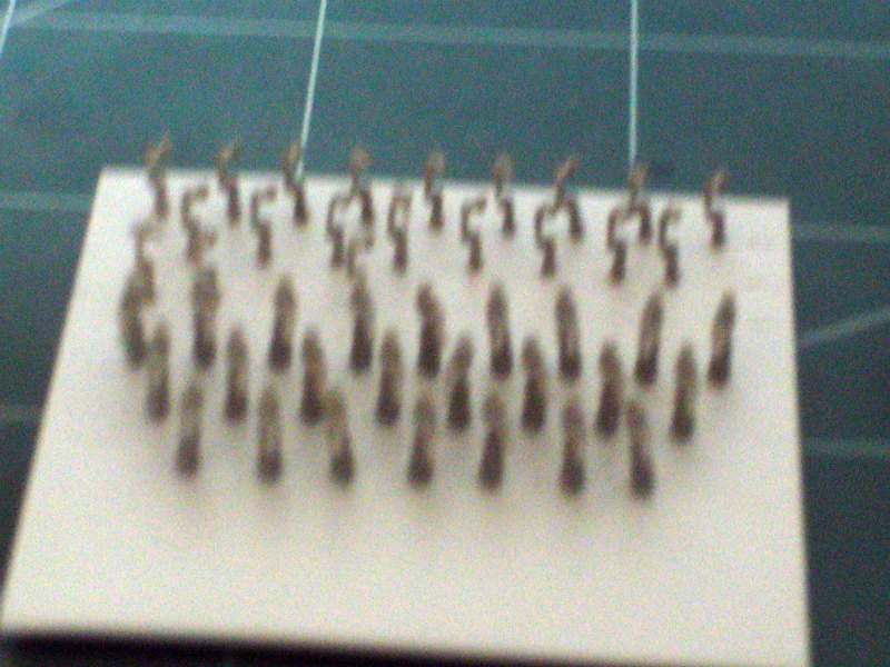

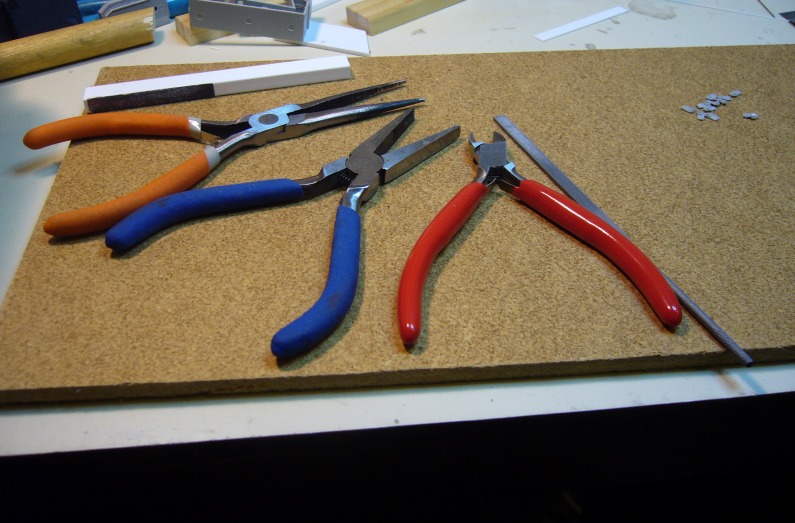

In getting my new computer set up and all my data transferred from flash drives I found the pics of the five inch guns being done. I tested the kit parts as is, didn't like them. The L'Arsenal parts as is, didn't like them either so crossed all the different things I had, kit parts, L'Arsenal parts, and my PE from GMM. The rails from L'Arsenal are actually more accurate but the fusers are molded in their base while the PE from GMM has them in one piece with the rails so I went with them. The kit barrel supports had holes for the kit parts not needed with the L'Arsenal barrels so I had to fill them. Used styrene rod glued in and then snipped off flush.
The holes in the barrel supports being filled
Here are the supports near my pliers for a size comparison.
The next one ready for PE
All those little suckers done

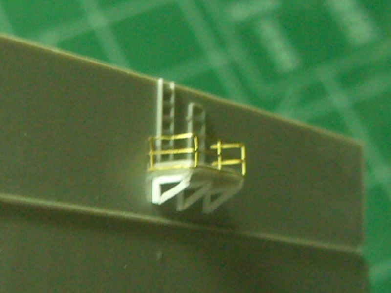

I was cruising the builds in progress and came across this topic dealing with railings. There was a link and I followed it to get a very different insight into installing railings, the way to glue, and quite a bit on the subject. If you're interested you can go here:
viewtopic.php?f=4&t=37612
It raised some questions about PE that I had not been aware of and now must make decisions on. Is super glue the wrong one to use for PE? It seems to be for railings. Fortunately most of the rails I have done are short to begin with and one I was having trouble with on the small platform just under the top AA platform on the funnel, I had removed the rails to gain access so I could remove the door molded in the kit. Now the technique to make them fit is much clearer and I can proceed. I wondered why I was so reluctant to finish that part and now I understand, I was waiting for this info to come to me so I would not have to do it over again.
The question I have is should I be using white glue for all PE to plastic attachments? Should I use super glue for the PE itself in things such as a radar? Jim it was your post that I got the link from do you have any further input?
lvsquarerigger
Posts: 398
Joined: Tue Feb 17, 2009 12:26 am
Location: Albuquerque, NM
Re: WIP - 1/350 USS Lexington (CV-2)
Post by lvsquarerigger »

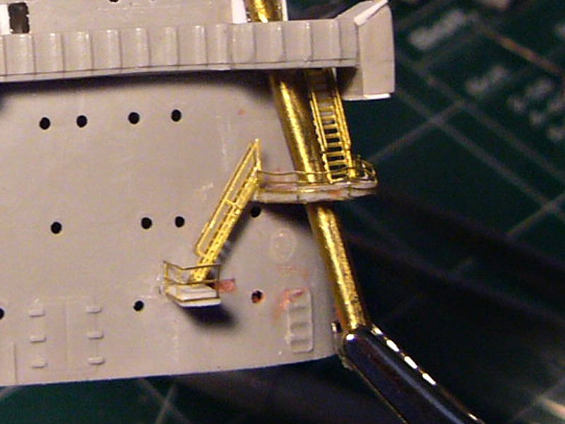

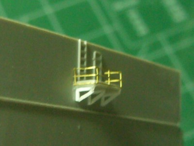

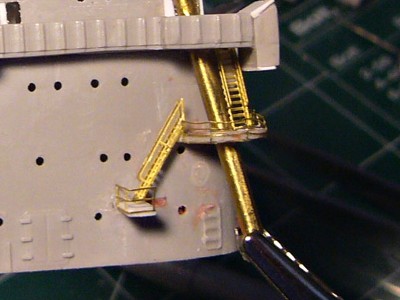

I went back through some of the pics I have, cut, cropped, and resized them to illustrate what I'm working on. When mounting rails I would mount them along the side edge instead of on top as is correct. Now having seen the correct way I have work to do. The small platform under the funnel AA platform will be first. Not sure if I need a stanchion at the funnel itself as the rails can be anchored to that. The same with the small platform on the bridge structure. Most of the bridge railings are behind splinter mattresses so I don't think I'll change them but the one on the rear platform definitely has to go, partially because my fingers have done damage as I handled the bridge structure but also because it doesn't look right. So here are a few pics to see the wrong way and the corrections will follow soon.
Here you can see the rails before the mattresses went on. The side mounting and lack of stanchions in some corners are readily apparent. Also it's one big piece, superglued, so more than likely it will all come off. Oh well!
Here you can see the rails side mount, no stanchion on the corner, and the molded on door and ladder. I removed both, added a PE ladder, and some styrene tube to replicate the water storage tank fo the 50 cal guns
Here again, side mount, no corner stanchion, and the obvious finger damage. All to be replaced
