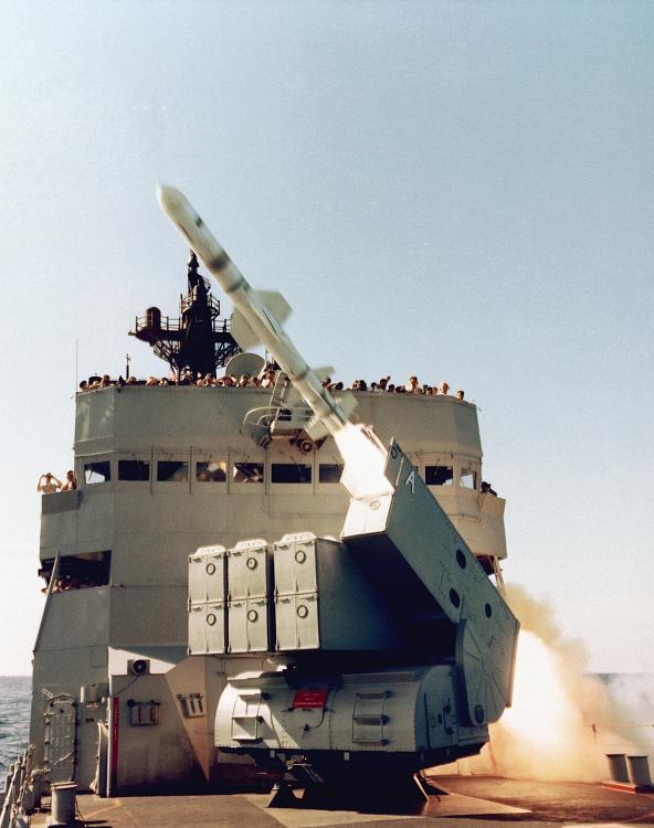

Hey, guys, I have an update, and more will follow on this project this weekend.
I had a Mk71 custom made, and I cannot be any happier. It is the best, and I am so happy with it. Check it out.
Respectfully,
David
Respectfully,
David

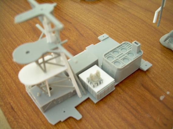

Alright guys, this weekend, Friday 13 - Sunday 15th, I will do a considerablde amount of work on the Spruance-class DDG. After the icredible input from the commoners aboard the forum, and the experience and input of the experience guys, such as Captain Potter, I have a list of items I will include. This is going from forward to aft.
In addition to the standard equipment such as SRBOC, SH-60s, etc, these are the additional changes I will make to the ship:
-Mk71 MCLWG
-32-cell VLS (deep cells for TLAM)
-SPG-51E illuminator atop the bridge
-Optical and IR camera/range-finder on the mast (the same kind you find atop the bridge of Burke DDGs)
-Phalanx Block 1B and RAM (Stbd and Port atop the bridge respectively)
-Two masts wtih SPS-49 and 48 on forward and aft mounts respectively
-Mk141 Harpoon/SLAM cannisters amidships with NULKA aft of Mk141 launchers
-Two SPG-51E illuminators aft of the aft mast
-Phalanx Block 1B and RAM (Port and Stbd respectively)
-64-cell VLS aft of the helo deck (possibly short tubes for SM-2)
-Mk45 Mod4 5" 54/caliber mount aft
Mainly, this is what I will accomplish aboard the DD-963 to make her a DDG-963 equipped for NSFS. Now that I have the Mk71 MCLWG, there is nothing standing in the way of accomplishing this model. Does anyone have suggestions as to how I can better this concept?

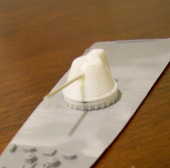

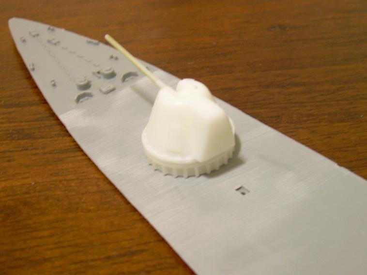

Cliffe,Cliffy B wrote:Only thing I'd change is to try and get a 4th SPG-51E above the bridge somehow. Maybe side-by-side like on the Ticos? Not sure on what kind of room you have left. Also, what about the 5"/62 in lieu of the 5"/54? Again I'm not sure of the time frame you're going for.
Just my 2 cents man, keep the progress pictures coming!

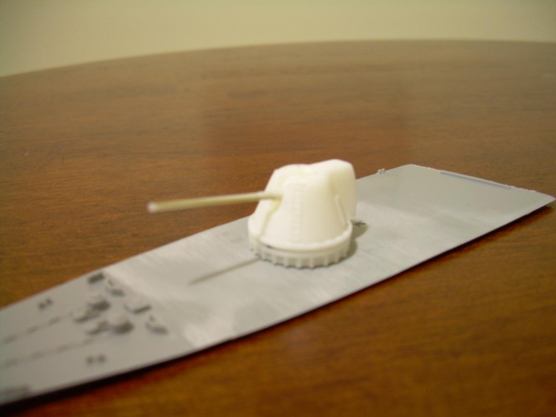

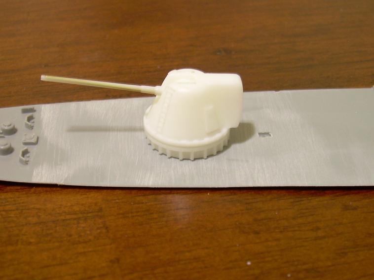

Thanks for the correction, buddy. Mk45 Mod4 5"/62 caliber gun is what I meant to say. The era is right NOW, 2009-ish. As I am sure you all know by now, I believe the Navy WASTED the Spruance-class destroyers with the sea-swap program and is paying the price now with a 280 ship navy (negligent force levels) instead of a 300+ ship navy.
The pictures will be on their way all weekend
I can only wish my augments to the USS Iowa would follow as quickly. We'll see what kind of super-hero feats I can accomplish this weekend
Keep any comment coming! Later, guys!

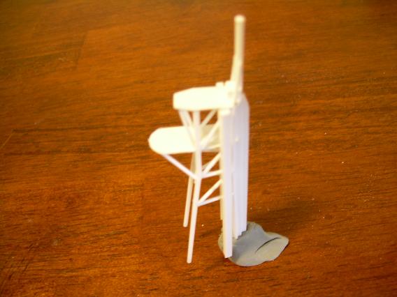

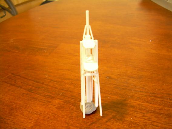

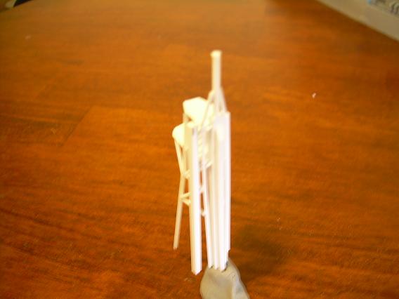

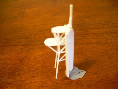

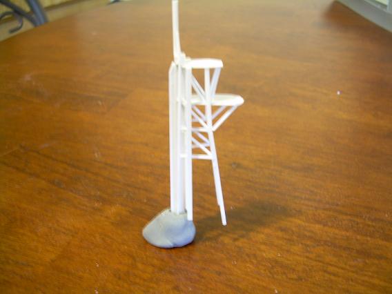

Here is the aft mast. It's really complex, and I don't think the detail came across very well in the pictures. I tried to include what is on the Kidds' aft masts and additional conduit supporting either the SPQ-9B or the AN/TPQ-37 artillery firefinder. It's a counter battery system that would be modified for a moving platform such as a ship.
Because the SPQ-9B tracks out-going artillery and is good enough to track high super sonic missiles, I wonder if it would would double as a firefinder anyway.
- Any input?
Thanks, guys!
- Any input?
Thanks, guys!

Re: Reactivated and Modernized Spruance-class
NAVSEA put the Tico top-side limit to accept only as much as 1/4" aluminum armor flack protection before she would begin to roll 45 degrees in heavy seas. That kind of over load sounds incredible to me.
NavSea prepared the DDG 47 design as a conversion from the DD 963 design, not as a new design, so did not provide the margins typical of a completely new design. I don�t know whether NavSea actually had a particular limit to rolling, as long as the rolling characteristics could be known so that the ship�s crew could act on them. This was an issue with the bulging of USS Midway (CV 41) in the 1980s. Before the bulging Midway rolled more than any other PacFlt CV. With the bulges added, some in the crew complained that the ship rolled too much. There was no definition of �too much�; no reasoning about why Midway�s combat capability should be compromised to reduce rolling, which might not end the complaining anyway; and potentially no knowledge by the complainers of whether her rolling characteristics had even changed.
If I remember right, the DD-963s were able to be converted to a two-director DDG at any point in their lives. This would involved putting either VLS or Mk26 launchers in the ASROC magazine position forward and the Mk26 Mod1 ready magazine tracks aft.
Close, but not "at any point in their lives" if using the weapons considered at the time of the design, 1968. A DD 963 as built could be converted to a 2-director DDG, with Mk 26 launchers. The DDG conversion was an alternative to the ASW modernization including the towed array sonar. The original design did not provide for both conversions to be installed on one ship. VLS came about a decade behind the DD 963 design. VLS was designed for compatibility with a ship design that supported Mk 26 launchers.
You suggested that the USS Kearny and USS Reno in 1941 and 1944, respectively that ships as close to their weight limit as they were would be dangerously close to becoming unstable if suffered flooding.
Reno was so heavily loaded that with some internal flooding she had negative stability. One torpedo hit did not so endanger the much smaller Kearny. Although the official USN report does not discuss it, IMO the main reason that Reno did not capsize was that her damage was from a torpedo whose large hole reduced her righting moment on the port side and she rolled to starboard. The effects counter-acted each other but with the ocean lapping along her starboard superstructure a strafing run could have done her in. Reno at that point had zero combat capability.

A good friend of mine was nice enough to accept a commission from me to build the mount. He's too busy right now to take any kinds of orders. I am just really, really lucky he was nice enough to help me out.That is an outstanding looking MK71. Where did you get it and are there more?
Here's what I DO know. I looked into a few manufacturers, and I got an estimate from Paper Labs. They said they would be more than happy to make a master and 6 copies for about $100. To be honest, that's an awfully good deal. If you get in touch with them, they will likely be able to help you out.

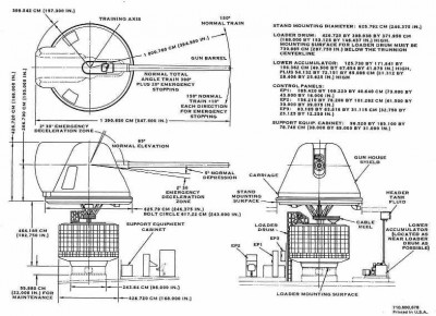

If you need the specific dimensions of the Mk71, http://www.navweaps.com/Weapons/WNUS_8-55_mk71_pics.htm will help you out the best. The posted picture will be the best resource in addition to the pictures you'd want to send to Paper Labs.

I agree that the deck space taken by a �Roc box is about the same as the deck space for two clusters of Mk 141. And no invention is needed to put Harpoon though the Mk 16 � two cells of each pepperbox was modified on the Knox class to fire harpoon (believe they called these launchers Mk 112, I may have the two backwards, conflicting info from different references - the 'Beach had ASROC only Mk 16 - so that's what I'm going with).
RUM-139 is the designation for VLASROC, legacy ASROC was RUR-5. Mk 112 and Mk 16 are the designations for the box launchers you are talking about, both launchers are pretty much the same externally.
The Mk 16 ASROC box weighs 47,782lbs loaded (not accounting for any reloads or automatic reload handling system), each Mk 141 13,000lbs loaded. So two Mk 141 weigh 21,782 less and require no below deck space or weight (SWG-1 is not really an issue, as it is certainly lighter than any control systems for the Mk 16).
So the Mk 141 gives you 16 ready rounds at about half the weight and no below decks space.
I�d go for the Mk 141, but that assumes in the time you are building for they were available. Of course, the Mk 16 has a cool modeling factor of a different weapons system visually.
