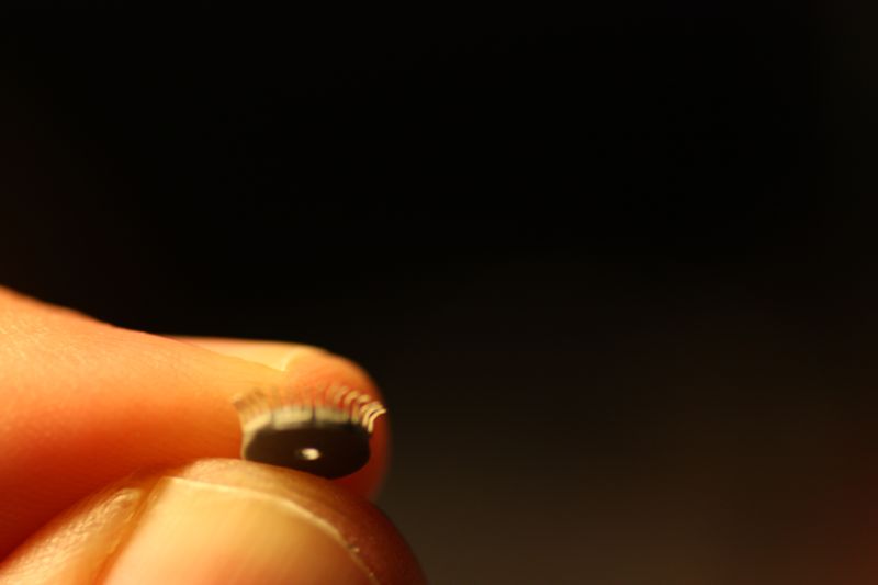

Crows nests!
What to do?
I have the ambition of creating some original Science Fiction models at some point, and as a result have amassed a sizeable collection of 'greeble' for that purpose, including a lot of parts from abandoned or obsolete ship model kits. I knew I had some old round AA tubs from old first-generation IJN waterline kits, and I thought the smaller ones might just possibly make good crows nests.
On examination, the smallest one I could find looked like it might work for the largest crows' nest on the main mast, but for the others, something different would need to be found.
These are the remaining crows' nests, built from little bits from the greeble bag. Now, the next question, how to attach the shrouds to the crows' nest/masthead assembly? Here is my solution.
First, a hole for the mast.
Then a slot on either side for the shrouds to pass through. If the shrouds could be threaded through the crow's nest, they could be attached easily to the chain-plates on either side, and would give a strong and (hopefully) stable bond. One difficulty is that the slots had to be both small and symmetrical.
Not perfectly symmetrical, but hopefully this will not be noticeable with all of the final details in place.

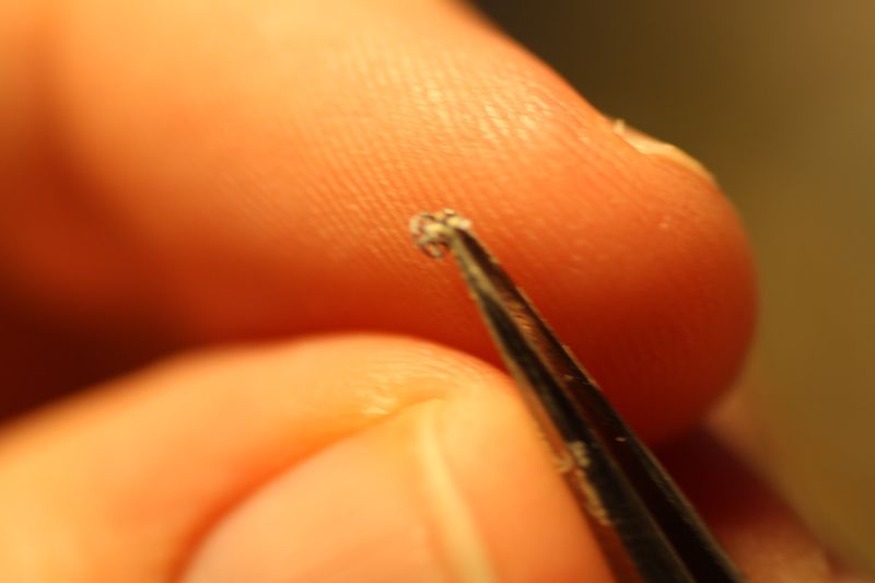

Re: Scratch Building the Portuguese Carrack in 1/700th Scale
Posted: Sun May 01, 2011 3:59 pm
by callen
Here's a thought!
We could create a nice 'railing' round the crow's nest by gluing on trimmed bits of 700th railing turned vertically and then ringing it with a small wire. We could even fan each bit of railing out a little bit to give a nice basket shape!!!... :thumbs_up_1:
:mad_1: :mad_2: :dead: :Mad_6:
yeah... that didn't really work. Oh well. pressing on...

The question is, what to do about the carriage wheels?
Well... one sometimes sees Medieval hay carts with solid wheels... I could simply cut or find some small disks... But spokes would be an awfully nice detail. As it turned out I had a PE fret of WEM's shipboard cable reels. (I love everything Peter Hall does.) The wheels for the IJN reels had six nice spokes, rather than a ring of lightening holes or a complicated spoke pattern of the other nationalities. I realized these IJN cable reel wheels were the perfect size and shape for cannon carriages. :thumbs_up_1:
Attaching a small bit of painted styrene rod to the first wheel using CA. This was very difficult to do, as one had to aim the super-glue armed rod for the center of the wheel. Took me several tries to get it right, and sometimes I was forced to break and re-set because the wheel was crooked. :heh:

Now we have a pair of wheels and an axle. After this we would need to mount the cannon on the axle and then attach that thingy that sticks out behind the carriage and braces the whole assembly for the recoil. Any of you military experts feel free to fill me in on the lingo here... :big_grin: :thumbs_up_1:
These are a little blurry. Sorry. :big_grin:
Completed gun carriage prior to mounting. This was the smallest carriage I made, using the smaller sized cannon from the resin casts of my BMK cannons which Bruno had made for me. Too small, as it turned out. There were two sizes of IJN cable reel wheels, so I used the smaller size for this caliber, as a result, the cannon did not have the height to peek over the gunwale... :heh: Still looking for a way to mount this little guy on the ship. The others you will see in the shots below are using the larger size cannon/wheel combo.
1st cannon mounted.
Each one took about ten to fifteen minutes to make, depending on mistakes and corrections. Fortunately I never ruined or lost any wheels or cannons. :woo_hoo:Forgot to mention I also painted and placed the hold grating during this period. For the grating I used some old HO scale PE grills I had bought years ago for 'general grating.'
Penny for scale.
