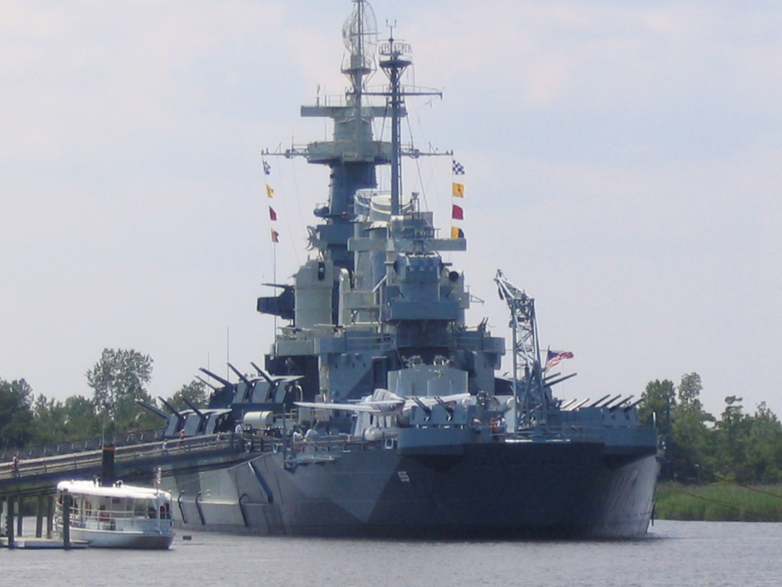

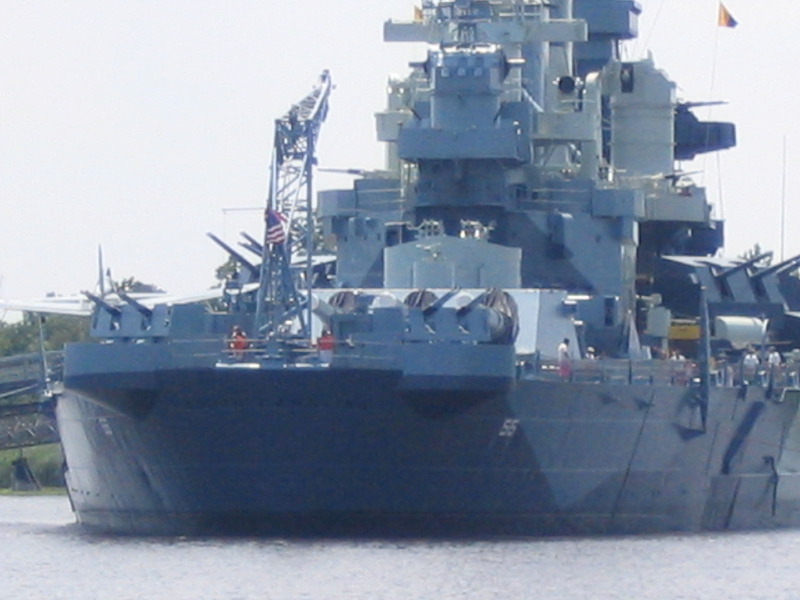

Does anyone know or better still have a photo of the stern and wake lights on BB-55? For once I know the colors of the lights but no idea how they were mounted. All the �Walk Around� photos I�ve seen either do not get back that far on the deck or the quad 400 tubs hide the lights. Also the stern chocks, are they open or closed. I�m building the 1/350 Washington and assume the lights and chock arrangement would be the same. The Booklet of General Plans I�m using, last revision date being March 1946, indicates that there was a smoke generator on the stern, port side between the quad 40mm tub and wake lights, would this be the same type of generator, four cylinders, stacked two on two, one sees on destroyers?

The two stern photos are a big help in more ways then one. They give a whole different perspective on the ship. I know I�ll be looking at them over and over during my build trying to find that one little extra detail to add. Thanks for posting them.
