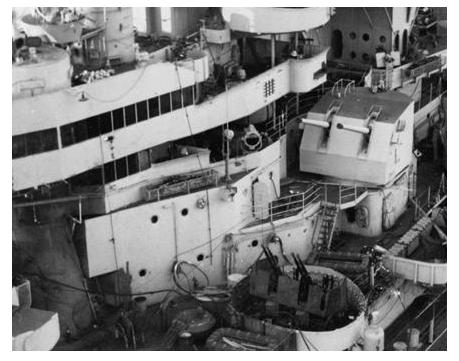

Velico-Pele -
I believe the area you were questioning (pg. 74) is shown in the following photo of NEW JERSEY (1945) - the plated area on MISSOURI covers portholes on the 01 level bulkhead.

BB62vet,
The area is in your photo but its the 02 level bulkhead, ahead of and below the forward corner of the flag bridge on the 03 level. Take a look at page 6 of http://www.hnsa.org/doc/plans/bb64.pdf

Of all the HSNA Iowa class plans this one is the only one labeling the area, or even showing it. The compartment below the conning tower is shown as a plenum leading to two main vent shafts. So there must be a large intake under there, but I don't remember seeing one. Possible for inactivation it was blocked off? Perhaps we could ask cliffyB to peek under the skirt on this one?

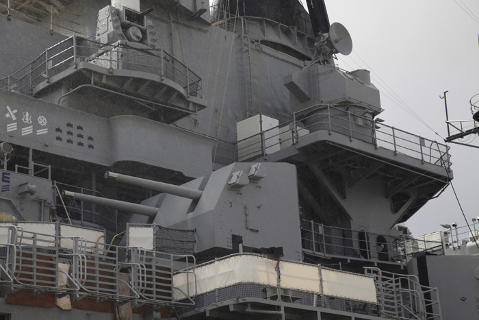

I posted this photo elsewhere, but the question might be more likely to be answered here: when did the most modern of the raft baskets enter service on the Iowa's, were they there during the Vietnam era?
Russ2146
- Posts: 2126
- BB62vet
- Posts: 3175
- Location: Mocksville, NC
Re: Calling all USS Iowa class fans
Russ,
I've got that photo somewhere
- thanks!
I'm guessing that they are the same as the ones mounted in the '80's.
- Posts: 5068
Now how to build the little devils, in some quantity.

Seems like that might be a candidate for a cast resin part - maybe two parts, the rack and the raft separate (packed, of course
) Perhaps Cliffy B could take some measurements for you (does he do any sketching??), at least of one of the racks.

Flyhawk makes turned brass versions of the inflatable, encapsulated life rafts. I've never seen these sort of racks available aftermarket.
If I remember correctly the BBs couldn't carry the encapsulated versions due to the over pressure from the 16" guns. When they fired they would pop them open. I want to say that they did carry them but only a small amount in a few protected areas. I think I've seen the racks AND the baskets aboard BB-64 but I can't honestly remember at the moment. I'll take a look next week if someone else doesn't figure it out before hand.
Fliger - What vents are specifically talking about?
In reference to the "things" beside the conning tower at the 02 level, I have photos of said area of BB-64 that I'll post later along with others.

Thanks Cliffy:
Interesting that there is nothing behind there, and that your ship has no covers at all. I remember looking under the ones on BB63 and not seeing anything but didn't take any photos. Memories are fallible.
As to the raft racks, one might be able to make a master for resin of the packed rack. The rack itself it is way to fragile for casting but could be a PE item. I have many close up photos of these empty and no good photos at all of full ones. The round canisters such as found on many active ships are not the same type as used here. I think someone did make cast replicas of these in a smaller scale.
Cheers. Tom
