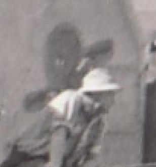

Quick question - I've been trying to figure out what this is. I circled it in red, I know there is a swivel chair there, but it also looks like an older target designator or something. Not quite a MK51 like later on either - those were for the 40mms which you can see in this pic the ship has only 20mm singles.
However, I do know other directors were sometimes used to control 5" turrets (a MK51 forward of the island on Essex would control the 5"ers in an immediate air to air type threat). This does not even look like that though. It is mushroom shaped with handles around it like a gun director though. I also don't believe it's the compass, but maybe I'm wrong.
Thanks!

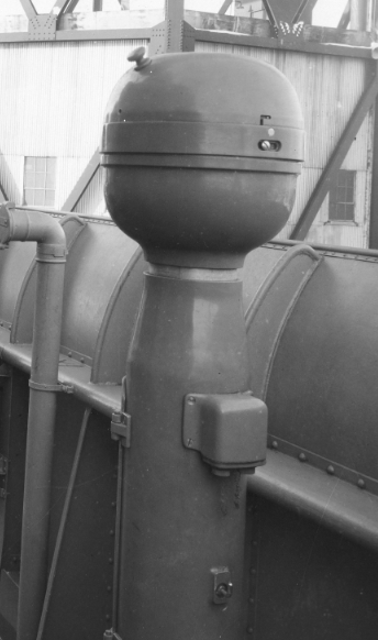

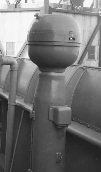

They aren't Mk 51 directors. Your "red circle" actually has captured TWO devices on the navigation bridge; the rounded dome device is the pelorus and the contraption behind it (there is another pair of them on the starboard side as well) is a sky lookout chair (actually there are two on the starboard side). A set of powerfully binoculars could be mounted on the frame so the lookout didn't have to try and hold them. Plus the thing allowed the lookout to call out accurate angle bearings and elevation angle to his sighting. These were moved further aft once the Mk 51 directors were added. Actually, I think there were TWO sky lookouts on each side of the open bridge and the forward pair were removed for the Mk 51 directors.

Thank you sir, fantastic! Makes sense.

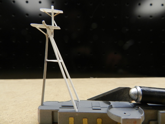

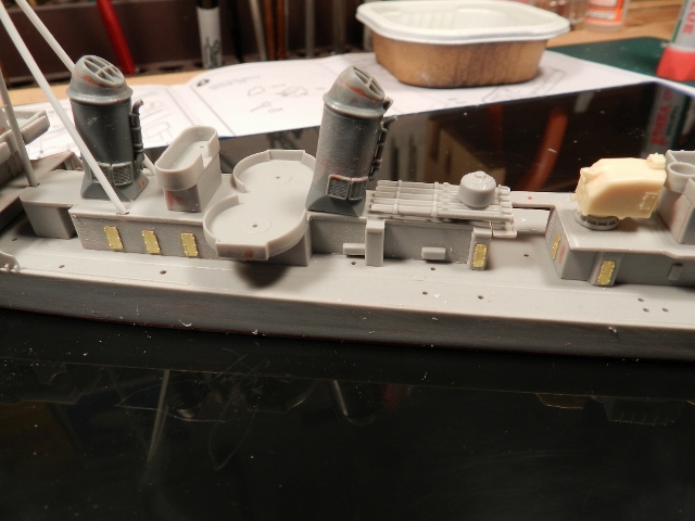

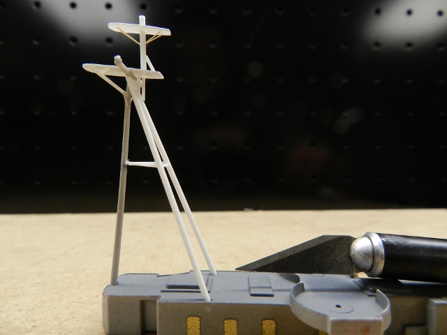

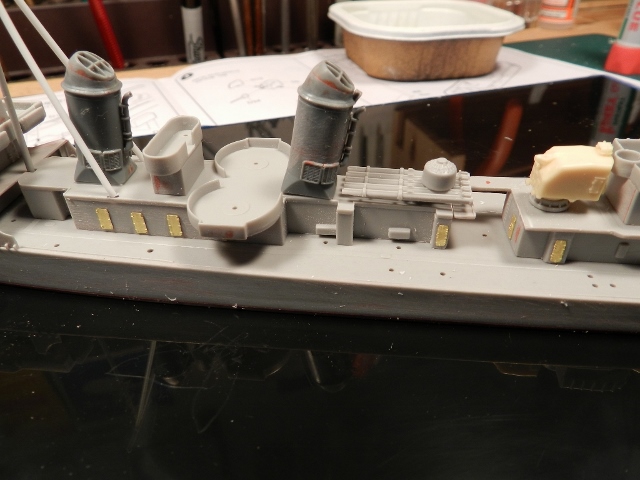

Thought I might share some progress here. Again, the value of information provided by Rick has been priceless.
I am using the Trumpeter kit as the basis and have used the stacks from the Tamiya kit, photo etch from multiple sources and have augmented the kit main mast to create the tripod mast. This is my first ship model since I was a teenager (many years ago) and find that there is a great deal of forethought required to plan the build and subsequent paint. the model is stacked up for pictures but the deck levels remain unglued and removable. I have studied another section of the site for instructions on simulating water and have given that a try too. I would welcome and hints, tips or criticisms. If this post needs to move to another section the mods should feel free.

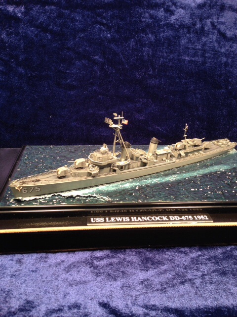

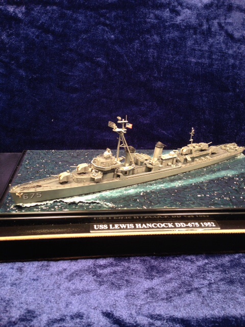

Rick, please accept my sincere thanks for all of the information. While not perfect, this is my version of the Lewis Hancock.
Posts: 3880
Re: Calling all USS Fletcher class (DD) fans
Post by Rick E Davis »
Bob,
Looks pretty good with the scratch-building required and Trumpeter kit limitations.
Your scratch-building skills are excellent.
