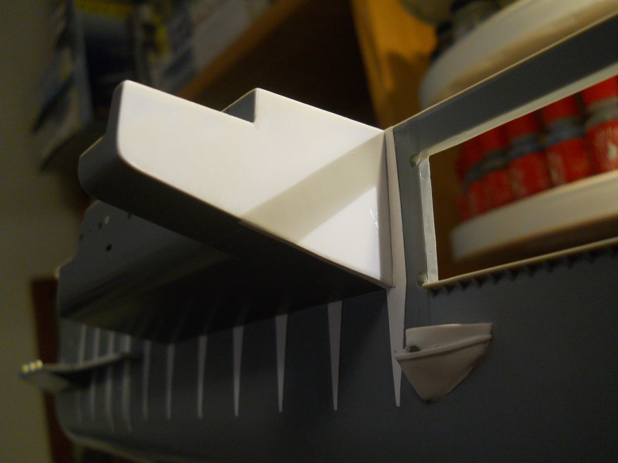

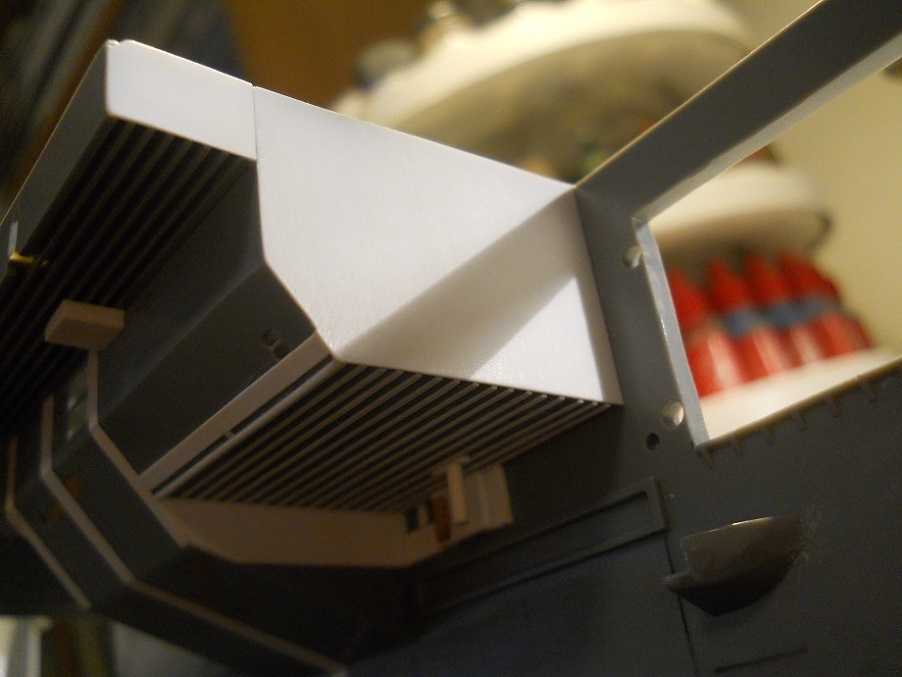

Can we see a little more on those large plasticard parts on the starboard side front middle and rear. I'm curious as to what you have going on there.

Here are a few photos of the areas that you requested to see. I used thin plastic card in these areas to hide seam lines and build up some areas that needed it. A few of these areas have been modified to try and coincide more with the way its supposed to look. Hope these help explain what I did and why.

Thanks Doug

Doug ,your work on this area is superb
well done

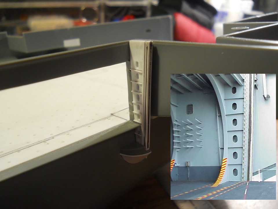

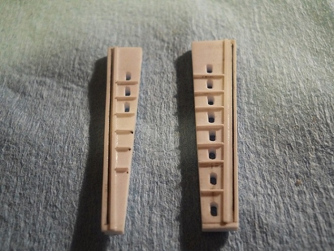

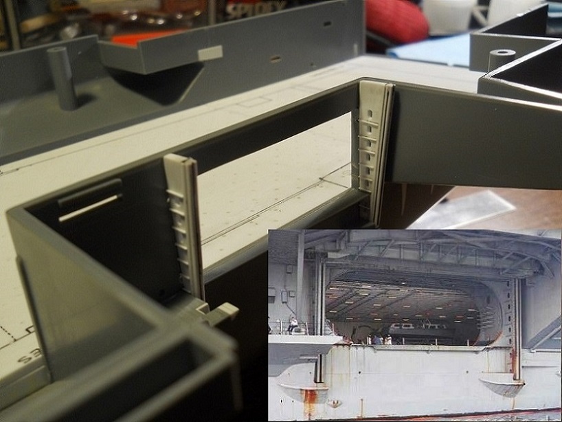

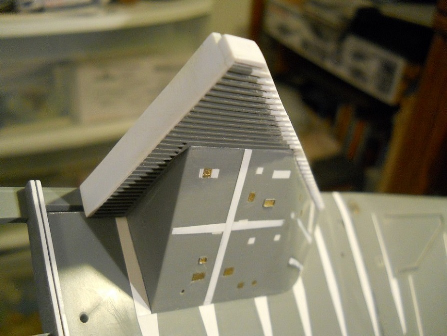

I also started work on the #4 elevator support guides on the port side of the ship. Again, I pretty much scrapped the Tamiya parts and built my own. Some of the photos have inserts showing actual ship photos for comparison. It's good to have a camera again!!!

It's threads like this that make me wonder why I got the Tamiya Enterprise in the first place. I'd never be able to do it justice.
Very neat scratch-work, Doug.

Thanks a bunch Sean. It's still a great kit considering, and can be built into a really nice display. I really do appreciate the comments though.

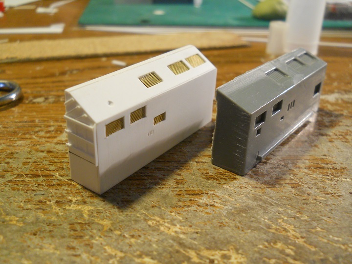

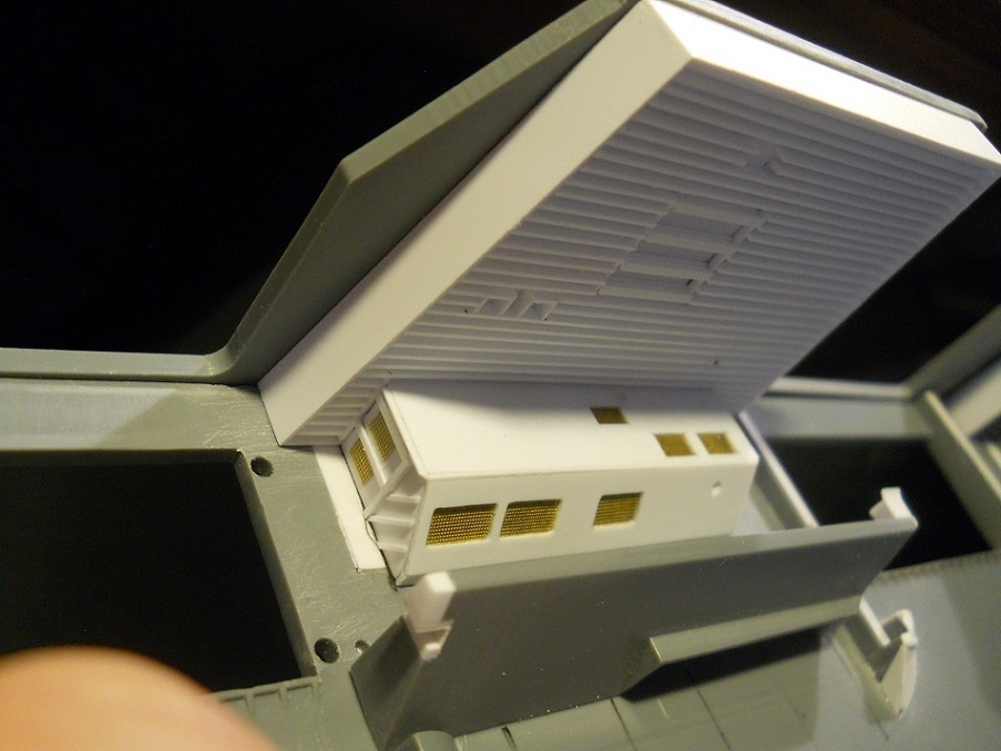

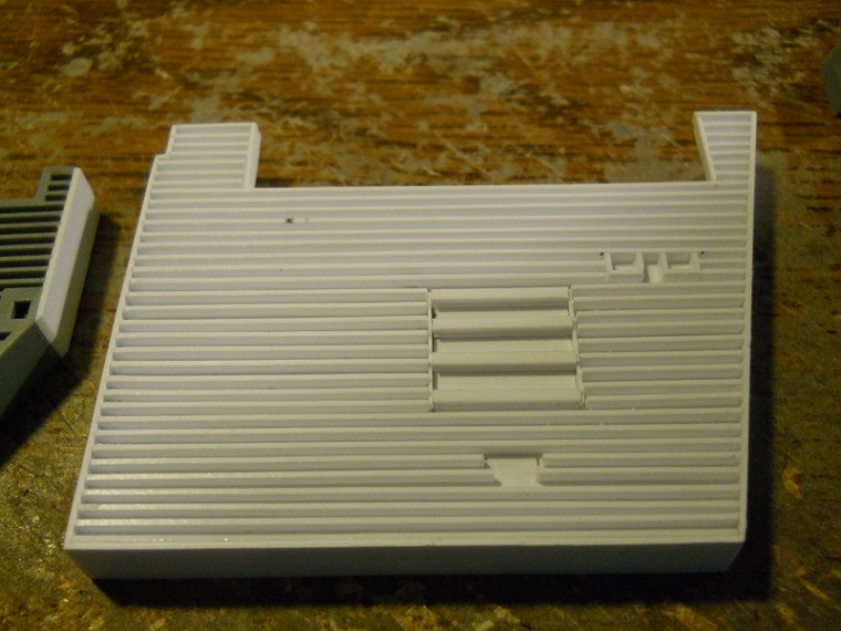

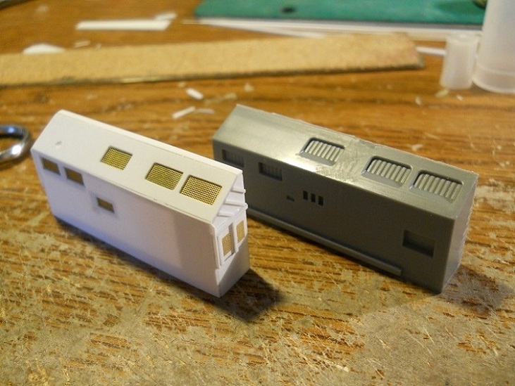

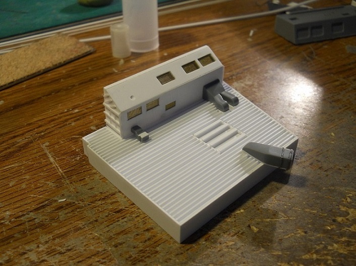

I have started work on the starboard quarterdeck where underway replenishments take place at the fueling station. After studying photos and seeing how Tamiya interpreted this area, I once again came to the conclusion that I would need to rework this area quite a bit, so I opted to just scratch build the pieces myself again and scrap the old ones. I started by cutting a portion out of the hull to remove one of the molded on pieces. The photos show my scratch built pieces next to the kit parts, and then partial assembly of this area. It's starting to come together, little by little.

wow outstanding ... it's a total rebuild... but love the detail... Again...

Outstanding. Are the ducts kit parts?

nicely done sir!

well done!! I was looking for this reference pictures of this area but could not find any hum hum.
But must agree, this turned out very nicely ^^)

Yup, the three ducts are the actual kit parts, slightly modified of course. At least there are still SOME useable parts from the kit.....hahahaha jkboomstick68 wrote:Outstanding. Are the ducts kit parts?
I got most of my reference photos from the internet. I have honestly been collecting photos for the last 2 to 3 years while I have been planning this build and studying them as much as possible to determine what needs to be changed/modified for the 2001 timeframe for Enterprise. It will never be 100 percent accurate or even close to that for that matter, but I would just like to make a more accurate representation than what the kit provides. There is also a photo CD from this website http://www.stillmotionsphotographics.co ... earchTerm= and the photos have been invaluable for the build. I totally recommend it if you are serious about detailing your Enterprise kit. If you are still coming up empty on your photo search, just let me know, and I will see if I can help. Thanks again Silvershadow.silvershadow wrote:well done!! I was looking for this reference pictures of this area but could not find any hum hum.

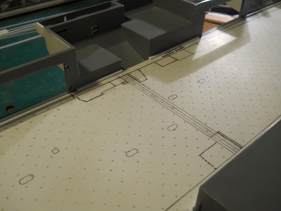

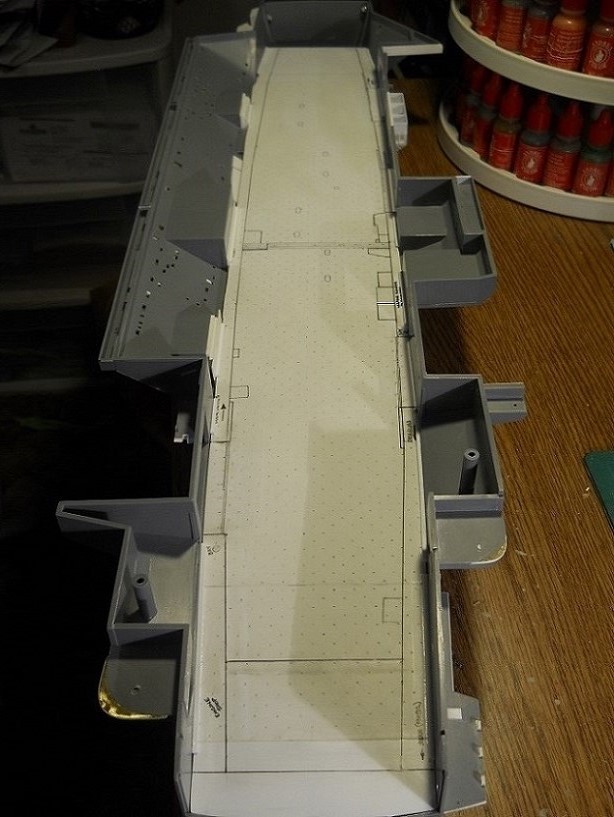

I just have a quick update. I finally secured the hangar deck floor and have the preliminary layout completed and drawn onto it. I used the CVN-65 hangar plans drawings submitted and drawn by Rob McCune (rtwpsom2) on the "Calling all USS Enterprise CVN-65 fans" thread on page 14. http://min.us/mdFyb4c Thanks Rob, for making things easier and dedicating you own personal time for the benefit of others here.
I will use this to build up the hangar walls and start adding details. I will more than likely build the walls in sections with all the detail, then paint them, and then add them as inserts. It would seem an easier way than to try and build everything inside the hangar, then go back and try to paint, considering it's kind of in a confined space and would prove difficult. Anyway, this is the start so we will see how this goes.

That could be interesting. Your idea is reminiscent of instruction manuals for armor models where the subject is given the full (or sometimes only partial) interior treatment. You can't just assemble the lot and then paint it, you have to get each bit of wall, floor or some other component built, painted and then brought together bit by bit. It makes things trickier to glue into place, sure, but practice makes perfect.
In my stash in particular, this applies to a Tamiya M2A3 Bradley IFV and a HobbyBoss AAVP-7A1, the latter of which I'm thinking of just sealing shut and putting in a sort of surf-and-turf diorama.
