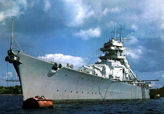

The first photo on Page 1 of this thead shows Bismarck in colorful two-tone gray in bright sunlight. Here's a source for warship paint chip colors: http://www.shipcamouflage.com/paint_chips.htm

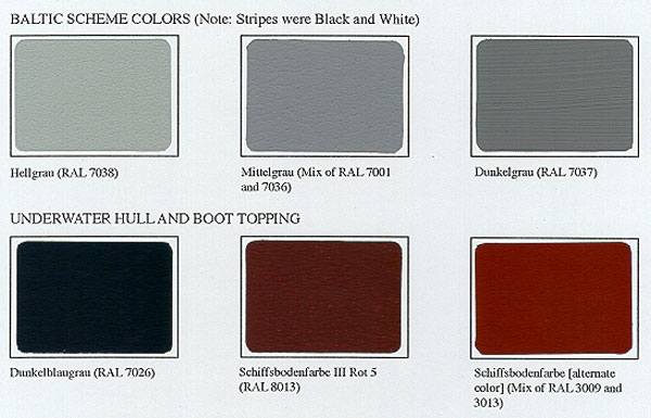

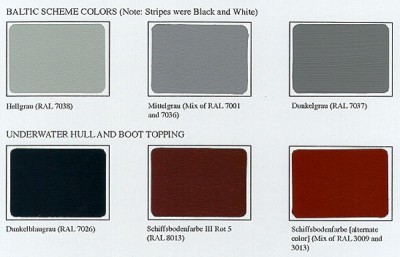

The Kriegsmarine "Baltic colors" are listed in the website under "Kriegsmarine Set 1" (second page in that set), and I clipped those "chips" for the attachment to this post. Hellgrau (Light Gray) is the Baltic superstructure gray color; Mittelgrau (Middle Gray) is upper hull gray color; Dunkelgrau (Dark Gray) if hull bow and stern are painted in full Baltic scheme, and Schiffsbodenfarbe III Rot 5 (Ship primer color III red 5) for the lower hull. Alles auf Deutsch, nateurlich!
Remember, there is a lot of opinion about these colors. The ships look a little different under varying lighting conditions and distances. Your second paint scheme attempt with medium gray hull and lighter gray superstructure looks pretty good to me!
Have fun with your build! And...just as Admiral Farragut said August 5, 1864 at the Battle of Mobile Bay: "Damn the torpedos! Full speed ahead!"
Hellgrau is Baltic superstructure gray color;  Mittelgrau is hull gray color; two optional red hull primers
