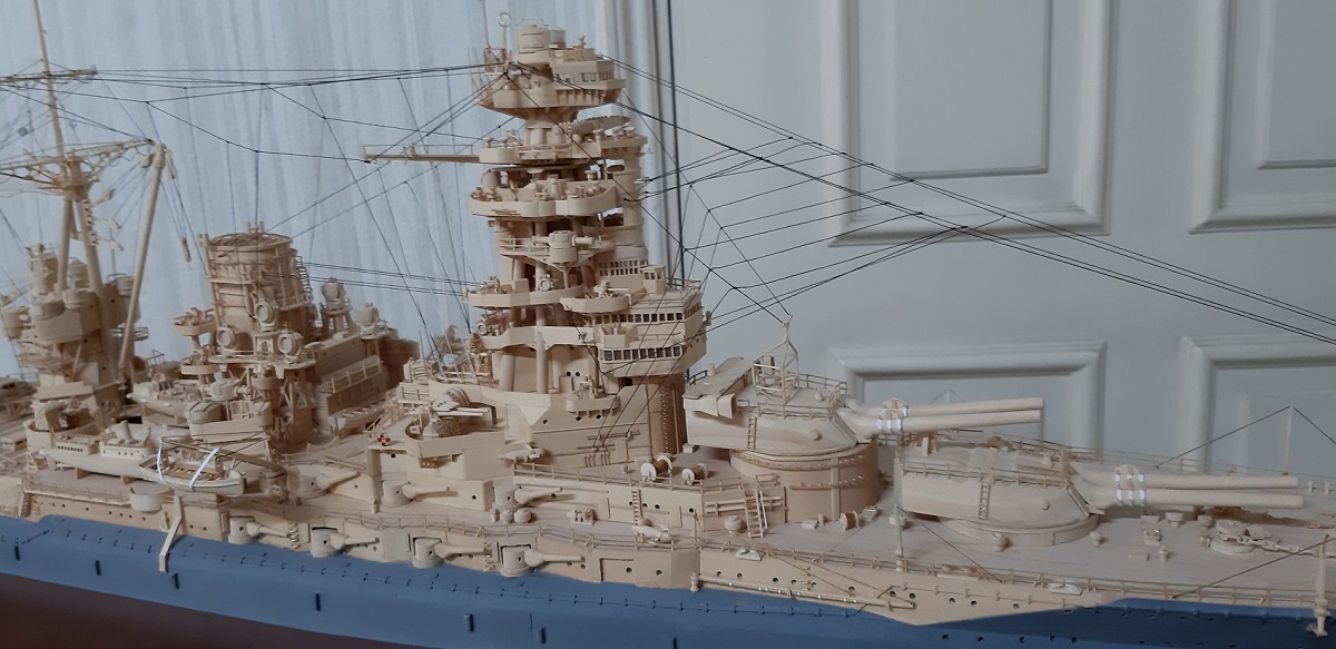

Very nice job on the accommodation ladder at this scale. I ended up making them from Strathmore paper in a similar manner, but using a plexiglas jig with slots cut at an angle for the spacing. The wood glue I used did not adhere to the plexiglas so easy enough to remove.
Very nice indeed!

Hi Song,
it looks amazing, as always. Can you tell us what wood have you used for the gangway and gangway crane? Did you bend the wood or cut a curve shape?

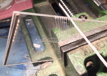

Fliger747 wrote:Very nice job on the accommodation ladder at this scale. I ended up making them from Strathmore paper in a similar manner, but using a plexiglas jig with slots cut at an angle for the spacing. The wood glue I used did not adhere to the plexiglas so easy enough to remove.
Very nice indeed!
Thank you, Tom!
Show me your plexiglas jig please.
Song.

Froggy84 wrote:Hi Song,
Thank you, Phil!
I used both of them.
1.bending : I used Bamboo.(It's davits for boat)
2.cutting :The others(The place of not required tension...)
Song.

Song:
I will post a photo of my simple inclined ladder jig as soon as I find it!
Posts: 5068
Re: 1/200 IJN NAGATO
Post by Fliger747 »
Song:
Jig is still hiding so I cobbled up a simple version so you get the idea. Just angled slots cut with a razor saw into a piece of plexiglas at the appropriate spacing for the scale.
First I cut strips for fails and treads. I tape a rail to the back of the jig then insert treads in the slots with the smallest amount of wood glue possible. After the glue sets I add glue to the protruding treads and attach the other rail. When dry I remove the tape and slip the inclined ladder out of the jig, trimming the rails to appropriate length.
For my ladders I have had best luck with Strathmore art paper which is stiffer than styrene. For styrene ladders one would probably have to make an aluminum jig.

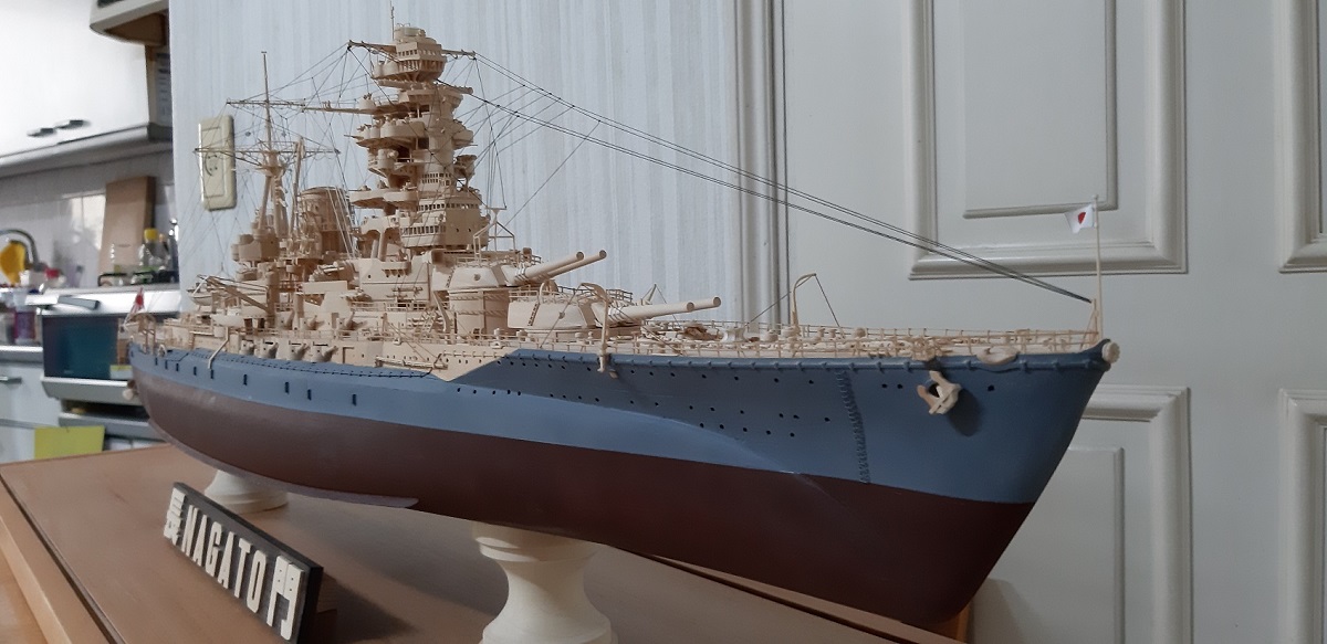

Hi,Tom!
Thank you sharing photo. It's very useful for me.

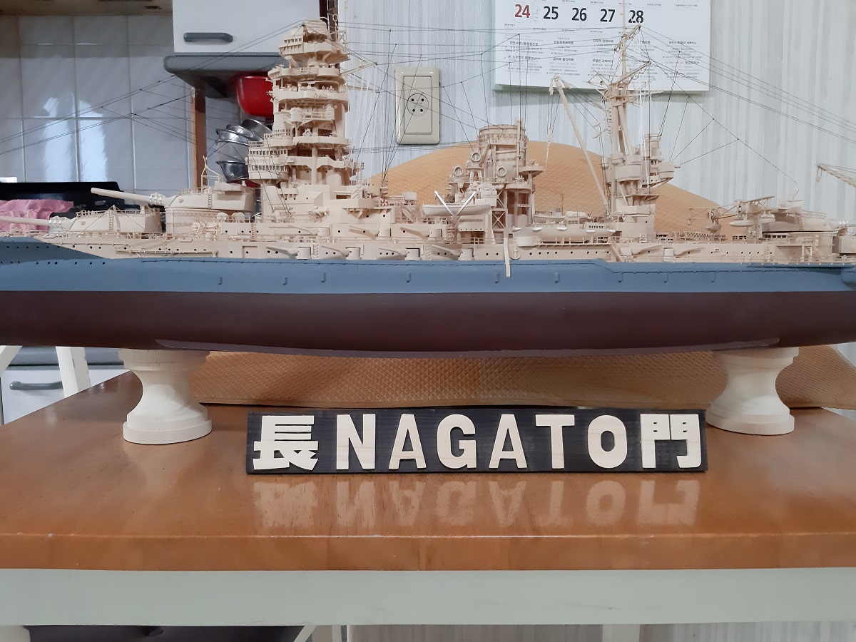

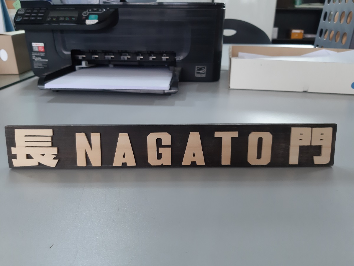

I've made nameplate and pedestal.
But I changed it's font.
Song.

Nice, accurate and clever work in the name plate!
Sad to see another chapter finished, so fun for the rest of us to watch and learn!
Song Jung Gun
Posts: 1631
Post by Song Jung Gun »

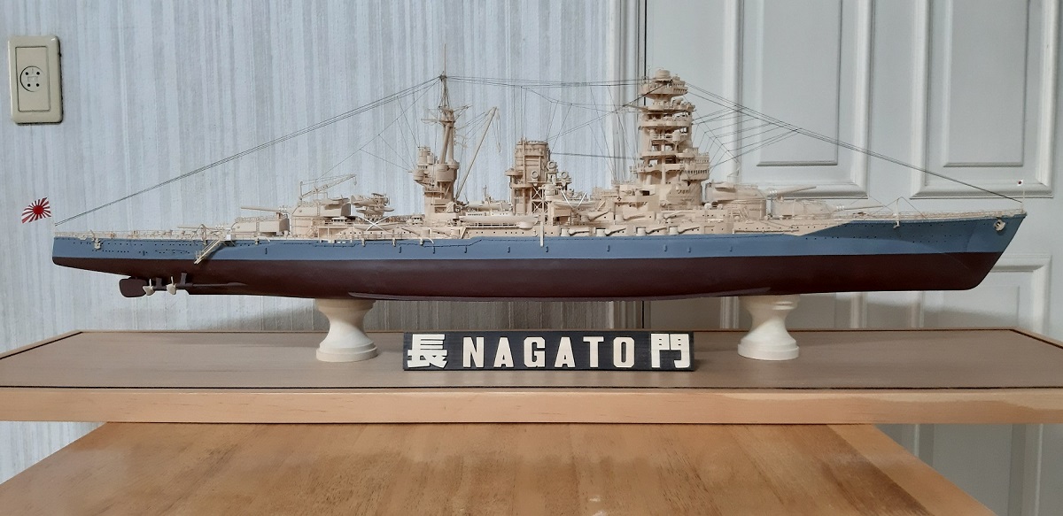

Hi,warshipmodeller!
I've done 1/200 ijn Nagato model.
You will see more pictures in the gallery.
I've sent 30 pictures to editor of this site.
Song.

Well done Song... I'm just feeling like a lazy French snail when looking at your work...
What's next then ? Can't wait to see the new one coming !

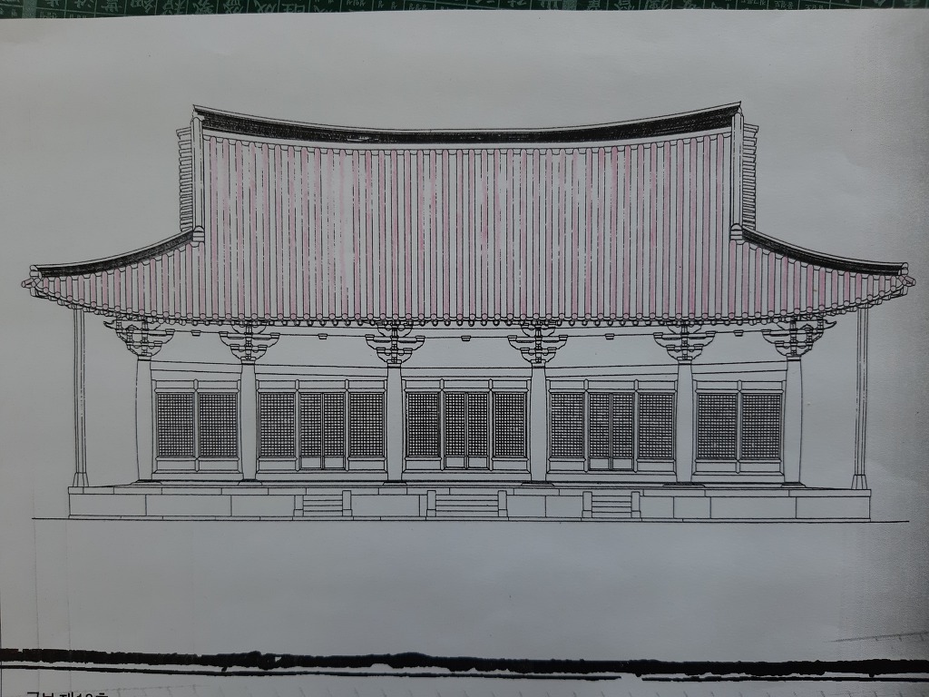

you've been Korea. You know Budist temple in Korea.
I want to make wooden architecture.
Song.

I was expecting another warship, yet the Korean Budist temple will do nicely for sure, albeit probably not reported on this forum !
Whatever the subject, the only important point is that you enjoy doing it...

I have been to Korea and Japan, and the complex wood work in the temples is amazing. Given your talents for working wood your model will be beautiful!

I have seen some models of temples and the replication of the full scale expert woodworking is quite beautiful to admire!
